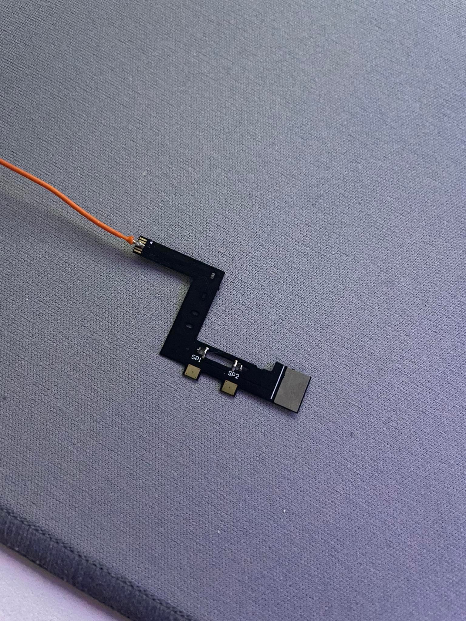

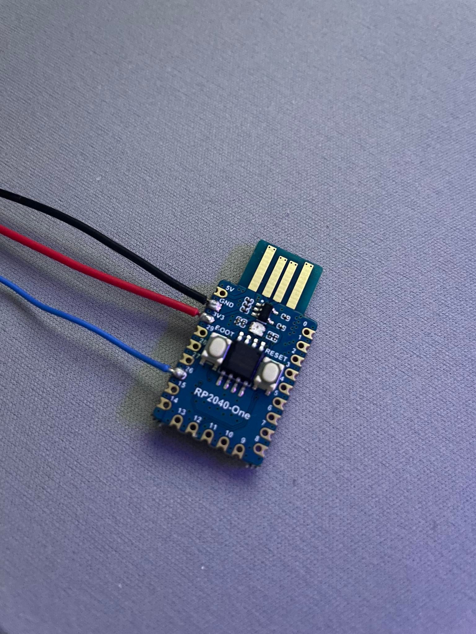

Hey guys, i have a Nintendo Switch Lite. So I bought rp2040-one and adapter lite CPU.
I bridged pin 3 and 4 in adapter lite that's right? I have a question, soldering only point SP1 or SP1 and SP2?
i have only wire RJ45, this is small.. :rofl: Orange wire connect to pinout 15 Rp2040?
I don't have 47 Ohm today, so buy tomorrow :shy:
Yes, so long as you aren't using other orange, the orange that you have connected on pin 3/4 of the flex should go to the pin15 on the RP2040-One
