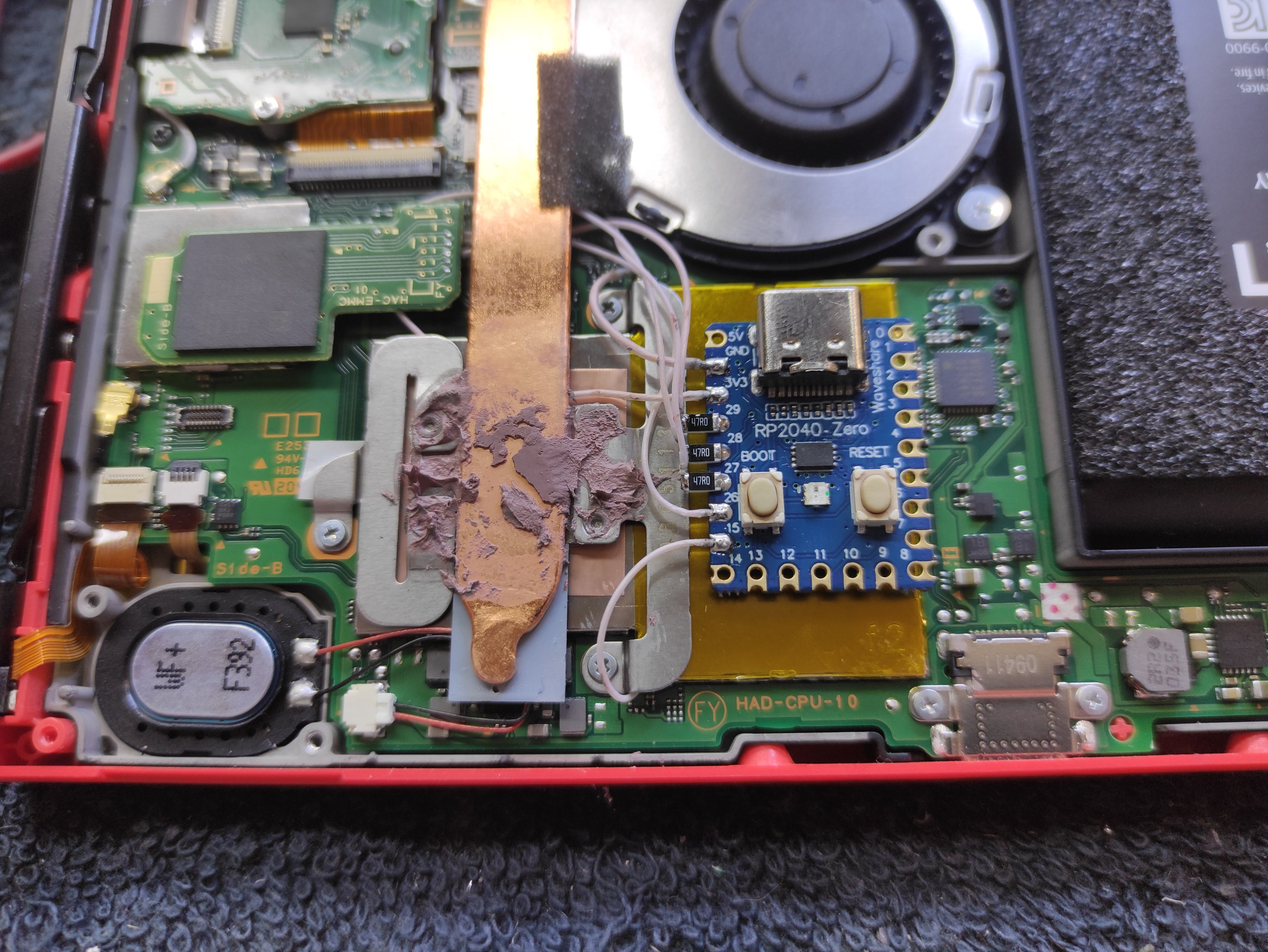

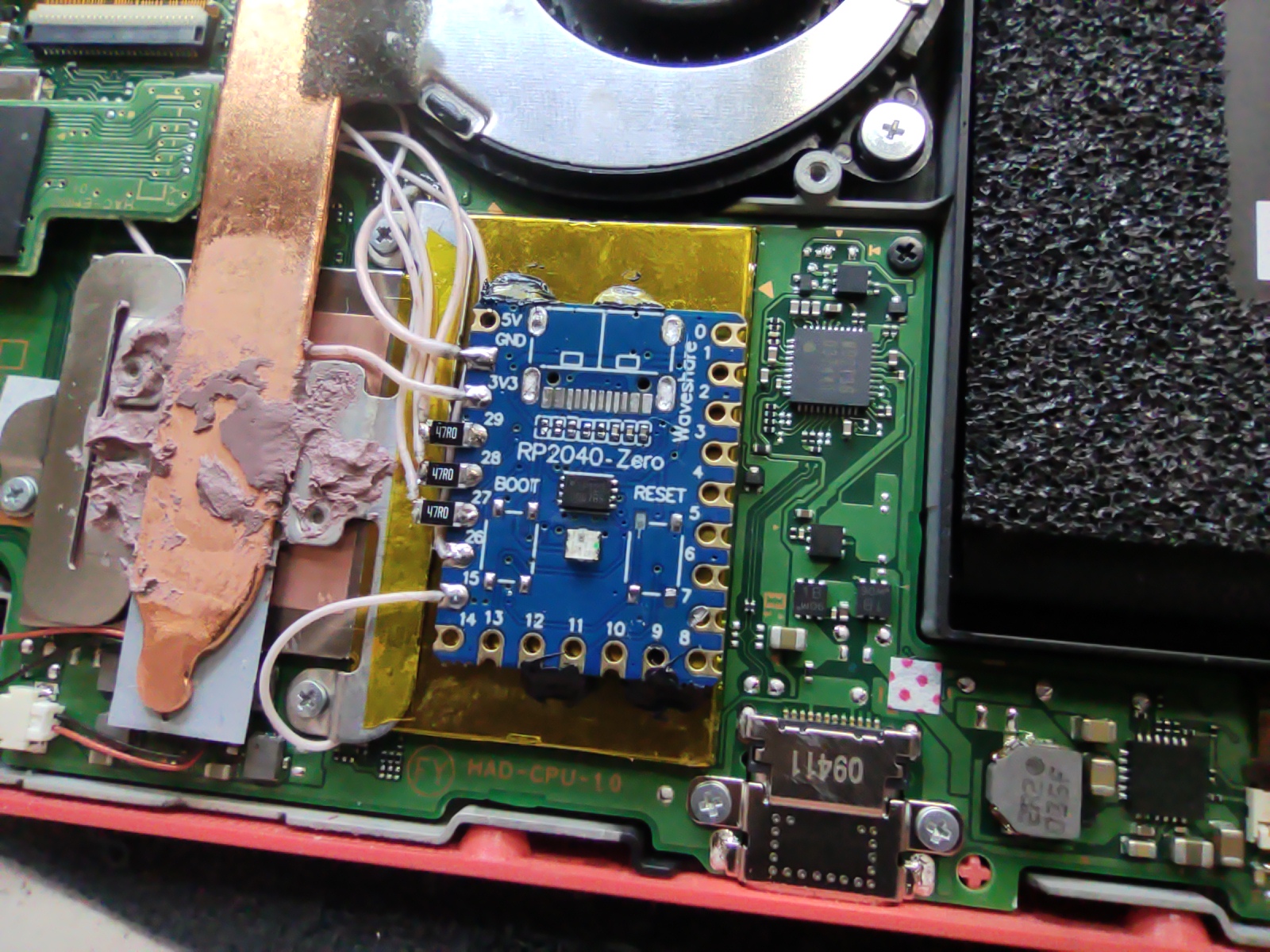

Just arrived
Any firmware for this?
Note the flex and usb same as hwfly v4
@rehius
@vittorio
Did you get firmware with it? If not, you can save it on your pc with picotool. It might be designed to be pin compatible with rehius firmware as there a 3 resistors next to pin 27 to 29

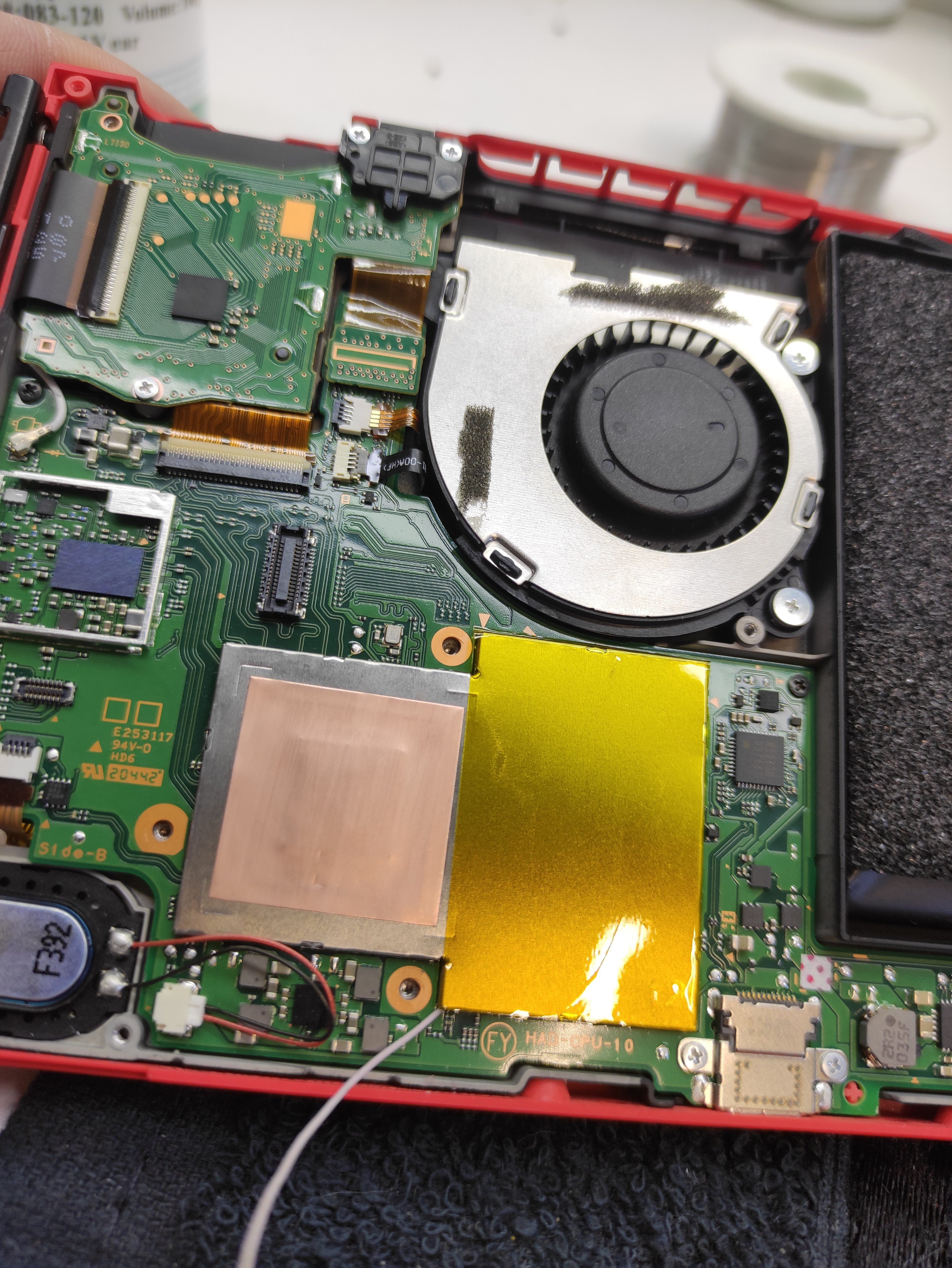

I accidentally dropped this while removing the usb port. Can I use rp2040 for the switch when I lose this? Thank u

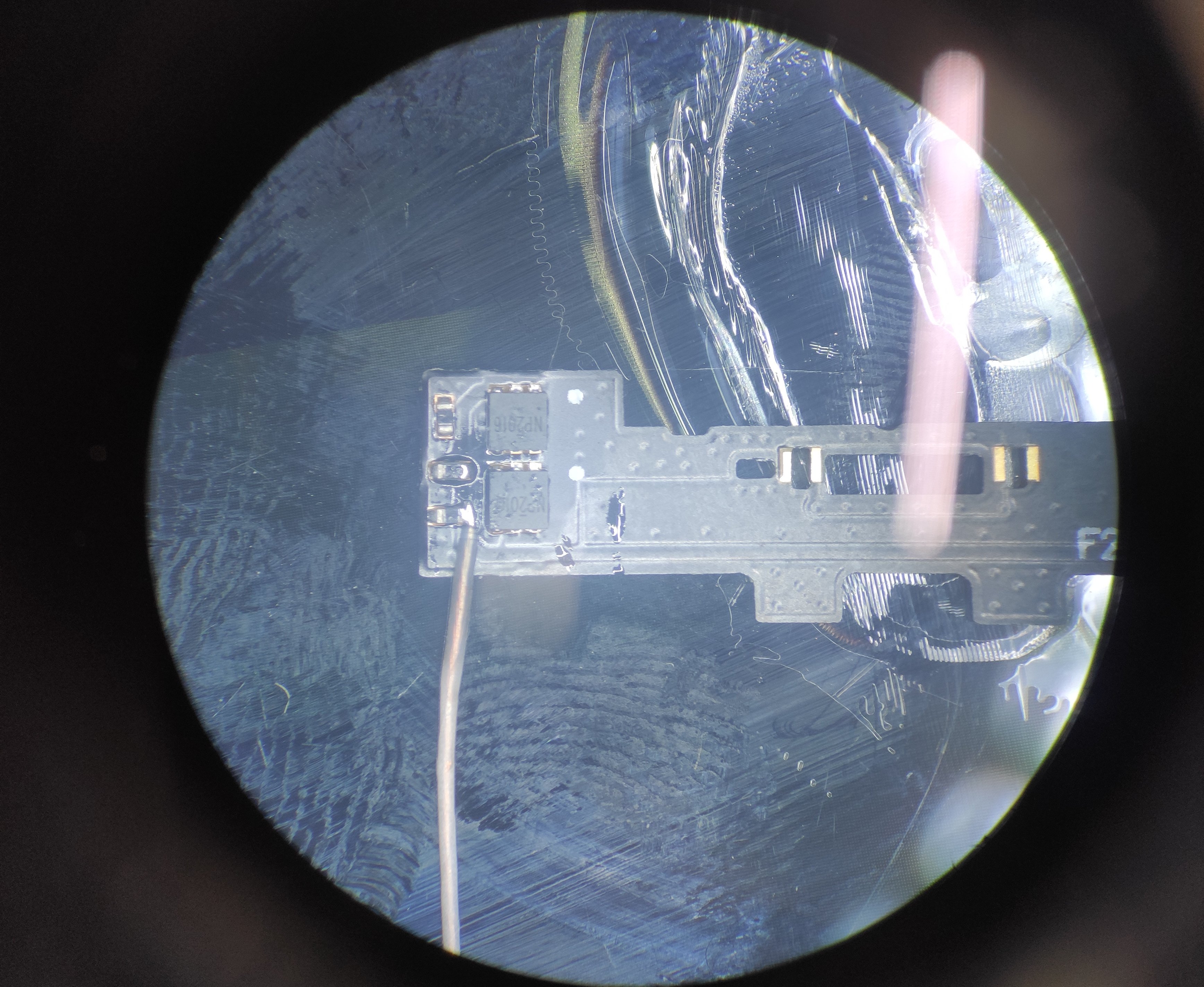

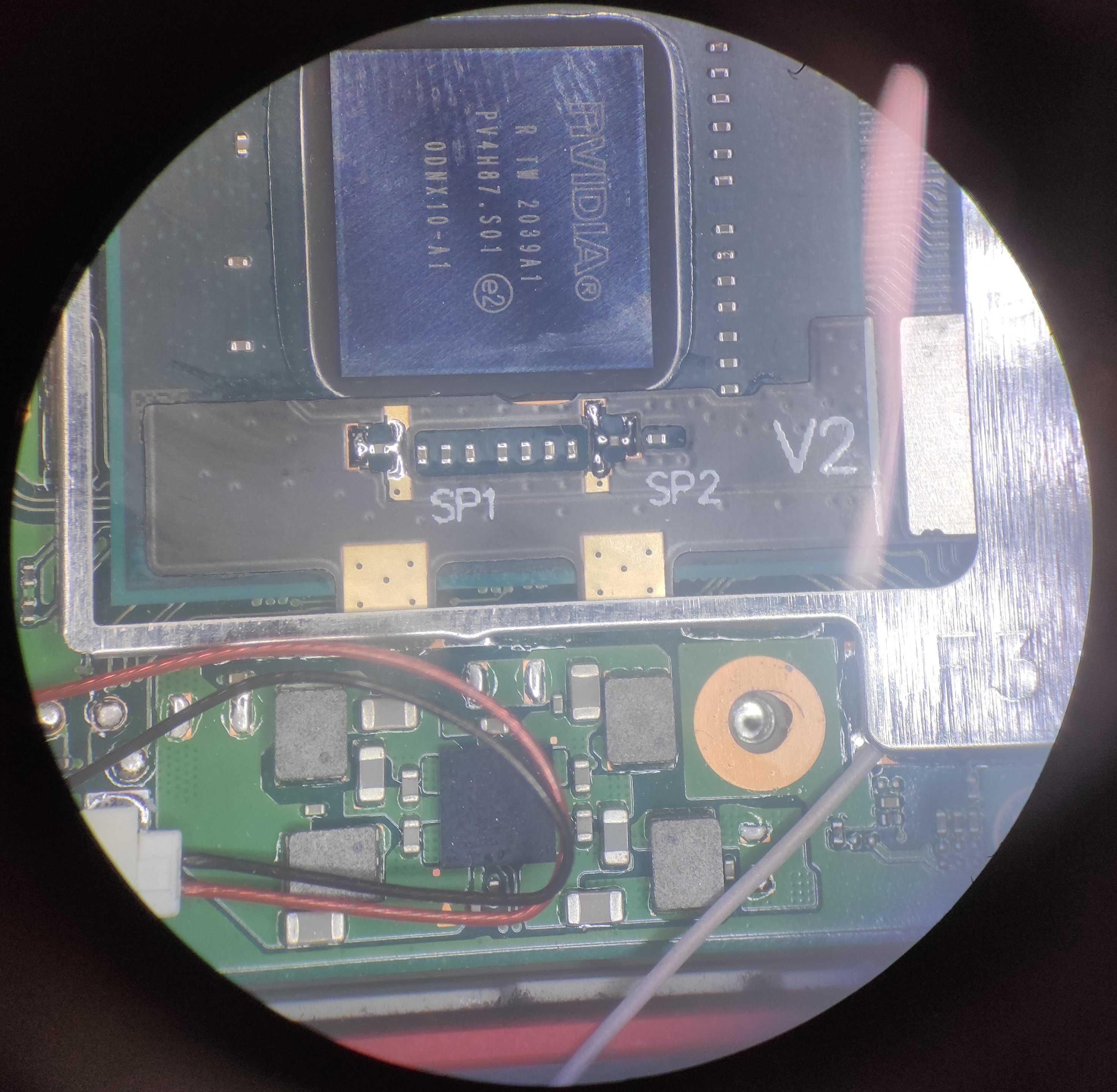

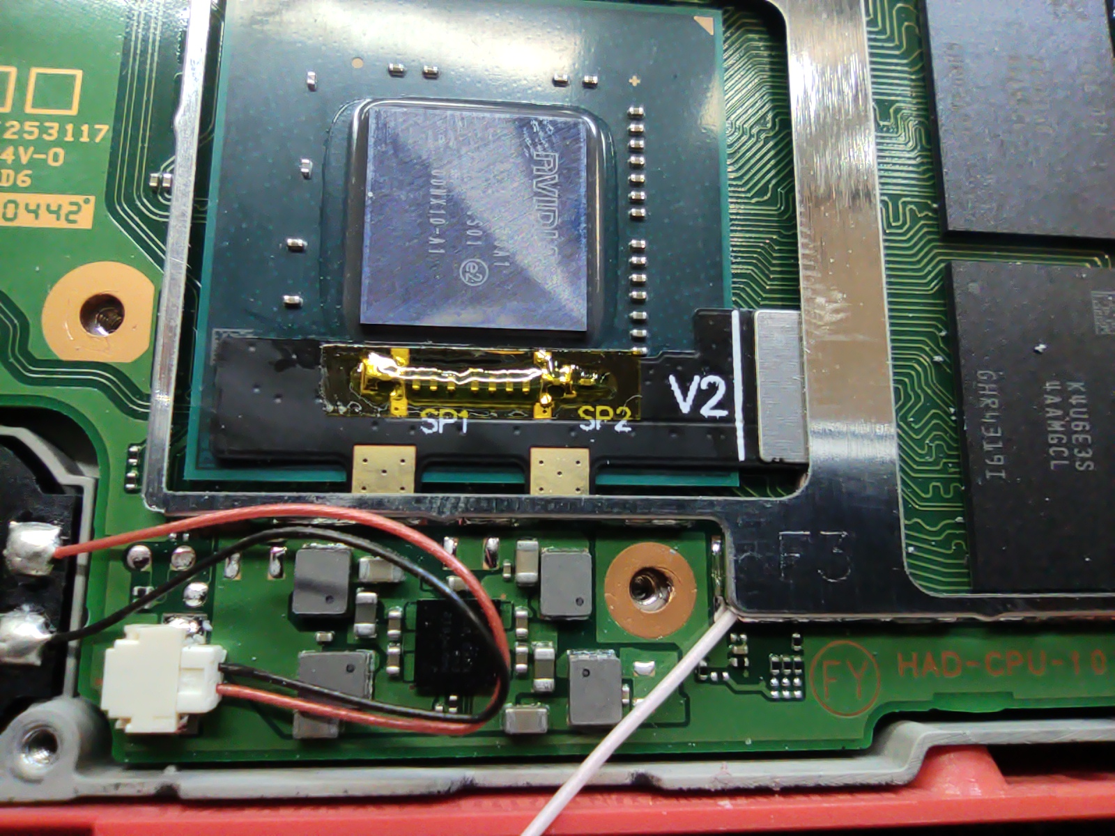

Doing my install and I think I may have damaged the max77812. Would a damaged max77812 cause a blue screen? I think I knocked the corner of the chip off when removing shields around it. Just wanted to check before I go ordering some and replacing it that it might be the cause of my issue.
Soldering looks good under magnification and the resistance measurement to ground of the wires for the APU caps is about 24 Ohms.
