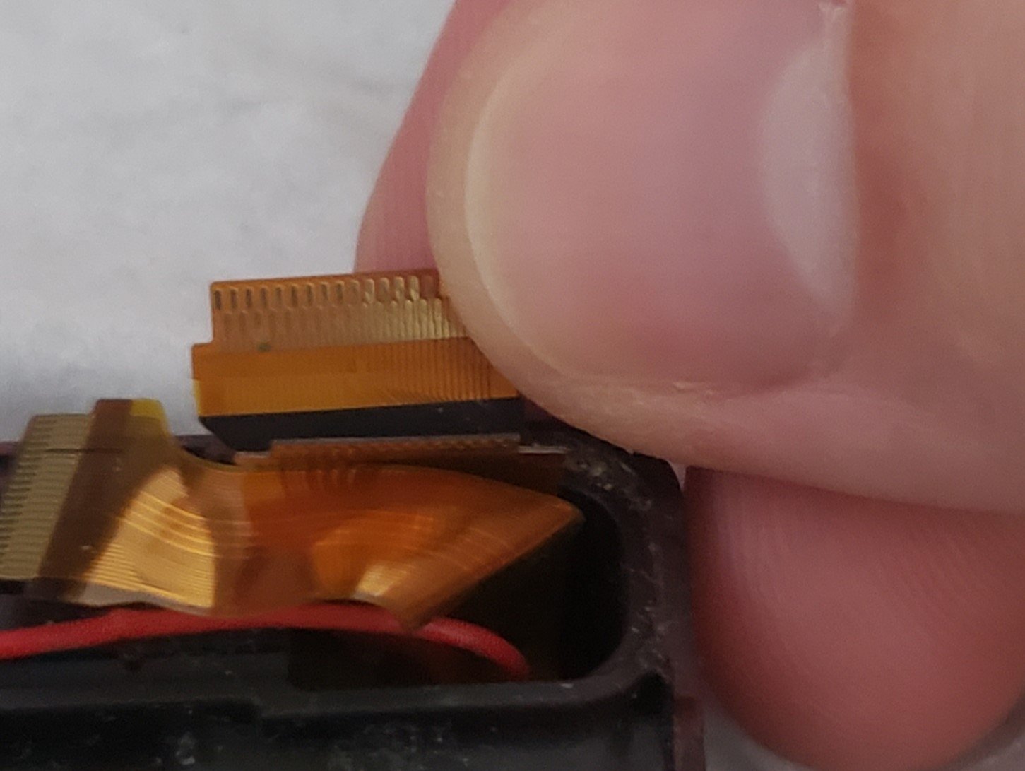

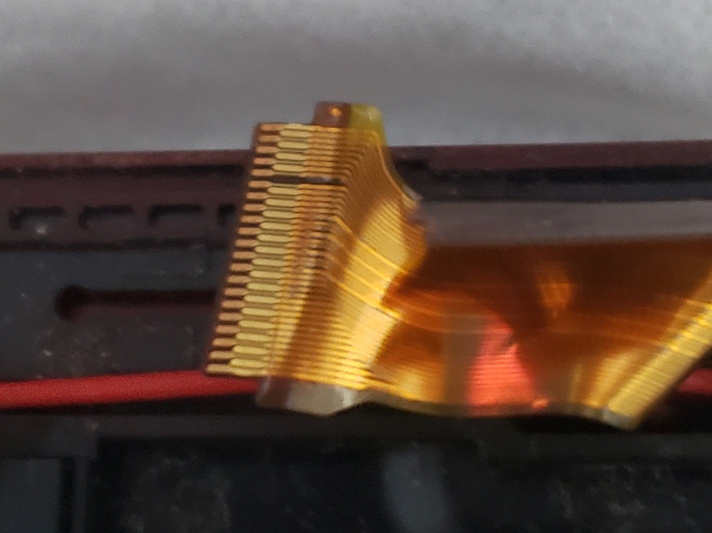

Hi everyone, I was at a 3DS event in the city yesterday, I volunteered to take any broken DSes and fix them. I have 2 that I'm having trouble with, they both won't turn on. The first one is a New 2DS XL. The owner said it was working fine until one day the battery ran out, and after they fully charged it, it wouldn't turn on. It doesn't "pop" and the screens don't flash, the blue light just comes on for a second then turns off (video attached). I tried taking the motherboard out and putting everything back in, I also tried replacing the battery, but no luck. I'm not sure exactly what to look for at this point but it's so weird that it just stopped working like that and I really want to fix it.
The second one is a New 3DS XL, when you press the power button on this one, the blue light comes on and stays on, but nothing else turns on. Again I tried taking the entire board out, but the same thing happens. One thing I noticed is that a couple of the ribbon cables look off, pictures attached. Not sure if they're supposed to look like this or not. If not then let me know if they should be replaced. I may make more posts if I need more help, since I have a few other DSes but I'm waiting for parts and I think I got it. Thank you everyone <3
  • IMG_6742.mov
    2.7 MB

It's hard for me to say, in this case. Indeed, normally when there's a hardware fault with one of the non-motherboard components, you would expect a pop from the speakers and/or a quick white flash from one of the displays (or even both of them). But if the motherboard is failing to connect with both of the displays and also the speakers, it of course wouldn't be able to do any of those things.
It could some kind of short circuit or integrated-circuit fault, either on the motherboard itself, or on a ribbon cable connection with the display or another component. There might be something that's causing the motherboard to shut off, before it even gets to the stage of attempting to initialize the displays and other critical system components.
I'd say that you could try connecting the motherboard to only one component at a time, and see if you can get a screen flash or speaker pop that way, with for example only the bottom screen and nothing else connected. I would also suggest that you check all of the microfuses on the motherboard, just in case.
If you have another 2DS XL, you can try swapping the two motherboards between the units. See if the motherboard from the faulty system will power on when connected to the components of a known-good system. Likewise, see if the motherboard from the known-good system will power on in any way with the components of the known-bad system. However! In this case, since it's very much an unknown case, if there is in fact some short circuit like I mentioned, there is a very small possibility that a faulty component could blow a microfuse or cause other damage to a known good motherboard. This is pretty unlikely, but you have been warned.
Regarding the new3DS XL, I don't have much ideas aside from also attempting to swap motherboards with a known-good unit of the same model.

Good news, after testing for a little while, I narrowed it down to the top screen. When I unplugged the top screen ribbon, it turned on. So I know what the problem is, and I just need to replace the top screen. Unfortunately, this is another problem. I was told by someone in the Nintendo Homebrew Discord that reliable N3DSXL top screens are hard to find. ifixit has none in stock, and the ones on aliexpress have a risk of not working, or even smoking/catching fire. I'm not sure if I want to take the risk, but I would like a second opinion to see if you have any recommendations for a top screen replacement.
I'm glad you managed to find the faulty component. Unfortunately, I can't give much advice on this problem. I've never replaced the top screen in a new3DS. Maybe you would be better off looking for a used, genuine screen / donor unit? First and foremost, you should ask the owner of the 3DS about this. Maybe they don't want to spend too much money, it's up to them to decide whether they want to take a risk with a potentially problematic replacement display. You should explain the situation.
Also, when you said it turned on without the top screen, did you mean that it powered on just to shut off with a speaker pop and a white flash on the bottom screen, or did it normally boot up into the Home menu? Just curious, it'd be good to know this for the future.

Sounds good. However, there is a possibility that a different part in the lid / top part is also the problem. It could be that the top screen was causing the 2DS to shut off before it's even able to go through the normal self-test sequence, but now that it's able to, it could also be shutting off because of a detected fault with a different part, and flashing the bottom screen to indicate it. But most likely, it is only detecting the absence of the top screen.
It would be good if you could test with a known good screen before buying a new replacement part. If you get the replacement part, you should first test it loosely without doing the complicated install into the top shell.
I find it weird that the new3DS XL powered on into the HOME menu without the top screen. I'm used to old 3DSes and DSi/DS systems all having the same common behaviour: top screen fault -> bottom screen flash and shut off, bottom screen fault -> top screen flash and shut off, other critical component fault -> both screens flash and shut off. Always with a speaker pop, if the speaker ribbon cable is not faulty.
But maybe with new3DS/new2DS systems, this is not so true anymore. I unfortunately don't have much experience repairing those.
Of course, there were ways to get the older systems to power on and work normally without one of the screens, but from what I remember, this always required an intentional hardware modification (soldering a resistor between some two points).
Seems an unlucky coincidence that both of the faulty systems have a top screen fault. Especially when one of them was supposedly working fine the other day.
But the ribbon cables going through the hinge to the lid are very fragile and unfortunately prone to failure. Any repair that requires routing the ribbon cables through the hinge is hard, risky, and requiring precision. I admit, I've only ever successfully done this on a DS lite, where there is only a single ribbon cable going through the hinge. In DSi and later systems, there are two or more folded together. I have not (yet) attempted this kind of repair on a 3DS, even though I have a few in my collection that need a top screen replacement.

It's been a little while but I have an update! I got the ifixit precision kit and removed the stripped screw really easily! Then I tested with the shatter but functional top screen and it turned on!!! I already ordered a new screen, replaced it last night and got it all working again.
The new screen isn't perfectly aligned but that's okay, I'm sending it back to the owner tomorrow.
As for the N3DSXL, I got a new top screen, I'll test it when I have the time and write an update here. Thank you all for the help!
Very late update, but I was able to fix both of them! I procrastinated really hard on replacing the top screen on the N3DSXL because I thought it wouldn't work, but it did! Very happy with both repairs.
