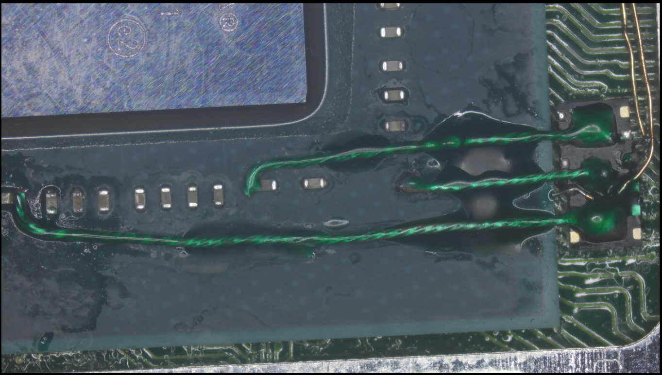

We already talked about this... Use higher diameter for the capacitors of the APU (Drain) and for the Source of the MOSFET.
Can enamel thin wire work for APU MOSFET? Sure!
How long enamel will work? Hope forever, though for how long do you think that a such thin wire can support passing high currents over 10A on each powercycle of the console? Look for the long term, at least 0.2mm or higher for those connections, for the Gate the enamel is ok, since it's only triggering the transistor.
yes, im still remember.
ill do just like dee87 mosfet . apu to mosfet 0.2mm, mosfet to rp2040 0.1mm.
Read about this, but I can't find 0.2 wire easily.
However I think I've read in this thread that sata cables actually have that kind of wire. Is that true?
Use 2 x 0.1mm parallel :rofl2:
Its difficult and ugly but worked.
yep just like the origin Dee87 schematic
Can't comment on SATA wire, I used AWG30 Kynar (stripped single conductor) which is approximately 0.25mm.
