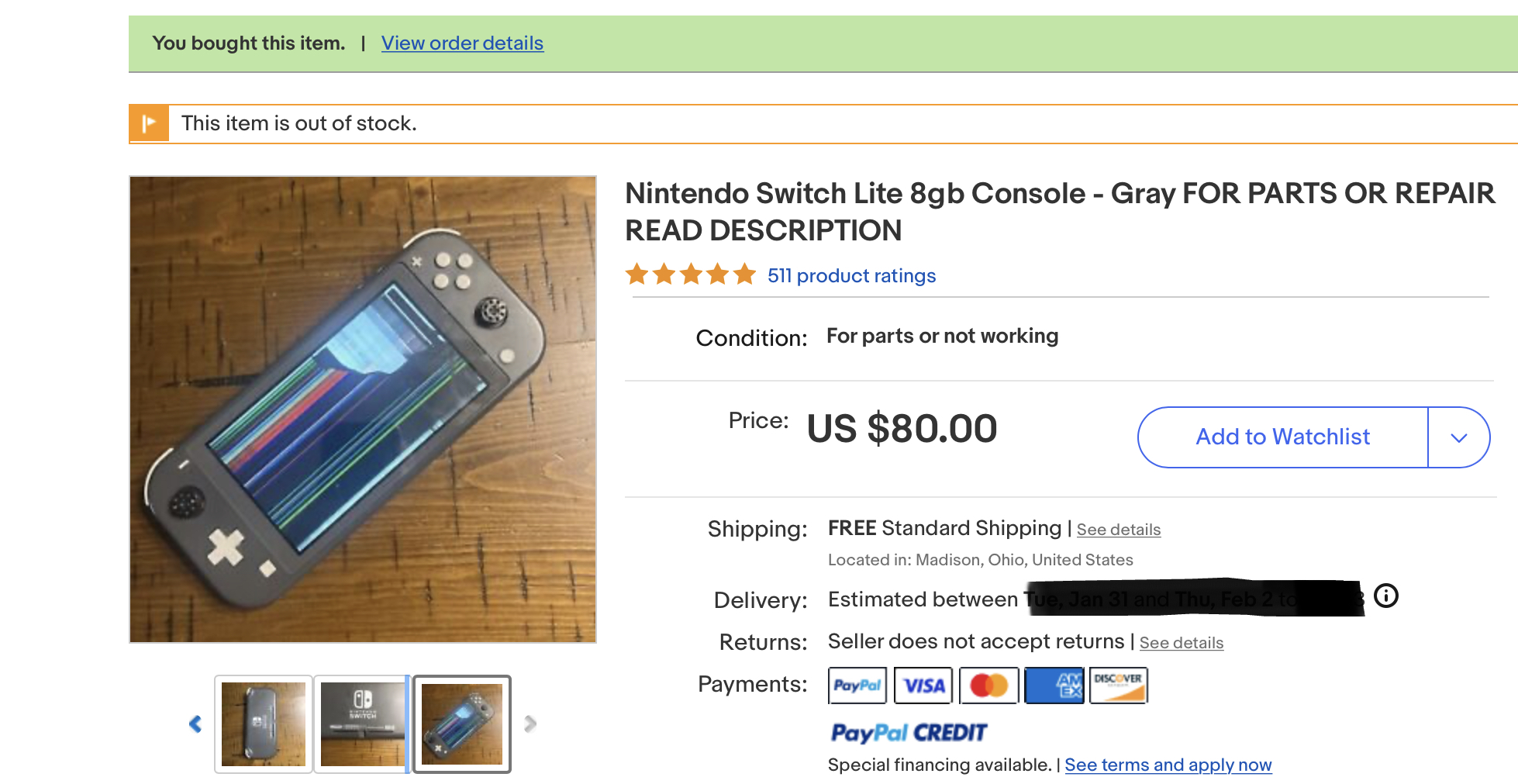

Picked up a junker Switch Lite w/ a bad screen on flea bay. The screen is cracked and the joysticks are shot.

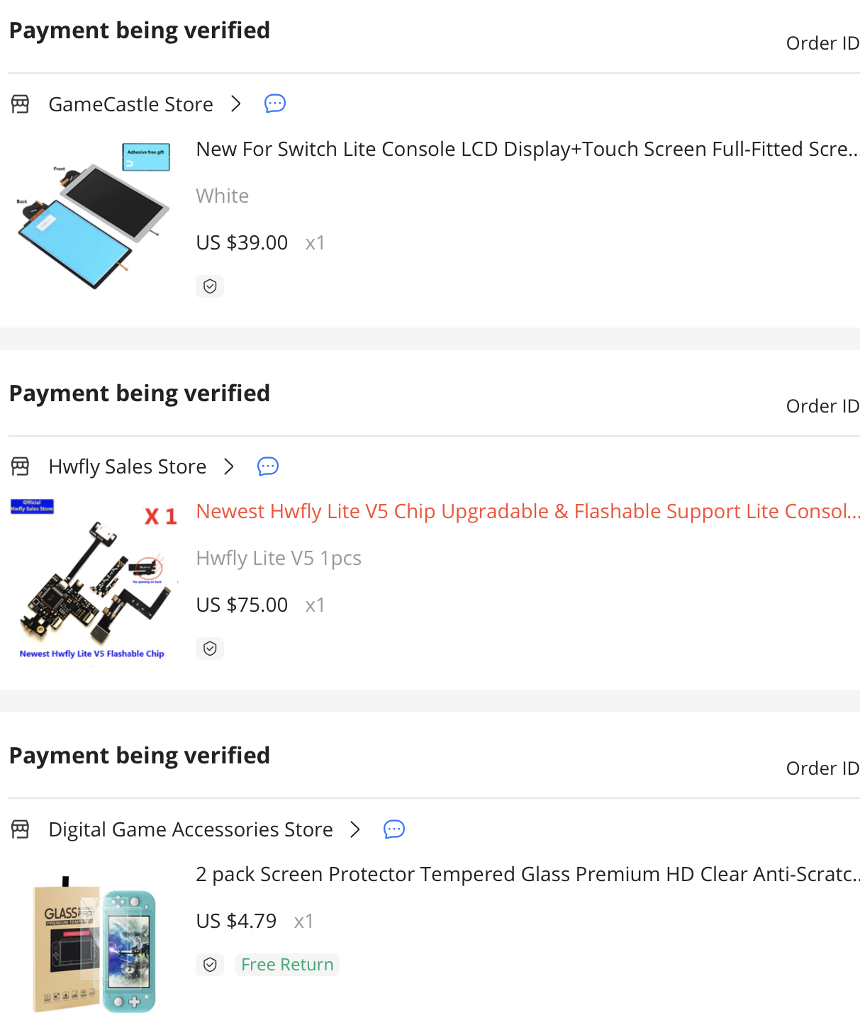

Going to put this one piece screen on it and a pair of those garbage Gulikit Hall Effect sticks on it and call it good.
https://www.aliexpress.us/item/3256804496995627.html
Grabbing a HWFLY lite kit…just in case this all turns out to be much ado about nothing.
At worst I can resell it on flea bay as a fully modded switch lite for $200 and get my money back.

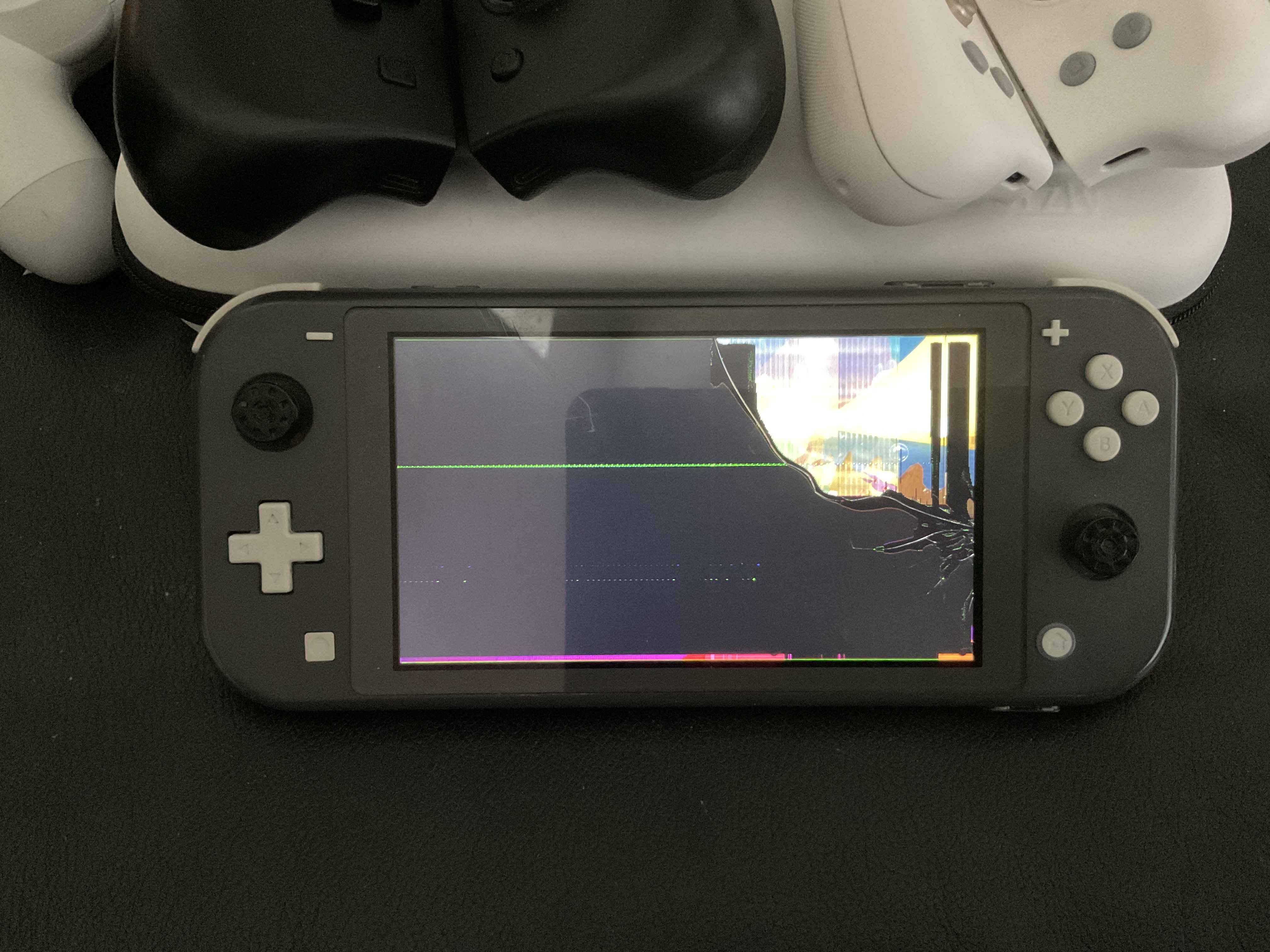

I’ve moved from wishful thinking to reality.
The screen is definitely in need of replacement.
It’s OK, the new one will be here in (/me checks AliExpress)
It’s OK, guys. We just have a little more time is all. :-)

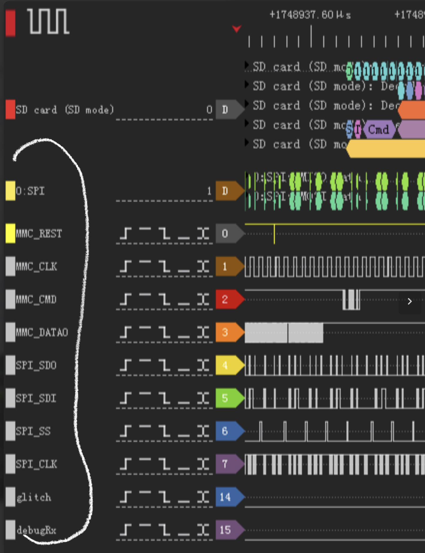

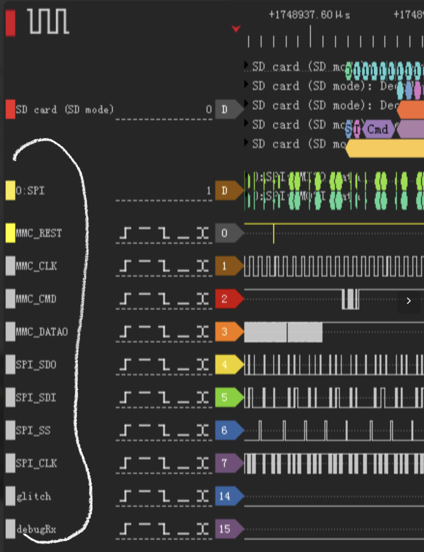

~52mHz. Need use CMD, CLK, D0 pins.

If it would help, i have an LA and an HWFLY. If somebody can tell me which points to sniff I’d be happy to work on grabbing some better data.
Oh…is that it? It looked like many more channels.
You will need to probe the reset line, dat0, CLK, CMD and the glitch line at the very least.
What the previous person has done was to also probe the spi line between the Gd32 chip and the fpga but that doesn't appear to give a lot of clues and you would need to solder extra points to the modchip if you would like to do that.
Reactions: binkinator
You would have to repeat this a few times.
1. You should probe it with the stock bootloader and the HWfly chip attached to it so you can record the whole training process.
2. You should probe a normal boot with glitch after the bootloader has been written.
3. For good measure reset the HWfly chip and probe it again.

OK, I’ll give it a shot and see what I can see.

where are all these bad boys on a HWFLY 4.2?
The OLED has them marked. V2 Switch they just say clip this to that and you’re good to go!
These are the labels used on a hwfly:
CLK is D
CMD is A
Dat0 is C
Reset is B
The glitch line is on the ribbon cable. I don't know if there is a testpad for the glitch line next to the ribbon connector on the HWfly. You could use a multimeter to find it.
The spi signals are signals on the pcb of the HWfly between the fpga and the Gd32 but I don't think you will need these necessarily.
