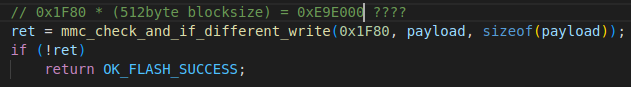

To anybody who's bored and knows a bit about the HWFLY-NX firmware, what the hell is this code at line 69 (nice) in firmware/src/payload.c?
(Link: https://github.com/hwfly-nx/firmware/blob/master/firmware/src/payload.c)

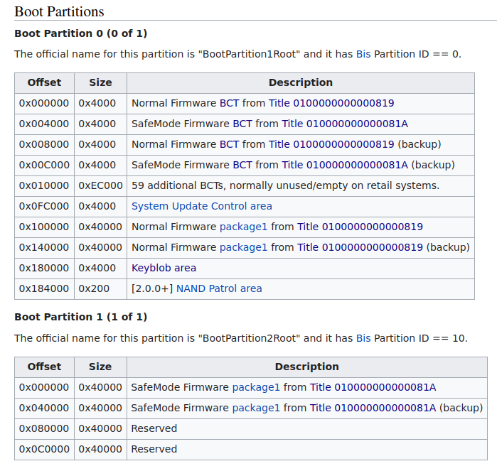

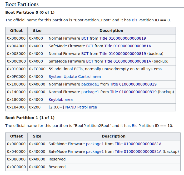

The BCT offsets above that (0, 0x20, 0x40, 0x60) all make sense if you multiple them by 512 (I've guessed that that's the block size), you get the exact offsets the wiki says:
Only this "payload", which I assume is the actual HWFLY / Spacecraft firmware, seemingly makes no sense why the offset is 0x1F80 * 512 = 0xE9E000
package1 (NX Bootloader and stuff like that) starts at 0x100000, this payload is way beyond that and I haven't found anything for this address space..
I'm just curious and learning the code though, please don't get any wrong ideas.
0x1F80 * 0x200 = 0x3F0000
Maybe it's not a block number, but an address? (1F80)
Lmao how did I get this multiplication wrong? Maybe I was too sleep deprived.
Anyway, the function "mmc_check_and_if_different_write" internally calls "mmc_read" with the same parameter. mmc_read only reads a single full block, which is 512 bytes.
So this has to be a block number (0x1F80) and its actual address is 0x3F0000.
Problem is, 0x3F0000 still doesn't make sense to me.
(sigh) This code has as little documentation as I write at work :(

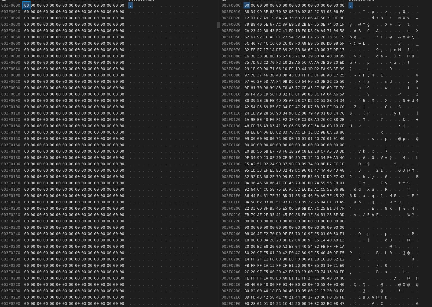

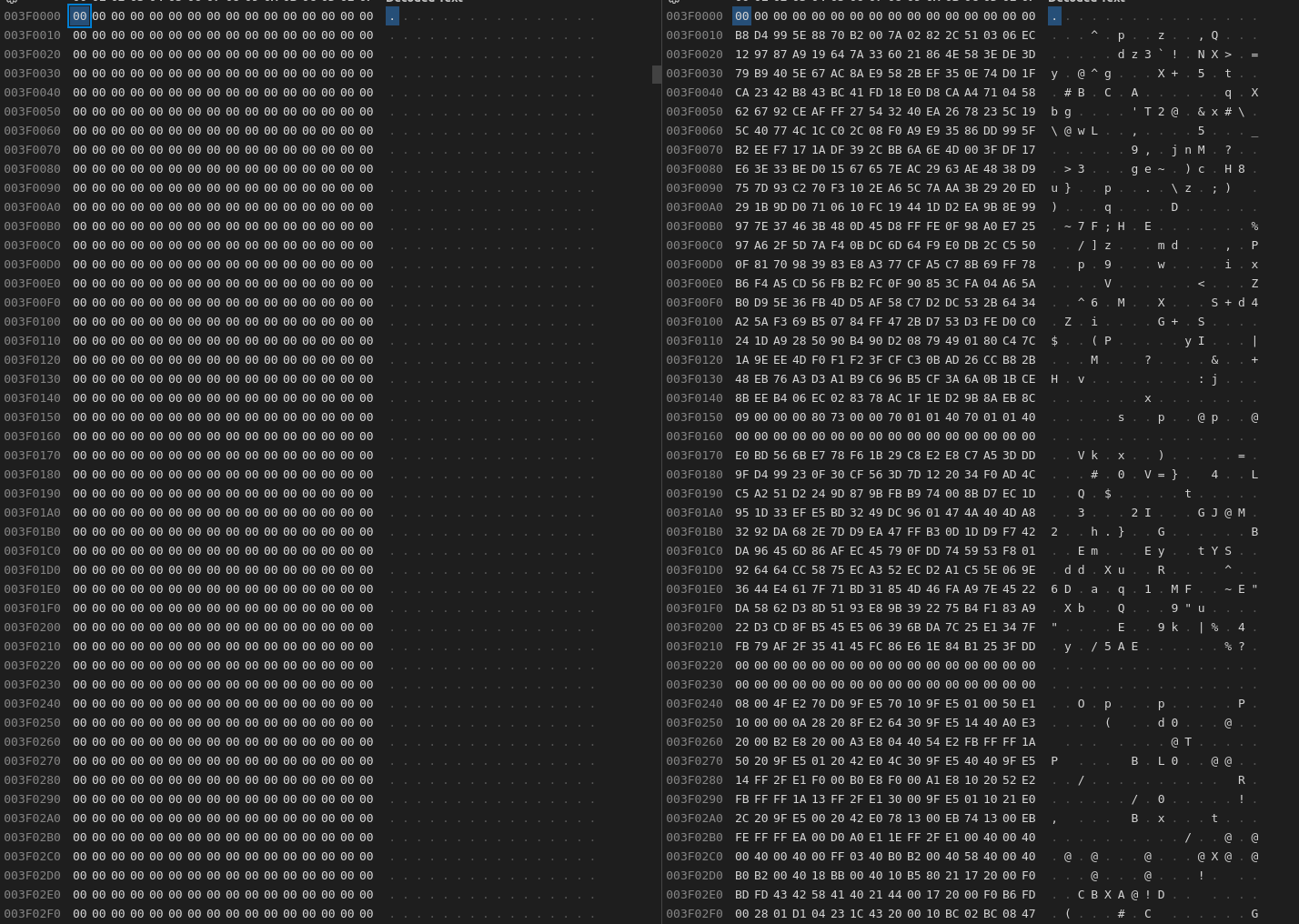

Im dumped my old switch emmc witch progger(UFPI).
On the example of these files, you can understand at what addresses the code is being changed. With such success, you can write such a glitch from scratch. The source code of hwfly is there and everything is described there.
The problem is that I'm not strong in the C language (
Thank you! It seems like 0x3F0000 isn't a special memory address used by Nintendo, if your dump is complete and legit.
I think this is just empty space which HWFLY / Spacecraft-NX uses to store the custom payload. Man I'm dumb..
This means the BCT must redirect the bootloader to run the code at this address next instead of package1ldr
(Left is the "no glitch" file and right is the glitched file)
yep. Im used https://github.com/hwfly-nx/firmware 0.72 version.
check firmware 0.72 in archive. find on HEX this bytes)
my dumps fully work)
