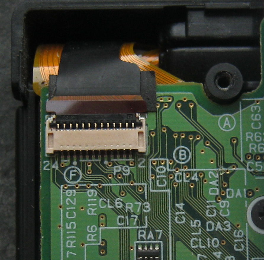

I can confirm the "An error has occurred"-screen for hardware issues. Disconnecting the camera lets the DSi boot to "Launcher" normally. Pressing (L) or (R) for taking a photo results in the error screen. However, opening the camera app does not crash.
So I think it can be hardware or software issue.
Do you know any other ways, or should I just try to hardmod the system?
I guess your problem is that the camera app wants to run the pointless tutorial – where you have to take a photo and trying to do so→ ERROR!
First check if the camera ribbon is connected correctly, not torn and the connector looks okay. It is near the (R)-button. Maybe remove and reinsert carefully.
If cable and connector look good but it does not work… this will suck:
https://www.ifixit.com/Guide/Nintendo+DSi+Dual+Camera+Assembly+Replacement/4159
(if you even find a replacement camera module).
Because it could as well be a software issue – zoogie knows this waaay better than me – it is not an easy target for troubleshooting. So many possible causes of error.
If you're good at soldering you might as well try the hardmod (removing mainboard – no taking ribbons out of the hinge).
