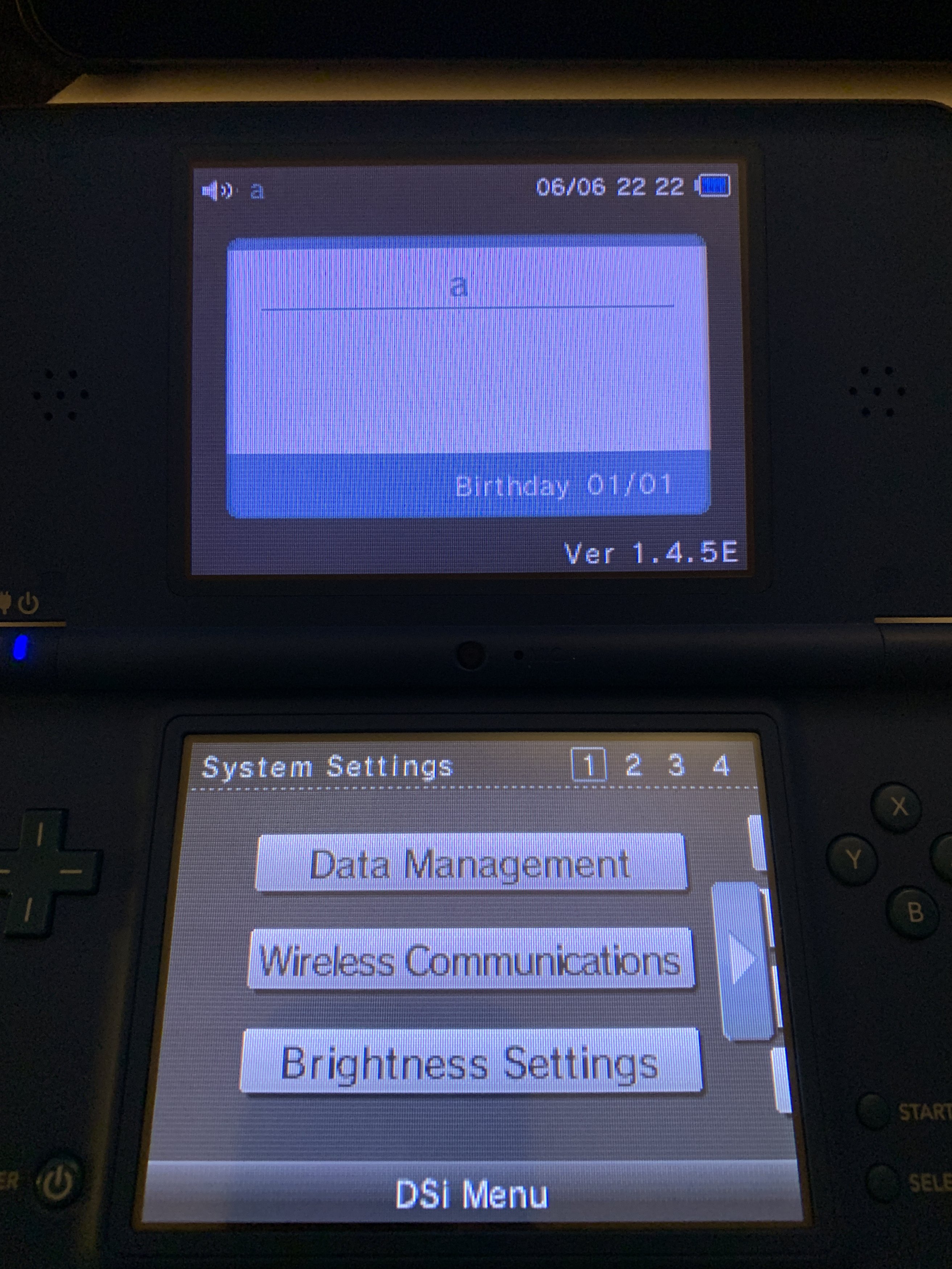

Guys - I've just done the exploit and got to the Unlaunch launcher. Moving around in there all ok, and then I guess I selected (pressed right) on Launcher I think.
Now when I reboot the DSi it goes straight to the DSi system prefs. See attached. Any ideas? I did backup my nand.
Help appreciated and couldn't see anyone else has had this issue on the thread. Cheers

Hello.:)
Please check first:
Power on your DSi while holding SELECT.You should get to the HiyaCFW configuration screen.Is Autoboot title checked ?
I didn’t get as far as installing HiyaCFW :( this was at the stage of putting unlaunch on the root and first boot after that.
Do I have a dead DSi or is there hope?

How is it dead if it's properly booting a title?
Go back in Unlaunch's menu (A+B+power) and change the autoboot you configured and apparently don't like :P

Absolutely spot on, thanks Ryccardo!
Dead... I meant, maybe I'd screwed the firmware or the nand to the point of no return. I know zero about the DSi :) But this place is very helpful, rare for a forum!!
Thanks all, now onto the next stage.
