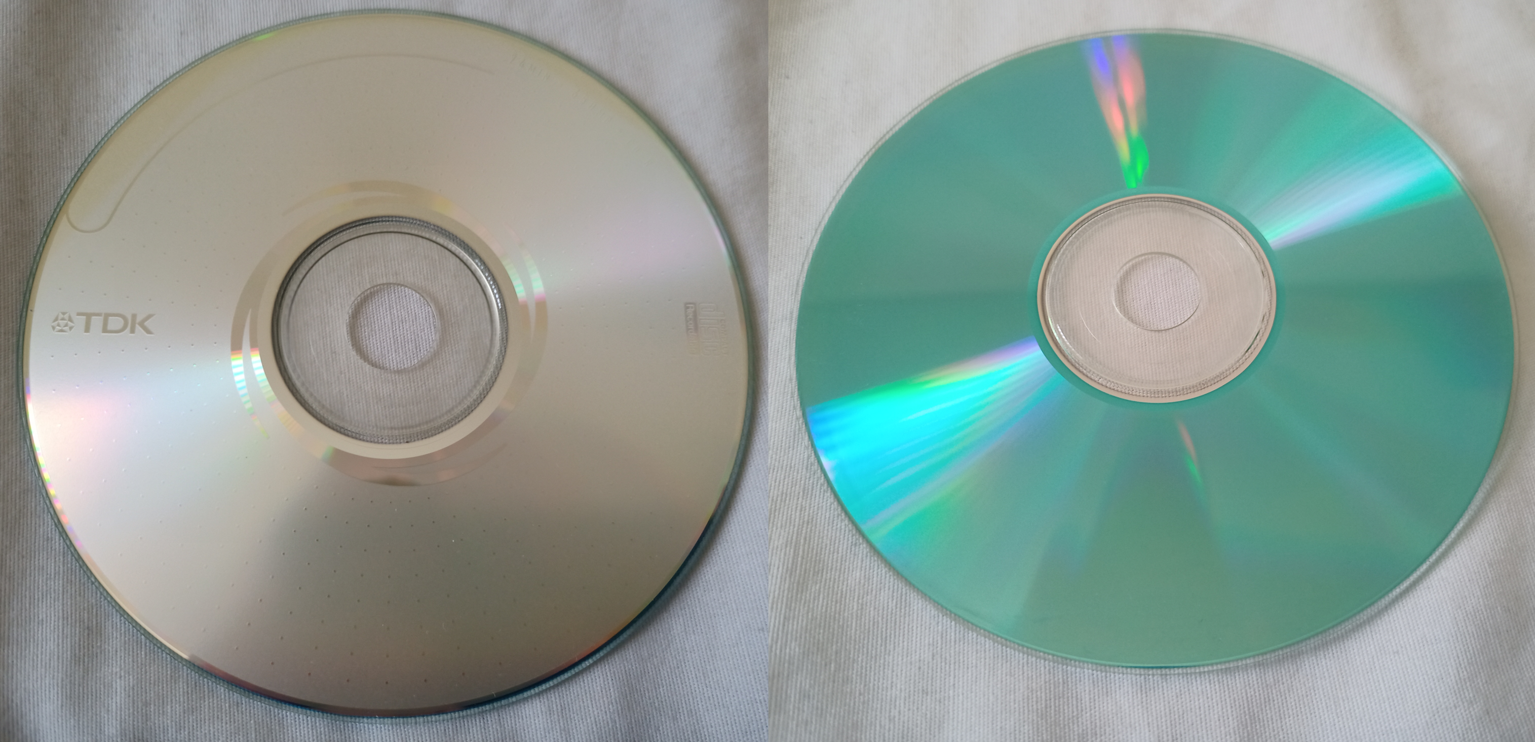

I was over at a friend's house and sitting on her home office desk was this spindle of CD-R IMG_20240414_161329_332.jpg, still with it's sun faded label showing that it was made in Taiwan. I got it for free from her as she totally forgotten why she kept it around.
3 of the discs was already burned. But the good news is that it only 1 of blank discs was a Memorex 74min CD-RIMG_20240414_161743_997.jpg and the rest of the 15 blank discs were TDK 74min CD-RIMG_20240414_161753_255.jpg. Comparing the back of the 2 discsIMG_20240414_161712_061.jpg, the TDK one is much more blueIMG_20240414_161721_121.jpg.
The ImgBurn info for the Memorex:
Disc ID: 97m26s66f
Manufacturer: CMC Magnetics Corp.
Start Time of LeadIn: 97m26s66f
Last Possible Start Time of LeadOut: 75m00s00f
The ImgBurn info for the TDK:
ATIP Information:
Disc ID: 97m24s01f
Manufacturer: Taiyo Yuden Co.
Start Time of LeadIn: 97m24s01f
Last Possible Start Time of LeadOut: 74m43s00f
I was so surprise that the TDK discs were made by TY, as Alex's guide shows the ones made by Ritek. My friend didn't have the original spindle/label for the TDKs, but I'm pretty sure these TDKs were made in Japan being disc info shows TY. Guess either TDK had multiple sources or switch from TY to Ritek as some point.

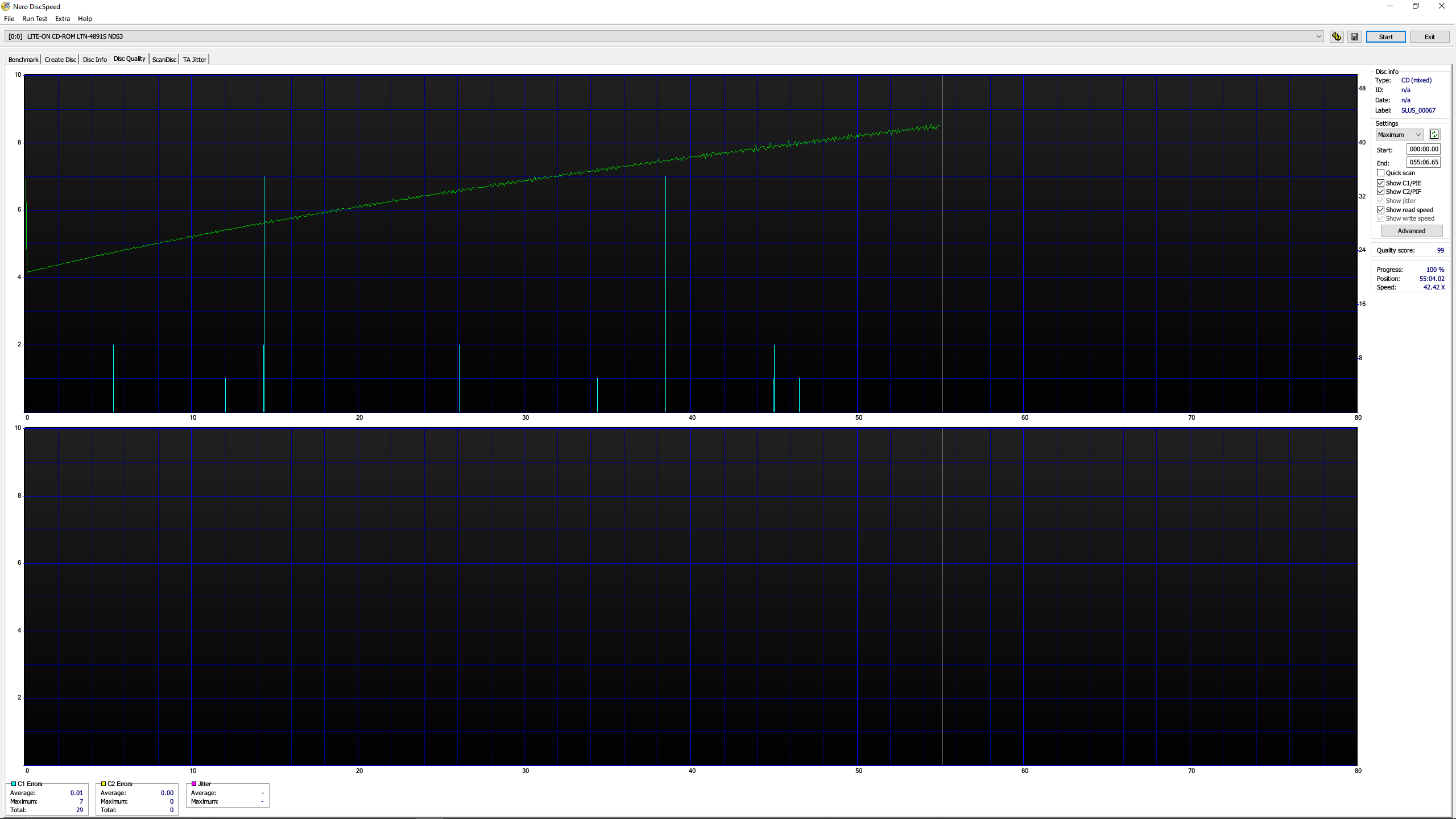

Here are the benchmark results from a disc burnt with that setup, a C1 average of 0.3, maximum of 22, and total of 976, which as far as I can tell is REALLY good. Just for fun, I also tested a scratched up original FFVII disc, and that recorded C2 errors (the really bad type!) at a maximum of 5,209 and a total count of 53,438!

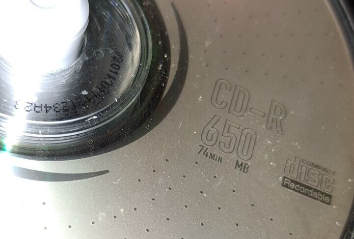

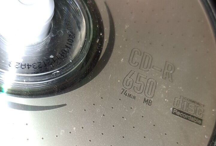

Ok, I found my box of blank disc media. Mainly different brands of BD-R, DVD-R, DVD+R, and some CD-RW. But I did find a spindle of the Sony CD-R 700MB.IMG_20240417_181248_827.jpg So I don't have the original label on the spindle. By looking at the photos on multiple eBay listings, they were made all over the places including Taiwan, India, Malaysia, and etc.
Here are the photo of the frontIMG_20240417_191307_072~2.jpg and backIMG_20240417_181425_300.jpg of the disc.
The following is the ImgBurn disc info.
ATIP Information:
Disc ID: 97m24s16f
Manufacturer: Sony Corp.
Start Time of LeadIn: 97m24s16f
Last Possible Start Time of LeadOut: 79m59s74f
Once again like the TDK by TY, I am surprise that these Sony CD-Rs being made by Sony themselves. So were these made in Japan? No idea.

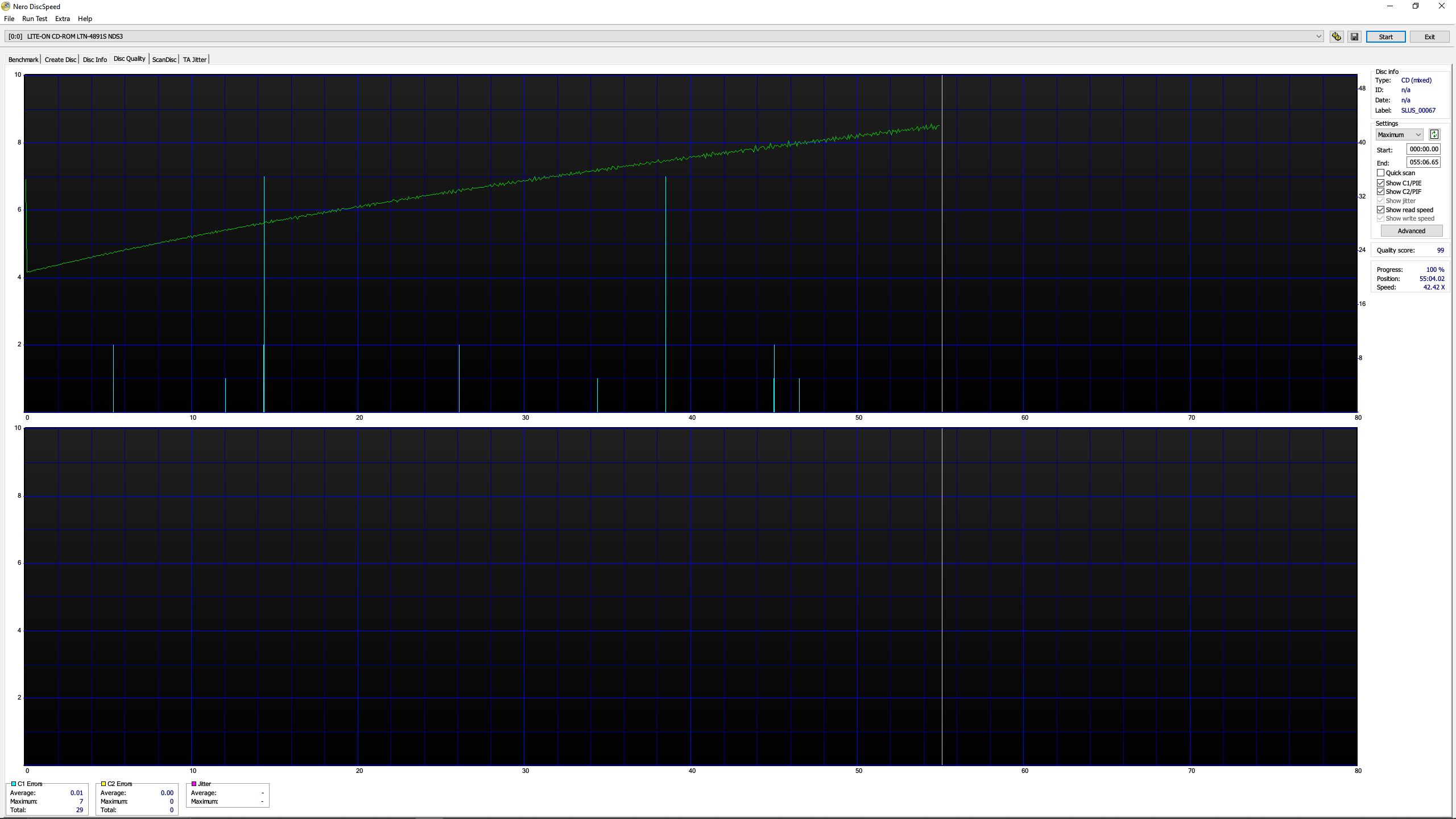

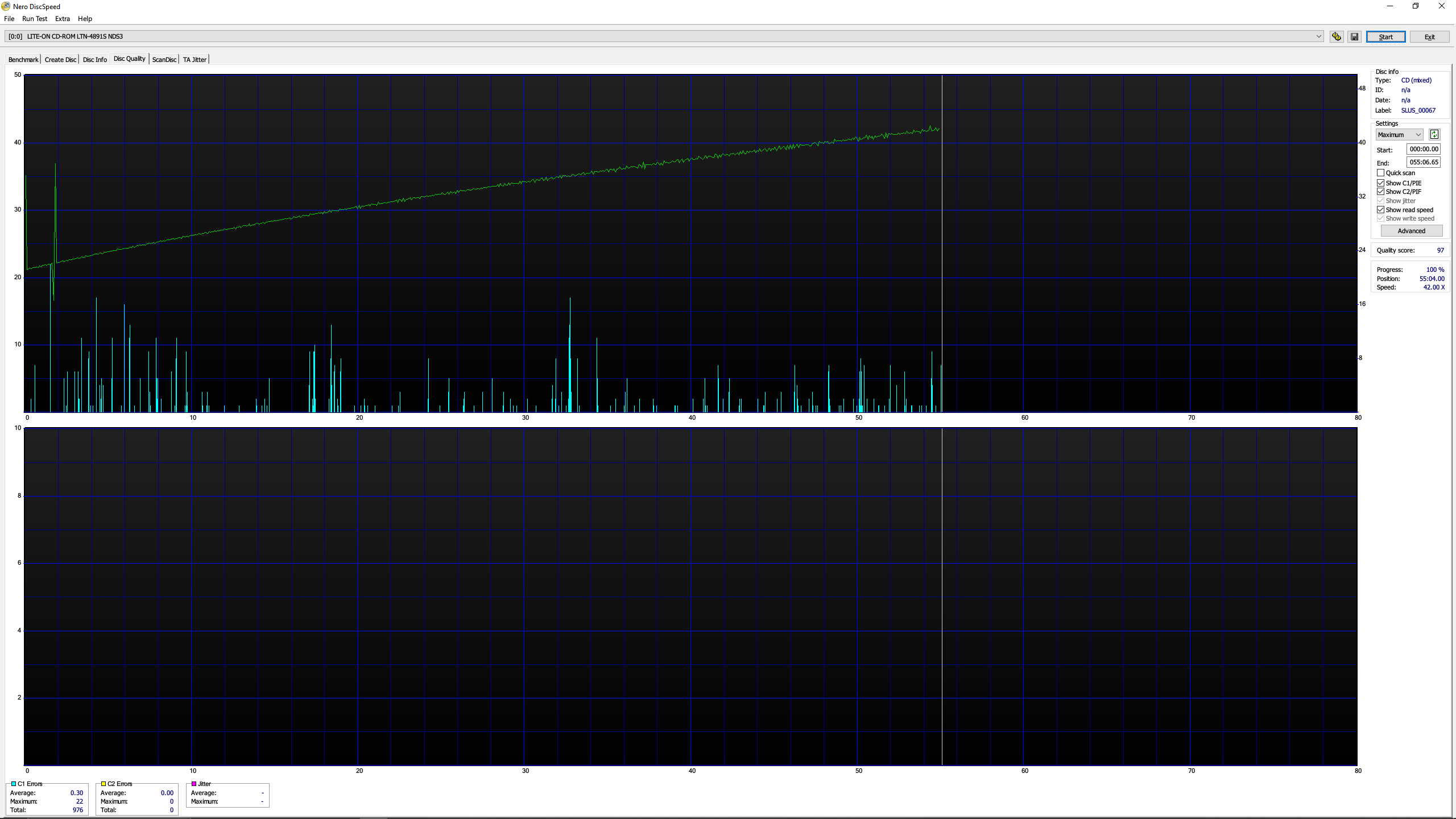

The result disc quality test for the 16xSony 80min - iHAS124b - 16x.jpg and 48xSony 80min - iHAS124b - 48x.jpg. While both had 0 C2 error, the 48x has less C1 error compare to the 16x. Confirming the actual PS1 test that it's better to burn at a higher speed for these Sony CD-Rs. I'm really tempted with burning one of these on my crappy GTA0N at 48x and see what the result is like.

The result disc quality test for the 16x and 48x. While both had 0 C2 error, the 48x has less C1 error compare to the 16x.
C2 errors should happen rarely. A disc showing many of those is close to it's end of life. Worth noting that a single E31 can result in a whole bunch of C2 (E22) at this specific point. First layer of error correction is unable to restore the data resulting in a huge amount of failures to correct at second stage.
On a freshly burned CD-R this should not exist. I've seen it happen when imperfections (visible using magnifier "bubble") on the disc. Such a thing will lead to early E32 (uncorrectable) error when the disc ages. This is still *not* data loss for "Mode 1" or "Mode 2 Form 1" as the third stage of EDC/ECC in user accessible data provides additional redundancy for this case.

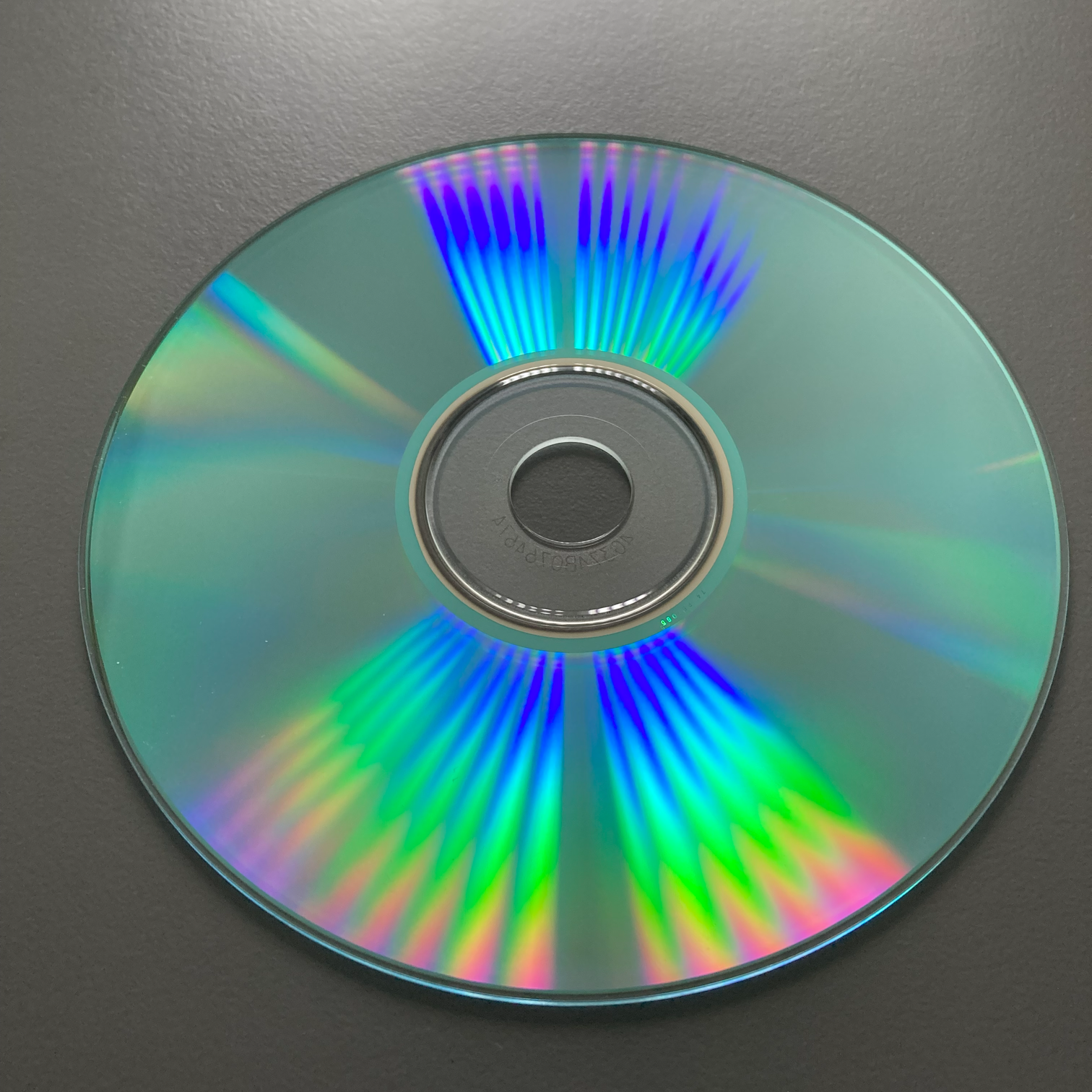

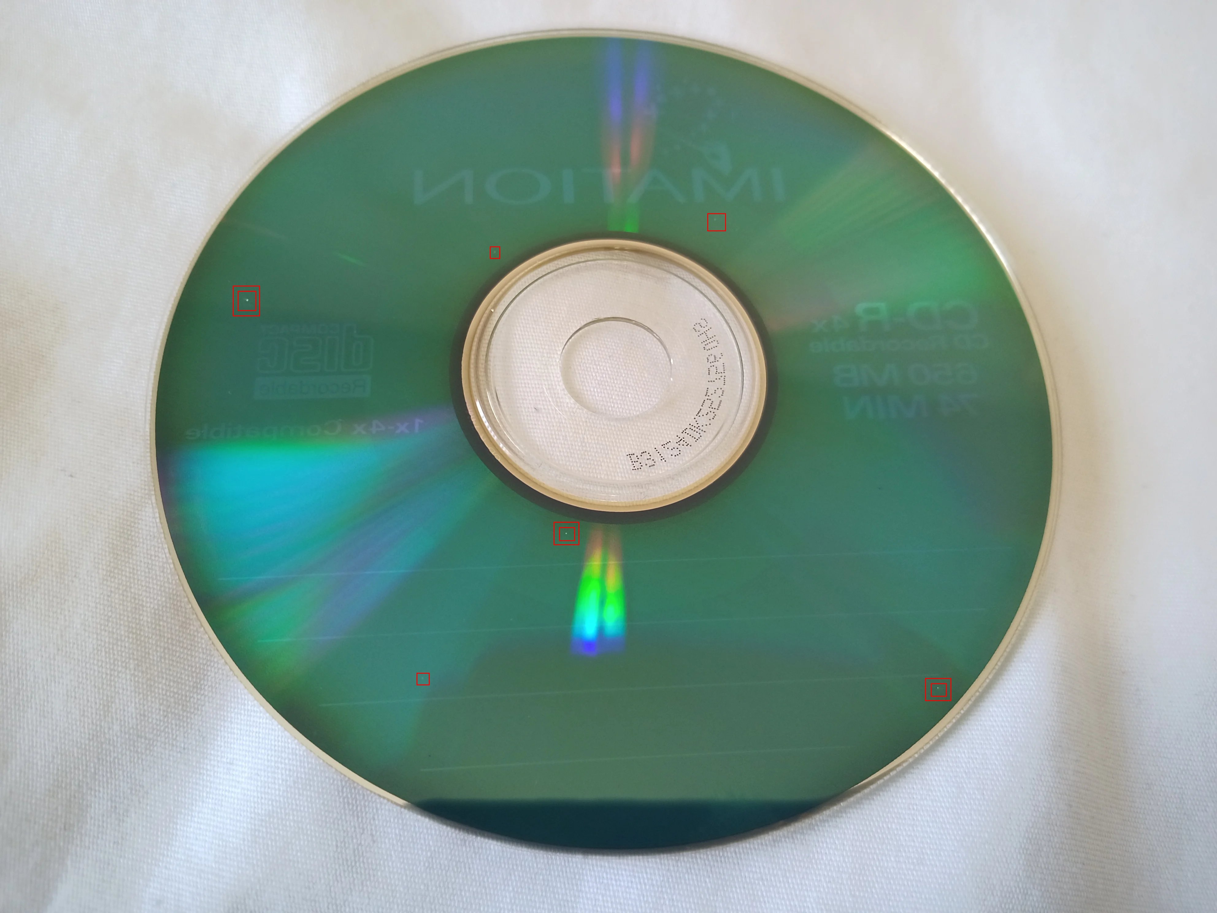

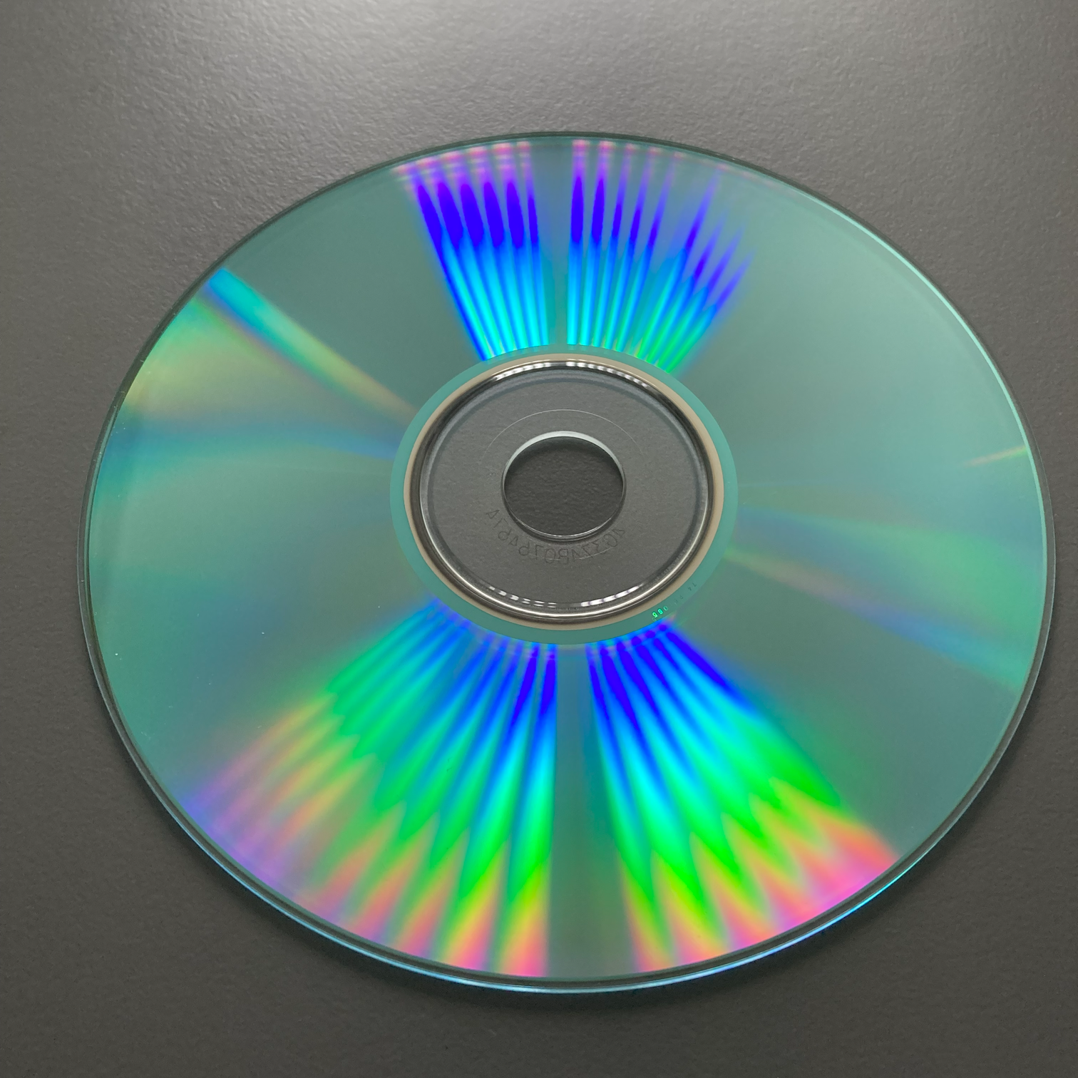

My iHAS124b can't even read the 2 burned discs and on one them, you can even see through the other side of the disc
CDs are semi-transparent when no opaque label is present. Even PS1 discs are somewhat transparent (Platinum series without colorful label).
However, there are some bright dots on your picture that look like missing layers (reflector, data, lacquer). I've marked a few positions that look questionable.
Even the unused ones might be bad. I've seen bad CD-R literally losing flakes of the upper layers after trying to burn them.

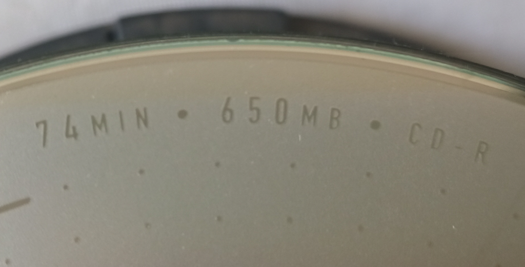

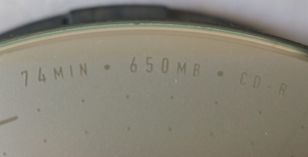

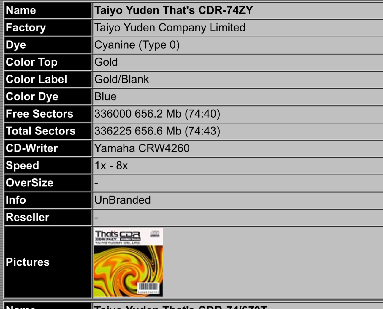

Quick update on those 74 minute TY's that I got, they're working incredibly well! Interestingly, the atip data from them is extremely similar to the TY That's CD-R CDR-74ZY:
ATIP info from disk: Indicated writing power: 4 Disk Is not unrestricted Disk Is not erasable Disk sub type: Medium Type A, high Beta category (A+) (3) ATIP start of lead in: -11849 (97:24/01) ATIP start of lead out: 336077 (74:43/02) Disk type: Long strategy type (Cyanine, AZO or similar) Manuf. index: 25 Manufacturer: Taiyo Yuden Company Limited

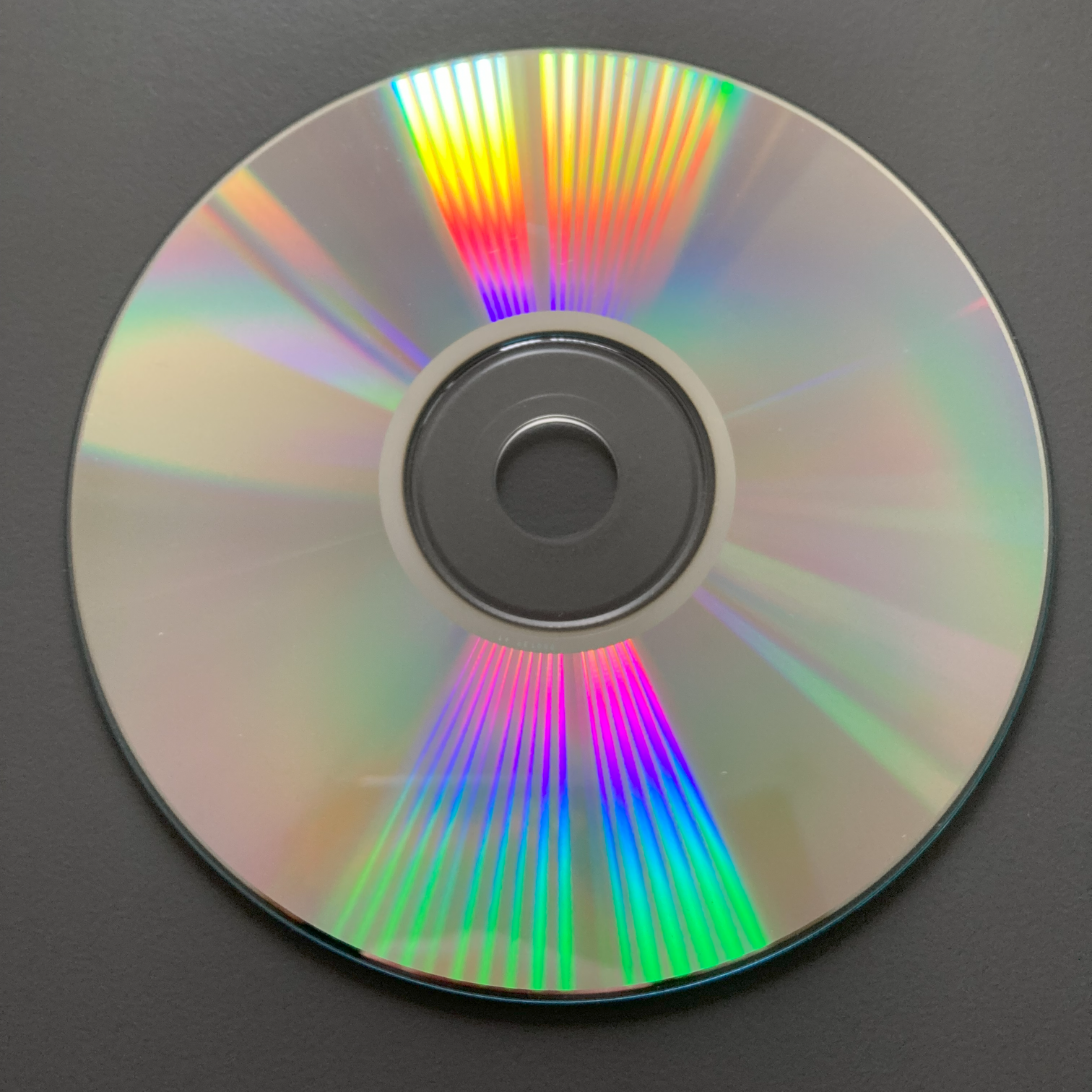

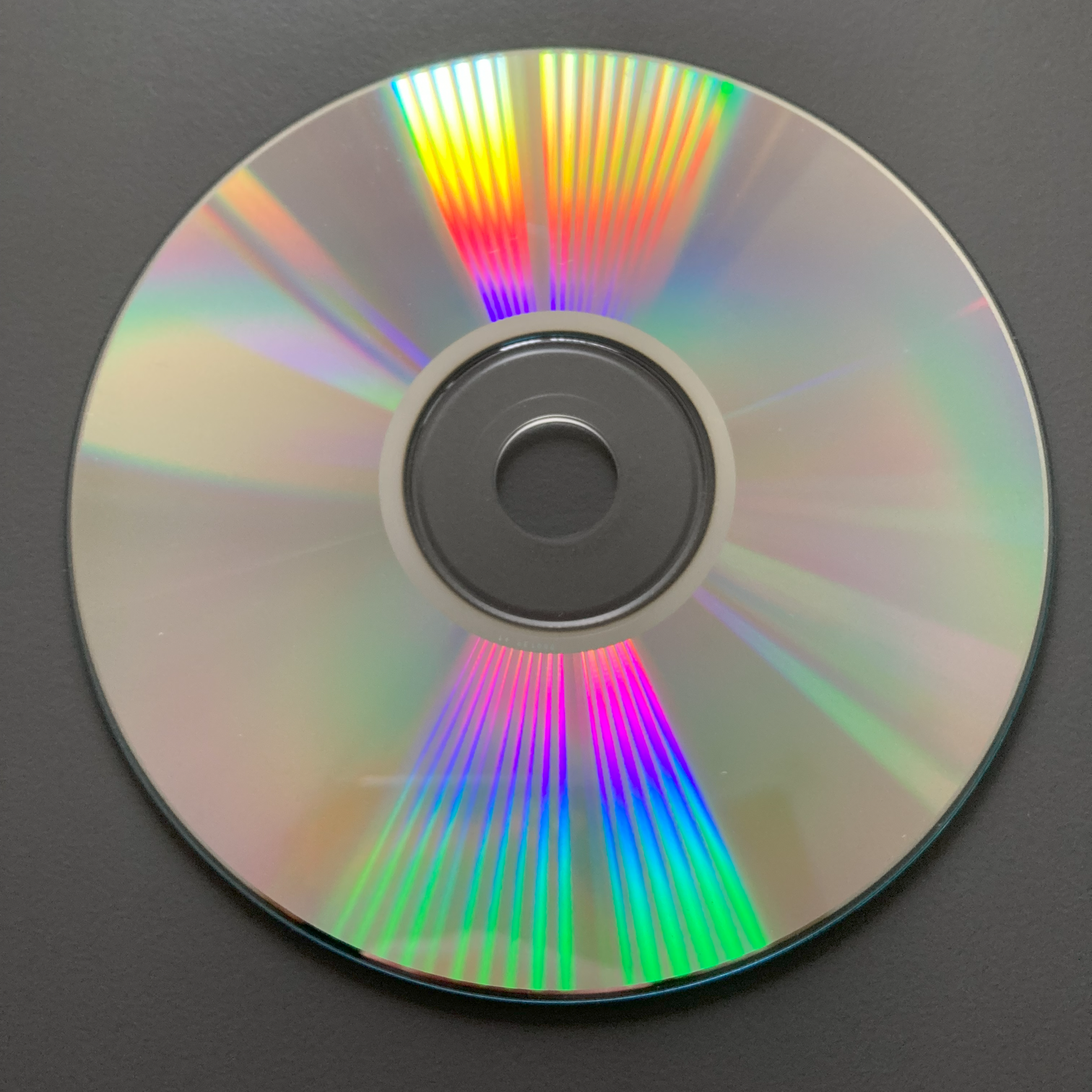

Here's a couple of photos of it, it's a "shiny silver disc" so it's not inkjet printable, which may be a downside of these for some people:
And here's the error data, and while I don't expect any known good disc to fail this, it's cool to see either way. This is actually the lowest error rate I've ever seen on a disc, it even beats out my best pressed CDs! Only 29 C1 errors across the entire disc is absolutely nuts to me

Mine were listed as "JVC Taiyo Yuden CMC Shiny Silver Blank CD-R CD 48x 74min 700MB Discs", but I've seen them listed as "CMC Pro/TY CD-R Shiny Silver Silver Prism Black" discs too. The first listing was a bit confusing, since obviously a 74 minute disc would be 650MB, but they did end up being true 74 minute discs.
They are indeed a lot cheaper than the That's CD-R's, I managed to grab a stack of 100 for ~£30 shipped, and I've seen 100 listed for £10 too (although that seemed a bit too good to be true for me).
Looks like this has the same ATIP data(a tiny different in the lead out) for the TDK 74min that I had posted earlier.

That's actually identical to https://alex-free.github.io/psx-cdr/#taiyo-yuden-thats-cd-r-cdr-74zy-74-minutes . The JVC Taiyo Yuden CMC Shiny Silver Blank CD-R CD 48x 74min actually differ a bit in lead out, not the other way around. I want to add both these to the guide as 'tier 1' CD-Rs (I'm trying to group them for clarity on quality, and it seems this ATIP info works best for the PSX). Any more info on a brandname for your TDK 74 minute CD-Rs? Pics would be enough if it's not available. Thanks!

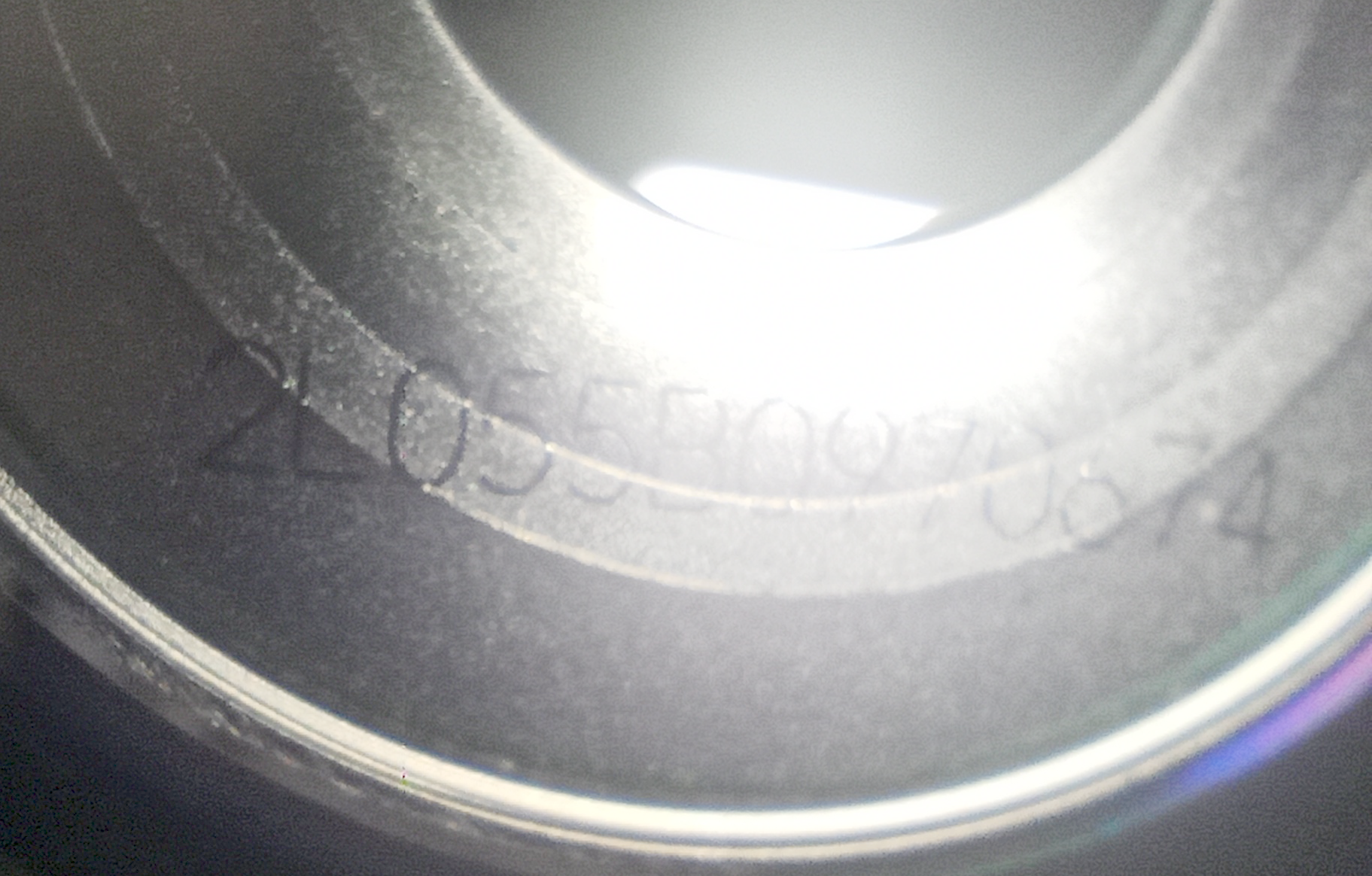

As I mention in the earlier post, these TDK Taiyo Yuden were in a spindle with no label. The pattern on the top of disc looks almost the same as the ones made by Raitek that you have showing in your guide.
I did find an eBay listing for the TDK with the spindle labelTDK made in Taiwan1.png with the text "CD-R 650MB 74min" in large print on the right side of the discTDK text2.png, so I contacted the seller and got a reply that it was made in TaiwanTDK made in Taiwan.png. While the TDK Taiyo Yuden has the text "74min 650MB CD-R" in tiny print on the top right edge of the disc.TDK text.png
So for now, I'm assuming that LARGE print was made in Taiwan by Raitek(or CMC) and tiny print was made in Japan by Taiyo Yuden.
View attachment 433801View attachment 433799
I did find an eBay listing for the TDK with the spindle labelView attachment 433840 with the text "CD-R 650MB 74min" in large print on the right side of the discView attachment 433809, so I contacted the seller and got a reply that it was made in TaiwanView attachment 433839. While the TDK Taiyo Yuden has the text "74min 650MB CD-R" in tiny print on the top right edge of the disc.View attachment 433808

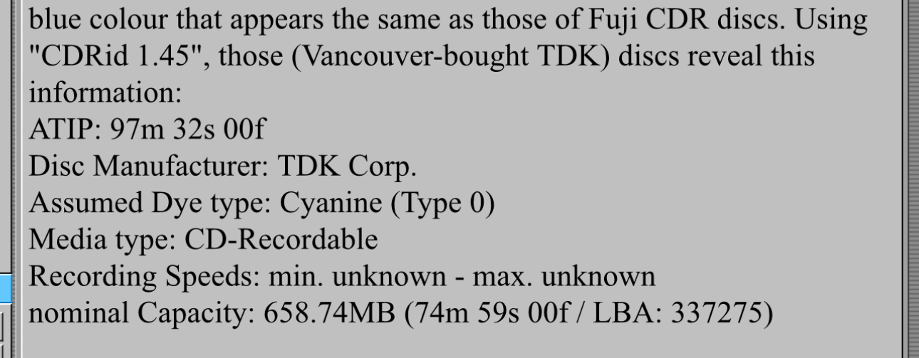

I can kinda agree I had a ton of duds in the tdk riteks, but the ones that worked did work well. Might want to take those off the guide.
And here we are ladies and gentlemen, cyanine type 0 is the best dye for PSX ! I want to check out this tool they keep mentioning:
CDRid seems promising. Cdrecord never really gave a specific dye… Much to update in the guide. Also I bet that Yamaha CRW4260 drive is pretty sweet.
