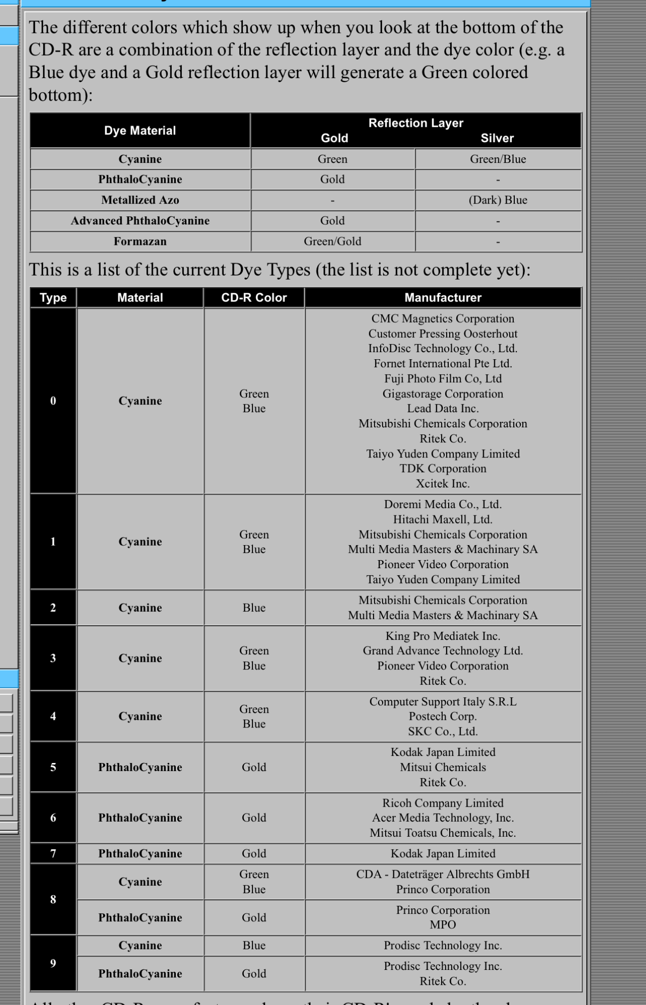

CDRid seems promising. Cdrecord never really gave a specific dye… Much to update in the guide. Also I bet that Yamaha CRW4260 drive is pretty sweet.
I have some good news and bad news on CDRid front for you. After trying in vain with the word "CDRid", I finally searched for "CD-R ATIP Software" and found this page from a guy mirrored a copy of it from the Internet Archive. The bad news is that the software from 2002 only works under ASPI layer for Windows, so it's not detecting any of my drives that is using Windows' SPTI layer. Hope you have better luck with CDRid.

https://cdmediaworld.com/hardware/cdrom/cd_dye.shtml

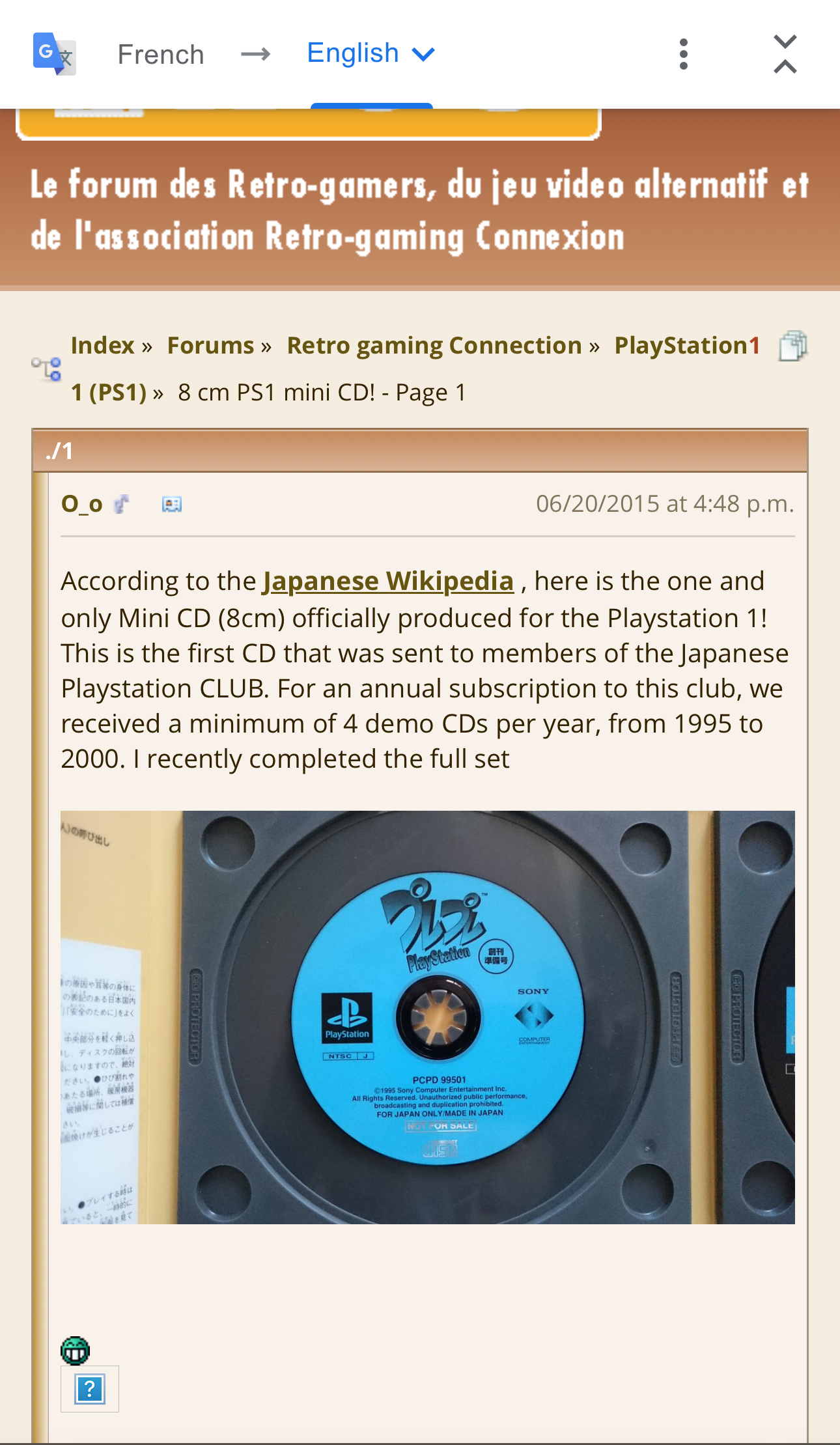

https://www.yaronet.com/topics/171270-mini-cd-ps1-de-8-cm
As mini CDs were previously mentioned:
https://gbatemp.net/threads/do-mode...ality-ps1-backups.628708/page-5#post-10248701
The only viable way to test out the 63 minute discs are with their 8cm mini cd counter-parts. That crazy $400 listing was never bought for the 12CM 550MBs 63 minutes imagine that😂 https://www.ebay.com/itm/1857639638...dasgv_hr_o&var=&widget_ver=artemis&media=COPY
@SylverReZ said they didn’t get good results with one before though, I wonder if it was a mini cd burned with a good drive, if it was an 80 minute density equivalent, 74 minute equivalent, or 63 like the Mavica discs.

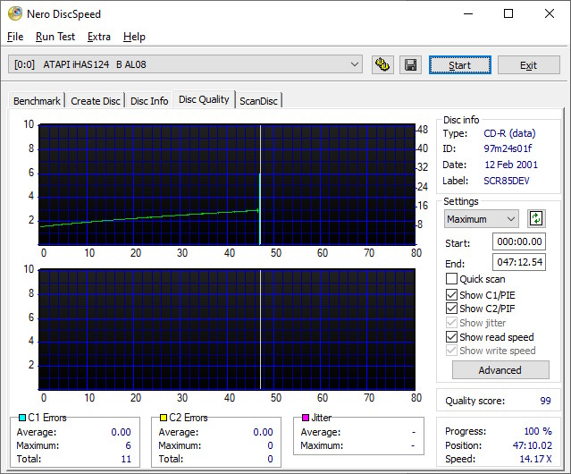

My oldish ihas124 E seems to burn copies fine.
Last copy I ran off years ago at x16 on a Verbatim Pastel cd-r (these are taiyo yuden), worked fine on both my old 9000 series that is my original console from back in the day with a random 4 wire chip and has probably never seen an original disc and also my PS One, PM-41 (2) motherboard with a Psnee in it.
No issues at all, no fmv skipping, no struggling to load.
Can't remember if it was an x48 or x52 disc though (I have both on the shelf). They are on this page here https://ez647.sk/verbatim.html

I've not dug too far into it, but Taiyo Yuden is what imgburn reported them as
That's a pastel 52x disc. Taiyo Yuden, or so the atip claims. x48 disc is also reported as Taiyo Yuden.
Says the pastel discs are Taiyo Yuden as well.
