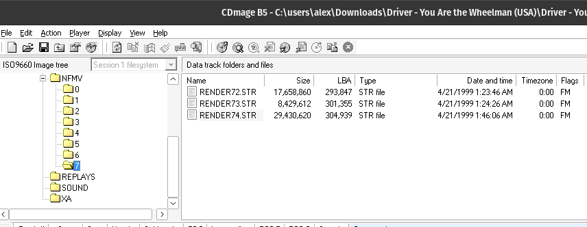

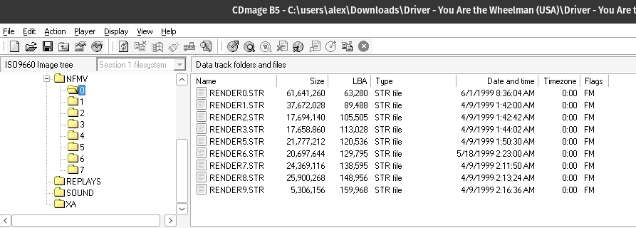

Looks like the disc is almost entirely made up of FMV data. FMV data spans from LBA 63,280 to well past 304,939,.. The earlier the LBA, the faster physically the drive spins the disc to reach 2x speed, the more likely it hits disc read issues with cheap media? That first FMV is also the biggest (from a glance).
The intro FMV seems to be on the outside of the disc (I have the PAL version, maybe it's different?). If I turn the power off when the FMV is playing, the laser pickup is at this point:
Maybe the outside of cheap discs have more wobbling?

It's possible the FMV filenames are not really the order they are played by the console, and the intro is actually one of the last/highest names on the disc. FMVs, XA audio, and CDDA audio (probably in that order) require optimal performance which is why this is such a great test.
