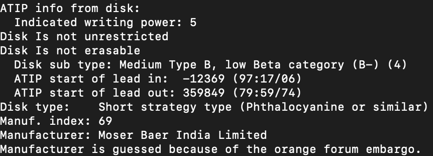

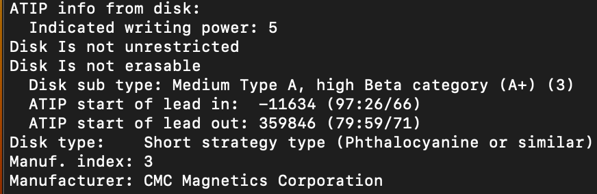

First CDs are Sony, Verbatim and Tevion (Cheapest Discounter Product). Funny thing is Atip Info of Verbatim and Tevion are exactly to the point the same, but dont know if that is enough to indicate those being the same rebranded discs:
Sony:

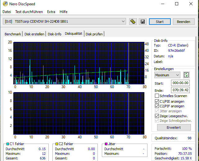

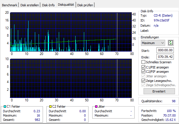

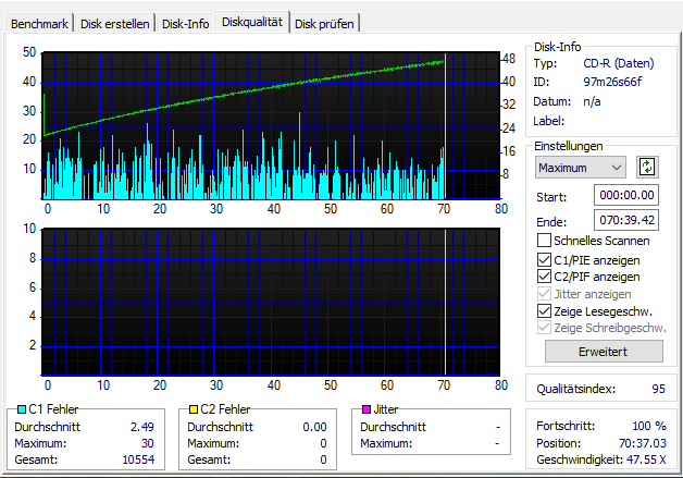

Burning Tevion at Max Speed with Alcohol 120% with PS1 Preset:

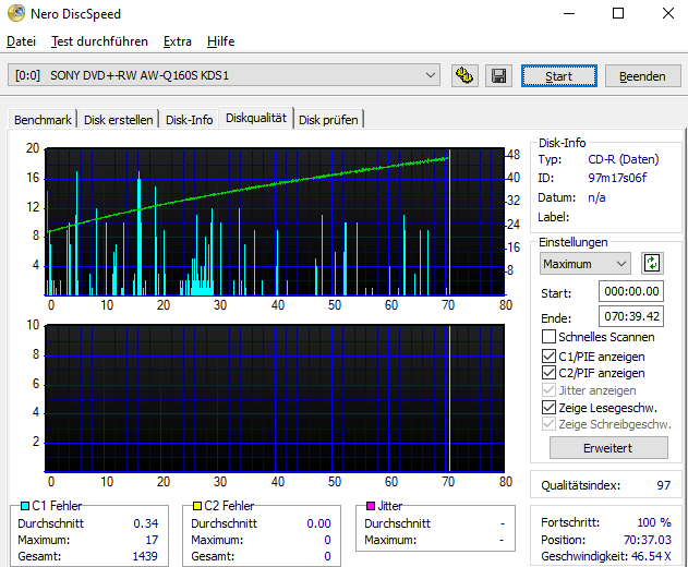

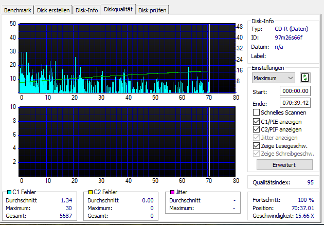

Same TSST burning Sony CD-R at 16x Speed with Alcohol with PS1 Preset:
I burned another Tevion at 16x which produced similar higher C1 Error Rate similar to Sony
Now despite the relatively low C1 Error Rate they all have skipping Audio in THPS2 on the PS2, so it doesnt say much.
Also it seems that some programs may produce better outputs than others, but I need to test this further. Burning with a Sony AW-Q160S drive with this Sony CD-R produced less skipping Audio with Cdrdao than with Alcohol.

So with all of the drives and CD-Rs skipping, the C1 Error Rate doesnt seem to be a good indicator for a working PS game with regular CD-Rs.
So I need to test better CD-Rs with all the drives for better assessment.
