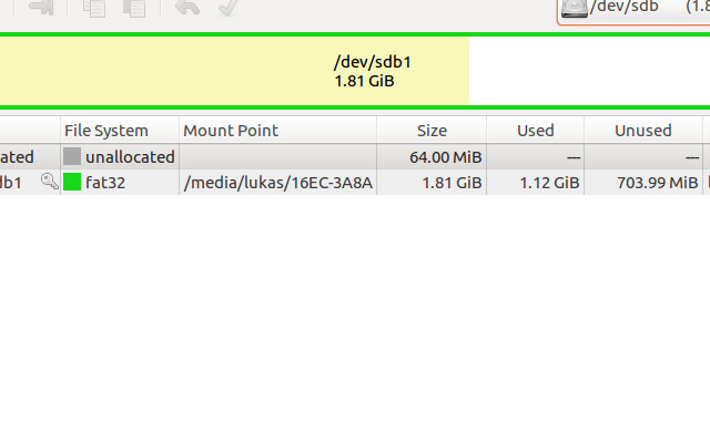

I used a 32GB Micro SD as i read that it should be either 8, 32 GB depending on the Wii U model, mine is a 32GB Model so I thought it should fit well and I had it laying around :)
No, that is only if you want to clone the original. Since you rebuild it anyway, you can use 64gb with no problems. You can go even bigger with the unlimit plugin.
Seems like it doesn't like your SD, which is strange since it works in minute
Can you post the whole log?
Ah ok, thanks for the hint, thats great news, so i will use a larger Micro SD-Card then :)

How did you partition and format it?
After you flashed the boot1 to slccmpt, you can use any SD size for defuse and don't need the boot1 on the SD anymore.
Once you did that clean the SD and repartition it and format it to FAT32.
It sees the SD is there, but it can't read the file system.
I formated the SD-Card as fat32, then I used "dd" to flash the "boot1.img" to the Card, afterwards I used "gparted" to resize the partition to use the whole 2GB of the Card.
Then I copied the /wiiu folder, the fw.img and the otp.bin file over and added the /wafel_install folder with the MLC and SLC files.
In gparted check if the FAT32 partition is flagged with LBA.
Also flashing the boot1 should have destroyed the existing format making you format it again
should it be flagged with LBA?
So after resizing the partition another format to fat32 is needed ?
If it isn't formatted it would not let you resize.
And yes, it should be lba
I will give it another try tomorrow. Thank you for the information so far ^_^

I also tried it with a completely new 2GB SD card with flashing the boot1.img to it and flagging as lba:

I also tried swapping the SD Card to a fat32 formated with ll the files on it, when the message pops up: "
Mount SD attempt 8, FFFCFFE0
00:00:13:803: FSA fsa_core_ops.c(1511): failed to issue command to FS (-196640)" with that it seems to go further:
00:07:08:884: FSA: [uptime 428.884 s]: Attached volume to sdcard01 (fat): Capacity 1876 MB, 3842048 logical blocks of size 5.
00:07:08:888: MCP: FSA volume on device /dev/sdcard01 (fat) attached @ uptime 428.888 s.
Mount SD attempt 94094, 0
00:07:08:892: MCP: Titles scanned (dev_state 0006) on device /dev/sdcard01 (fat) @ uptime 428.892 s.
Mounted SD...
