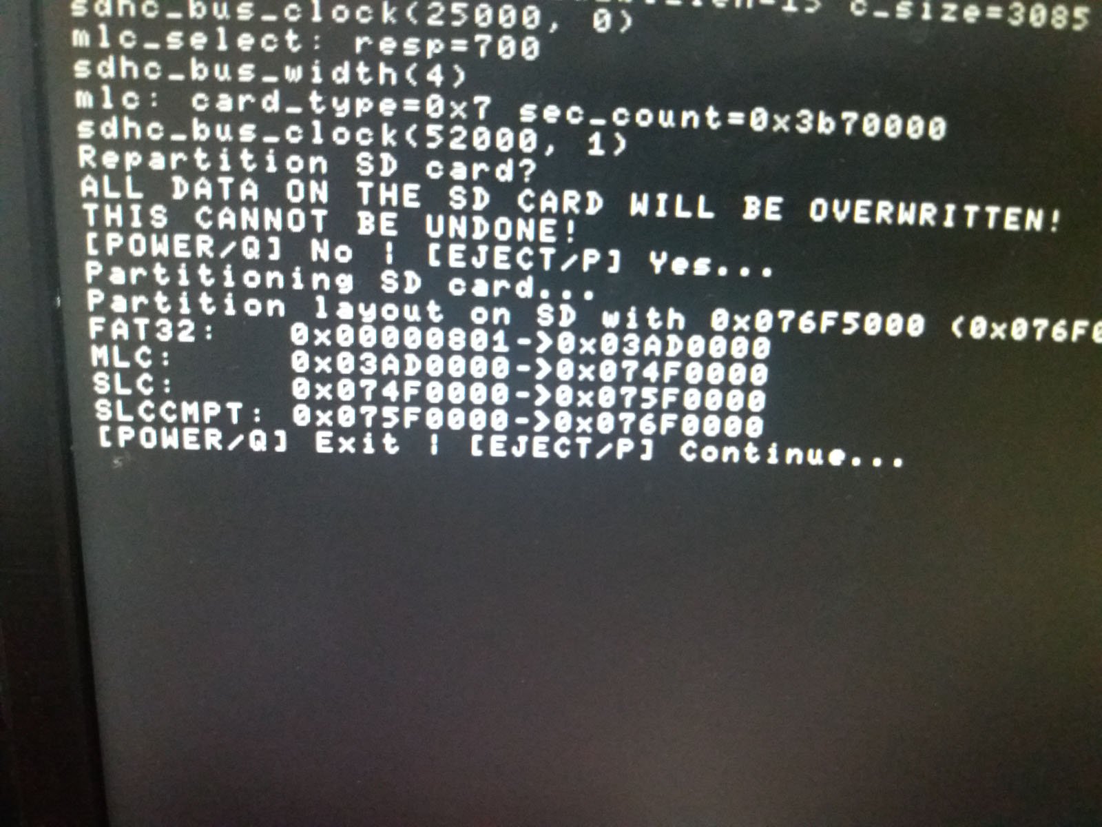

I've installed defuse and used the format rednand option to dump the mlc.
the sd card has now 4 partitions.
How do i backup only the mlc partition? i'm using win7.
EDIT: I did it the hard way. for the mlc partition, multiply the shown sectors with 200 and you will get the start and end offset.
HxD--tools---open disk and select the sd card. copy what's in between the 2 addresses you priviously obtained. you must have a pagefile of at least 32gb. if not, hxd will give an out of memory error. or copy the data in smaller chunks and merge them later. the resulted file should have 31,205,621,760 bytes.

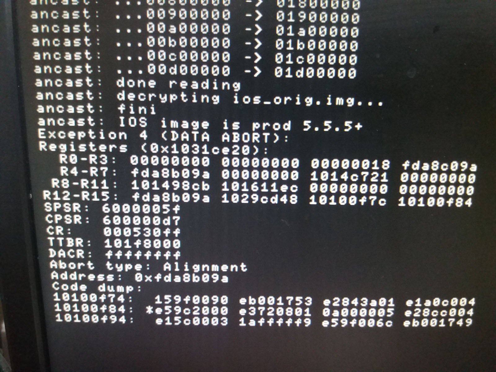

wfs-extract --input mlc.img --output dump_dir --type mlc --otp otp.bin gives me this error:
Error: Failed to read /sys/import/context/update_context
but if i add --verbose at the end, it continues to dump the rest. It is normal to get that error on kiosk mlc? it creates that file, but it is 0 bytes.

On linux you would just use dd. I think there is also a dd version for windows, but finding out the path to the physical device is not very intuitive on windows.
You could write the MLC to a SD card for MLC2SD or nand aid. You just have to make sure you didn't boot the console in between creating the backup and swapping the mlc to the SD.

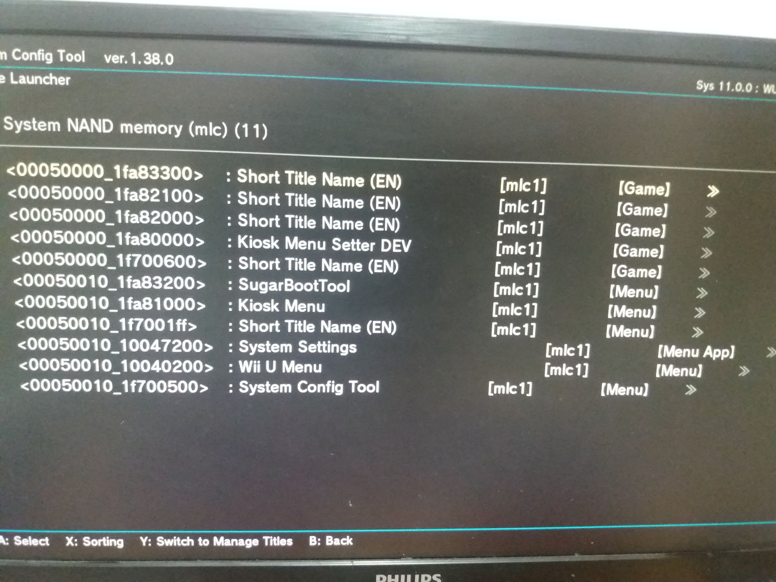

Any tips about installing demos without moding the console? is there a wup installer that could be started from minute?

Oh yes, stroopwafel is made for the retails IOSU. On the kiosk the addresses will likely be different

I decided to use the pc method. I had to do it twice, because the first time i launched SugarBootTool and the console's boot title changed to kiosk again. The rest of the titles don't change system.xml. Used tools: NAND Extractor and slc file injector: https://github.com/GaryOderNichts/wiiuqt
