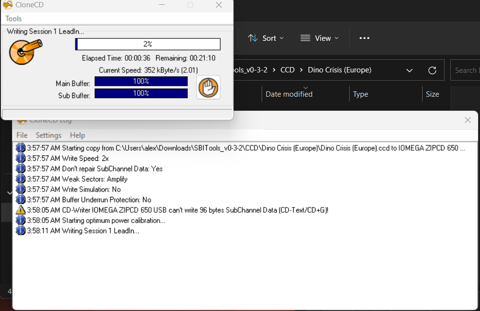

Can the IOMega Zip CD 650 USB from the year 2000 burn a LibCrypt CD-R correctly? Let's find out:

So the drive can not read or write subchannel data. Also I tried ripping the CloneCD burned copy that does work with CDRDAO in BIN/TOC format using a modern burner and this command:
Early CD writers weren't fully standardized as far as I know. They might require specialized commands rather than standard ATAPI.

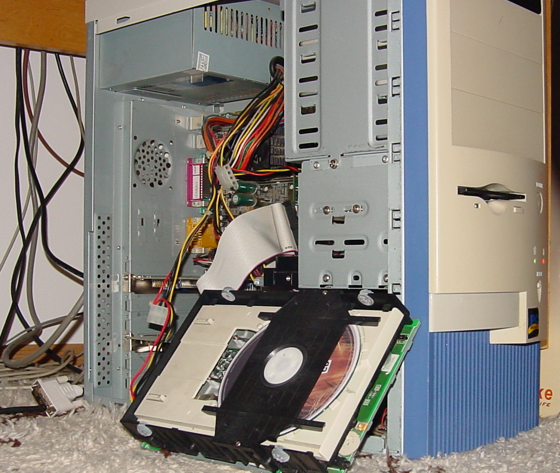

I've got an old (1998) Creative 2x2x24x drive. It reports abilities for RAW-DAO+Sub96, but any attempt to write in this mode fails with Hardware error – Timeout on logical unit.
Unfortunately the drive is damaged as well. Probably due to age. Took me an hour to even get it reading… like this:
Currently trying to write a LibCrypt disc with it in RAW-SAO+Sub-??. Don't get irritated by the brown color and the text on the CD-R. It is an empty CD and just being written. Was a failed attempt to print a label on for a PC game; so the disc went to "garbage test stack". Interesting the camera was able to create an almost still looking picture – the drive was active.
No idea if the result will even be readable. Much of the old hardware is just beyond their time. Frequent power calibration errors until it finally started writing.

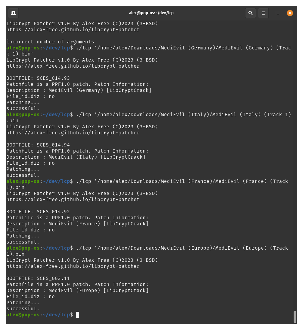

I previously stated I would be adding bypasses for LibCrypt into Tonyhax International, I have played with this and frankly the increase in size needed to store all of the bypasses disgusts me. Tonyhax International is less then 32KBs even as of my unreleased v1.4.2 update adding support for many more games that only trigger on non-stealth mod-chip consoles. I doubt it will ever get over 32KBs from just adding bypasses for non-stealth mod-chip console game to the current code.
Anyways, I’m torn. See without adding bypasses, a real libcrypt PSX disc still would trigger on a Japanese or USA console with a non-stealth mod-chip. But adding those would never be realistic for most Tonyhax International boot methods, besides the boot cd and rom versions that is.
So currently I’m working on something, the ultimate libcrypt patcher. It’s one EXE, one file, you drag your game track 01 bin onto it and it detects the boot file and patches out all the protections in a libcrypt game using a database of existing patches. This is a universal way to burn any libcrypt games with any burner and have them work with and soft-mod and or non-stealth mod-chip console.

200+ LibCrypt discs supported so far, just need to clean up some things.
Also don't think I've linked this here yet :) https://github.com/alex-free/libcrypt-patcher Rest in pieces CloneCD!

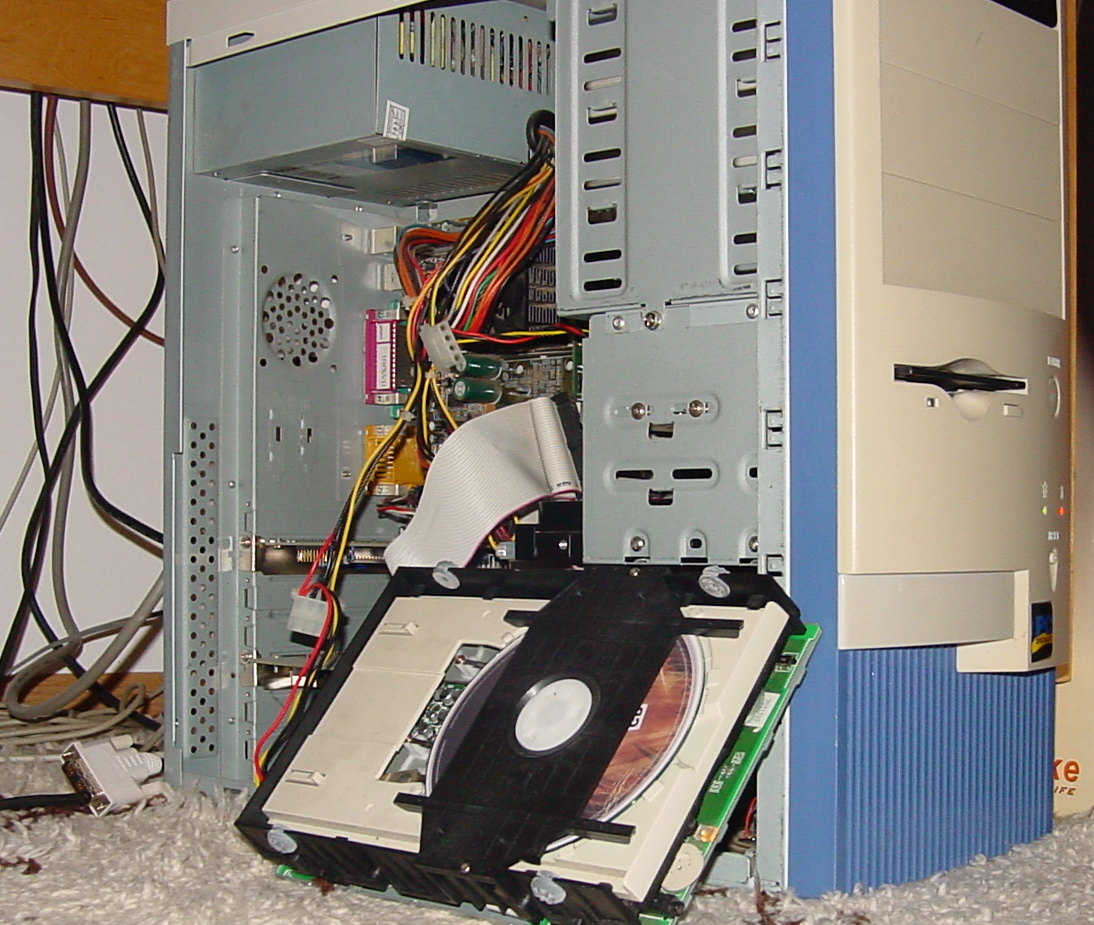

BTW, just bought these "open box" 2x 50pcs(100 discs total) Made in Taiwan DataLifePlus from eBay for US$25. Will see how these discs compare with the regular Verbatim discs that I had been burning.
