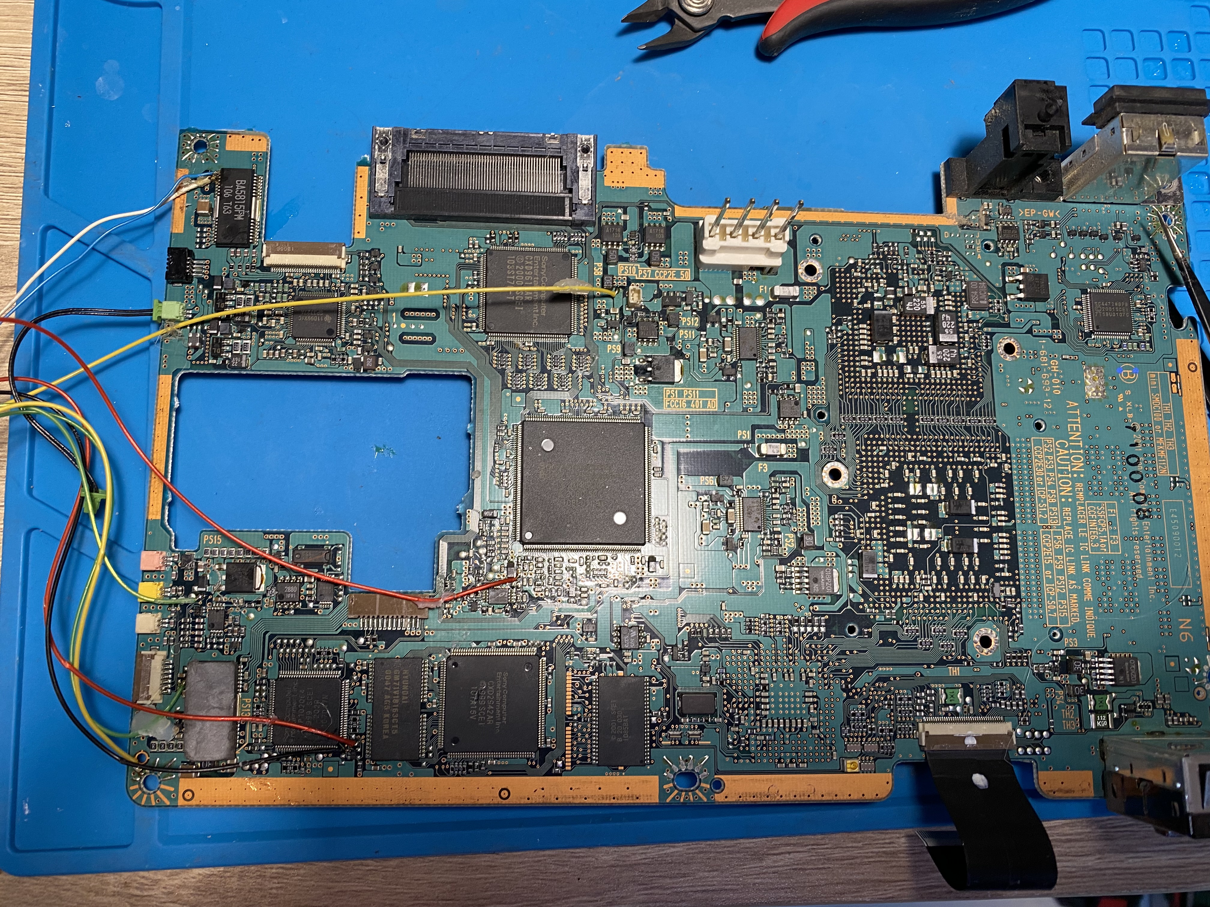

Today i came across this ps2, the person who sent it to me said that „the tray opens and closes by itself” i thought „improper modchip install 100%” i opened it up and it had a little 8 wire pic chip wired up to the board, and one of the ribbon cables was unplugged, along with some colorful plugs (also from the dvd drive). I desoldered the chip and plugged everything back in, now it works at least, but it doesn’t spin up the disc. Sometimes i hear a click but the disc is not spinning. And sometimes i see one turn and then not spinning again. A friend says „dead laser” but i don’t think do, since the disc doesn’t even want to spin up!

  • Could you take a picture of the PIC modchip?
  • Could you provide model of the PS2?
  • Could you provide the serial number of the PS2?
This so we can confirm if it isinstalled correctly and help with the correct firmware matching the console.

Do you have a picture of the modchip in question? PIC chip would mean that its one of the earliest that require a boot disc, such as an Action Replay. Was called the NEO 2?
Here ya go, i desoldered it already tho. And it’s a GH-010 and SCPH-30004

Yep that is NEO 2. I would suggest removing that chip, and replace it with a Modbo 5.
