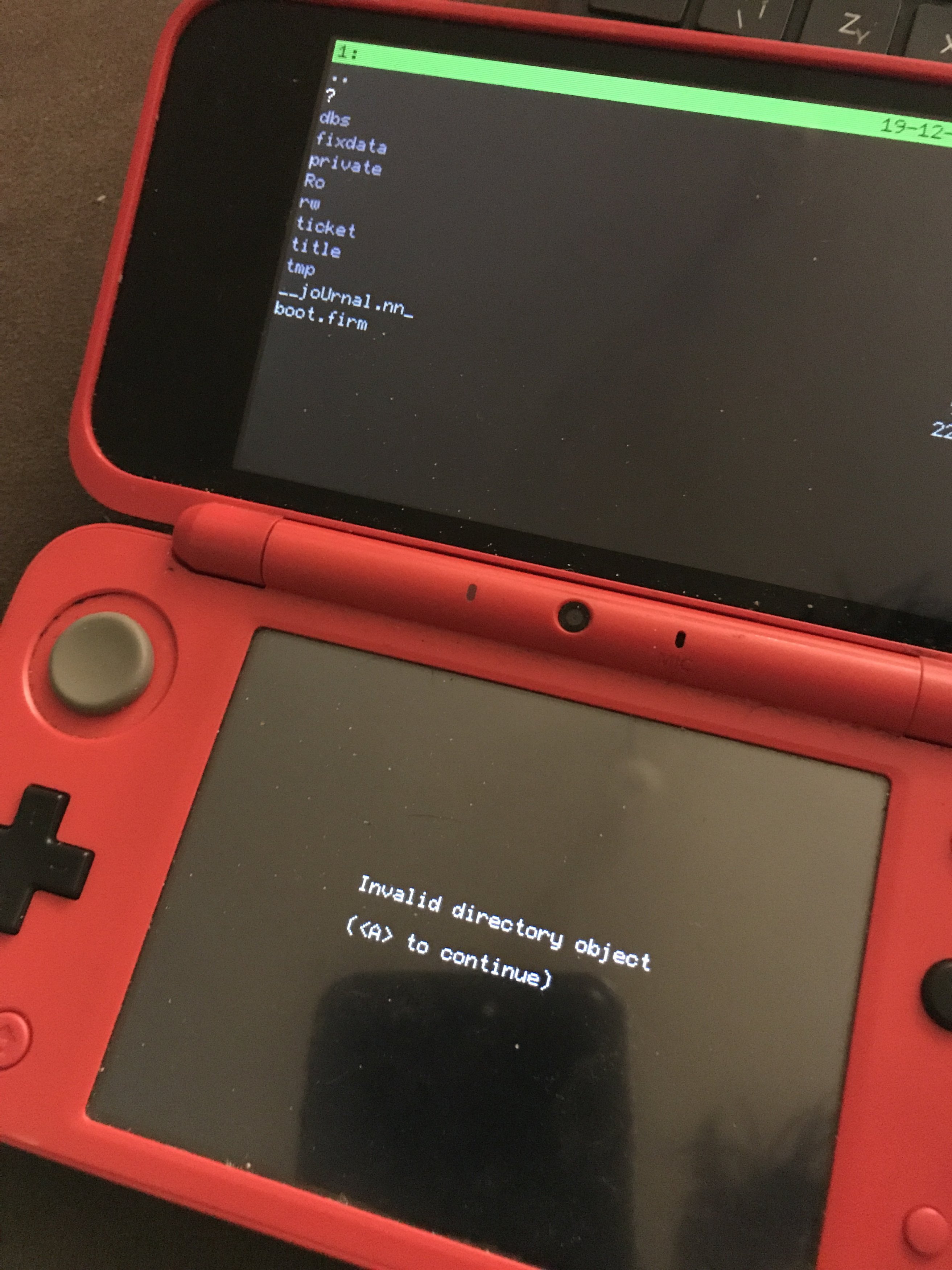

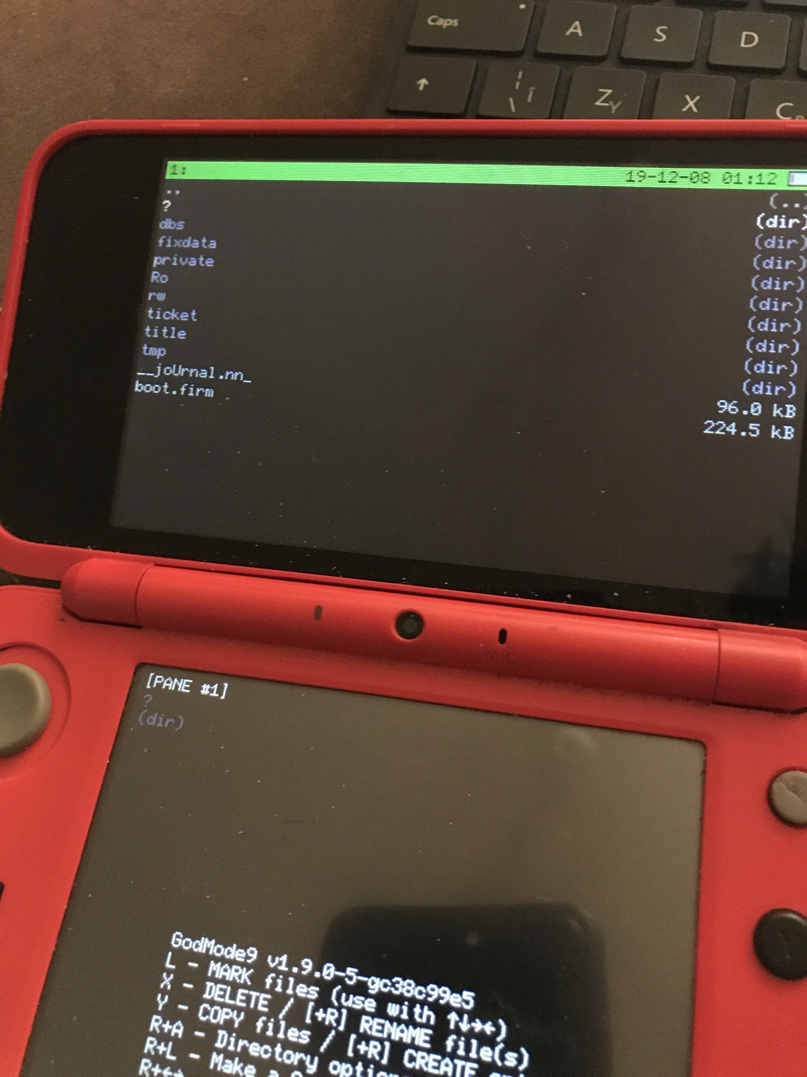

I was doing the process of resolving the coin type brick and when I was trying to rename the data2 folder back to data gm9 crashed and now instead of the data folder there is only a "?" the console boots up fine everything stayed intact other than the data folder yet still crashing. Should I proceed anyway?
Jan 1, 2018
7,291
5,957
NANI ?!
Can you take a picture of the [1:] SYSNAND CTRNAND with the "?" folder?
Reactions: Davekrush
Jan 1, 2018
7,291
5,957
Right away sir!
Hey, so I have some bad news and possible some really, really bad news.
I've seen this type of data corruption before where the folders and files are strangely [mis]spelled in the CTRNAND.
  • ? (This is an illegal character. Try renaming a folder or file with this char on computer or GodMode9. Not allowed.)
  • extdataex4da4a (substituted letters)
Also, while words are not case sensitive,
  • roRo
  • __journal.nn___jOurnal.nn_
  • Example: data | DATA | dAtA | daTA , etc. are technically all equal to each other.
, having their letters changed to capital form without you purposely doing this raises red flags.
This mishap could have been caused (in the first place) by failed system update, manual install of system title CIAs corrupted by a failing or fake SD card, or from repeated CTRTransfer(s) that end up messing with the partition table keeping track of all the items you're supposed to have on the CTRNAND.
Here's a prime example of this seen in this thread, and it is the main reason why CTRTransfer (Type D9) was developed in the first place to fix this sort of softbrick.
