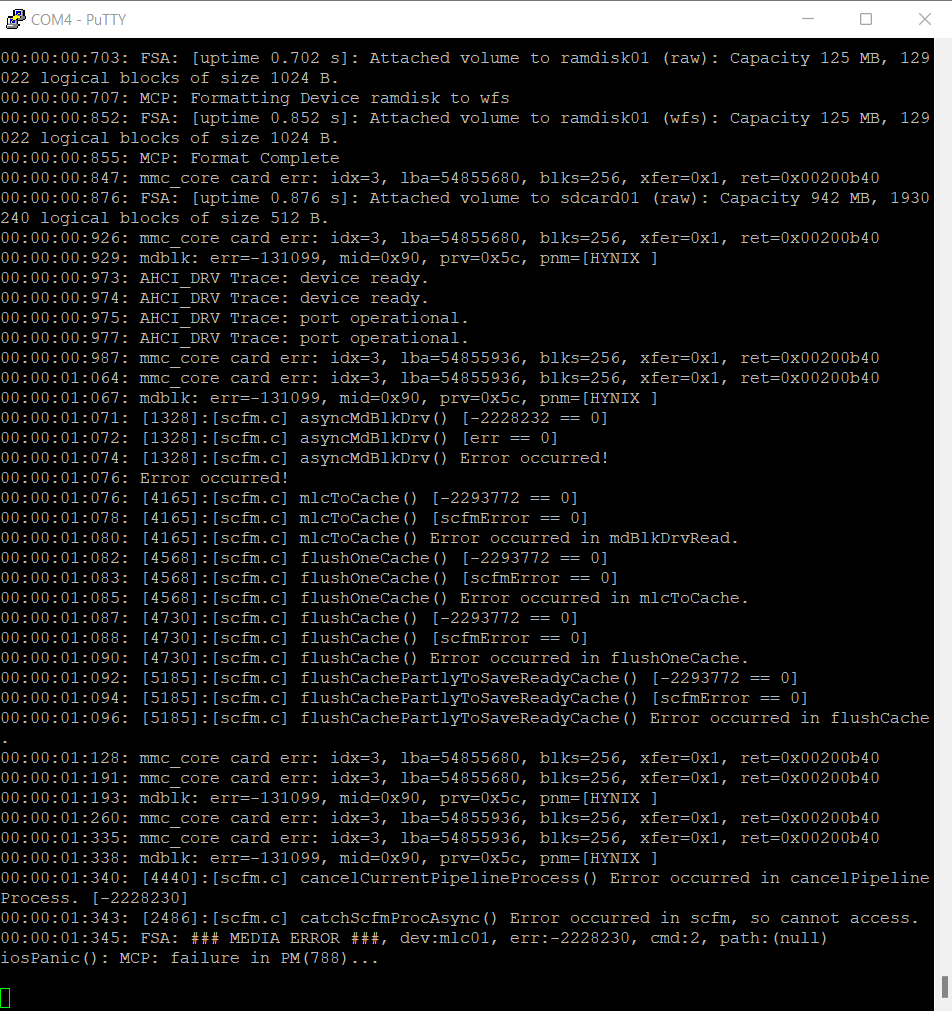

Probably a bad eMMC.
UDPIH will probably not work, because it crashes too early.
You need either to defuse or dump and write back (or better replace with an SD) the eMMC. But for that you need also to solder.
Leaving it on for longer wouldn't have helped. It was dead when it freezed

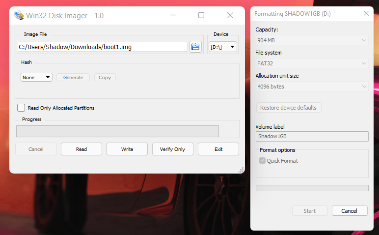

Following these steps, now with the SD files and the raspberry ready, I have to make a
"When defused we can look at the live syslog using miniterm/putty on the PC, then we can see where it crashes / hangs."
Looking at the "syslog" would you know what to do? What would you expect to see in the syslog?
I mean, restore the eMMC that they mention, right?

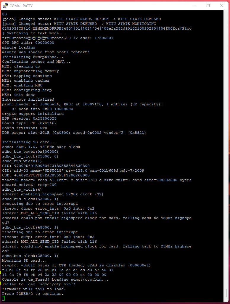

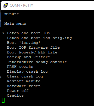

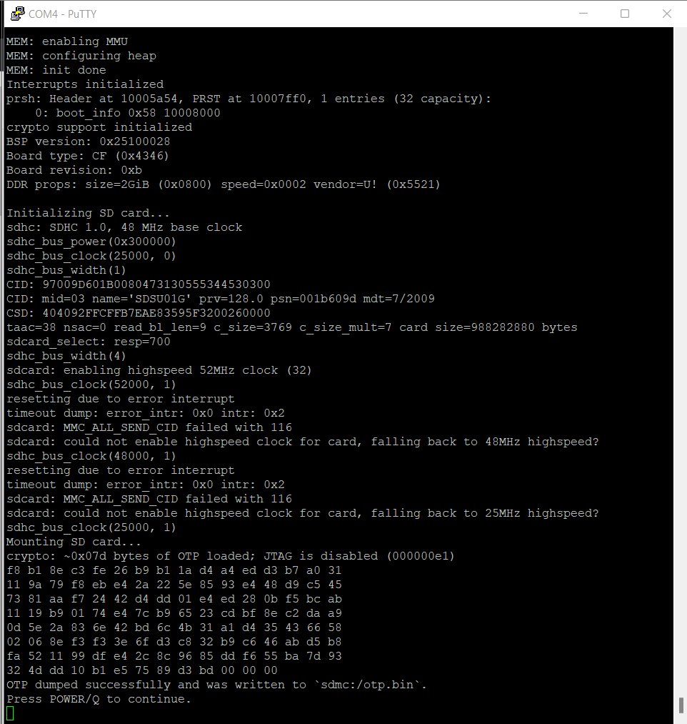

It took me a while because there were interruptions... but that's how it stayed, I'm already preparing the 1GB SD to see what happens...
edit:
neither violet nor orange, only 3 blue flashes and then it turns off or does not respond and stays red...
Any recommendation?
How do you use the PuTTY?

SD card not valid or not inserted, doing a normal boot.
[pico] Changed state: WIIU_STATE_NEEDS_DEFUSE -> WIIU_STATE_DEFUSED
[pico] Changed state: WIIU_STATE_DEFUSED -> WIIU_STATE_MONITORING
Is it normal for me to make so many errors?
I want to think that not...
I just need to check the SD well apparently...
It is a 1GB MicroSd in fat32 with the following files... What is wrong?

Sometimes it shows error C3, what is that?

I already tried these 2 memories in Fat & fat32 formatted with "SDCardFormatterv5_WinEN" with the same result...
Will it be the memory or the format?
I have no more memories...

You need to flash the boot1.img to the sdcard using Win32DiskImager. After that format the Partition to FAT32 using Windows. You can also resize the Partition afterwards to fill the whole SD (only move the end, leave the 64MB free at the start of the card)

I had done it several times, and it didn't work, I repeated it once more after reading your comment and it worked the first time, it seems like black magic JAJAJA
Wow, the violet LED has already appeared, and that whole message has appeared in Putty and in the HDMI image of the WIIU...
press power, it already showed the menu..

Ok Nice, now go to Backup and Restore and then dump the otp via PRSHhax.
After that you can try the Patch and Boot and see what happens.
Shadowthecanine
Apr 10, 2017
32
Hyperbolic Time Chamber
dragon-porungas-team.variousforum.com
128
Backup and Restore and then dump the otp via PRSHhax:
Patch and Boot IOS:

ancast: no patch file `ios.patch`, stubbing...
ancast: reading 0xdfd200 bytes from slc:/sys/title/00050010/1000400a/code/fw.img
ancast: ...00000000 -> 01000000
ancast: ...00100000 -> 01100000
ancast: ...00200000 -> 01200000
ancast: ...00300000 -> 01300000
ancast: ...00400000 -> 01400000
ancast: ...00500000 -> 01500000
ancast: ...00600000 -> 01600000
ancast: ...00700000 -> 01700000
ancast: ...00800000 -> 01800000
ancast: ...00900000 -> 01900000
ancast: ...00a00000 -> 01a00000
ancast: ...00b00000 -> 01b00000
ancast: ...00c00000 -> 01c00000
ancast: ...00d00000 -> 01d00000
ancast: done reading
ancast: decrypting slc:/sys/title/00050010/1000400a/code/fw.img...
ancast: fini
ancast: IOS image is prod 5.5.5+
ancast: pre-parsing plugin `sdmc:/wiiu/ios_plugins/wafel_core.ipx`
ancast: loading plugin `sdmc:/wiiu/ios_plugins/wafel_core.ipx`
GPU clocked at: 544.999877MHz
Unmounting SLC...
Shutting down MLC...
sdhc_bus_power(0x0)
Shutting down SD card...
sdhc_bus_power(0x0)
Shutting down interrupts...
Shutting down caches and MMU...
Vectoring to 0x01000300...
Searching for OTP store in patch...
Searching for OTP store in plugins...
OTP store at: 27e23204
we in here kern 0x27e00fc0, base 0x27e00000

        size    = 0x00100000
        paddr   = 0x08000000
        domain  = 0x0000000f
        attributes: Read/Write, cached
region starting at virtual address 0x08100000:
        size    = 0x00020000
        paddr   = 0x08100000
        domain  = 0x00000000
region starting at virtual address 0x00000000:
        size    = 0x00001000
        paddr   = 0x00000000
        domain  = 0x00000000
        attributes: Kernel-Only, cached
region starting at virtual address 0x00001000:
        size    = 0x01fff000
        paddr   = 0x00001000
        domain  = 0x00000000
region starting at virtual address 0x14000000:
        size    = 0x09000000
        paddr   = 0x14000000
        domain  = 0x00000000
region starting at virtual address 0x27c00000:
        size    = 0x00400000
        paddr   = 0x27c00000
        domain  = 0x00000000
region starting at virtual address 0x28000000:
        size    = 0xa8000000
        paddr   = 0x28000000
        domain  = 0x00000000
IOS_KERNEL: Built 02/04/21 16:05:36, SRAM Utilization 91%, MEM Utilization 90%.
region starting at virtual address 0x05000000:
        size    = 0x0005a000
        paddr   = 0x081c0000
        domain  = 0x00000001
        attributes: Read-Only, cached
region starting at virtual address 0x05060000:
        size    = 0x00010000
        paddr   = 0x08220000
        domain  = 0x00000001
region starting at virtual address 0x05070000:
        size    = 0x00004000
        paddr   = 0x08230000
        domain  = 0x00000001
region starting at virtual address 0x05074000:
        size    = 0x00049000
        paddr   = 0x08234000
        domain  = 0x00000001
region starting at virtual address 0x04000000:
        size    = 0x00018000
        paddr   = 0x08280000
        domain  = 0x00000003
region starting at virtual address 0x04020000:
        size    = 0x00004000
        paddr   = 0x082a0000
        domain  = 0x00000003
region starting at virtual address 0x04024000:
        size    = 0x00001000
        paddr   = 0x082a4000
        domain  = 0x00000003
region starting at virtual address 0x04025000:
        size    = 0x0000a000
        paddr   = 0x082a5000
        domain  = 0x00000003
region starting at virtual address 0xe7000000:
        size    = 0x00001000
        paddr   = 0x082c0000
        domain  = 0x00000002
region starting at virtual address 0x10000000:
        size    = 0x00100000
        paddr   = 0x10000000
        domain  = 0x00000001
region starting at virtual address 0x10100000:
        size    = 0x00032000
        paddr   = 0x10100000
        domain  = 0x00000004
region starting at virtual address 0x10140000:
        size    = 0x00005000
        paddr   = 0x10140000
        domain  = 0x00000004
region starting at virtual address 0x10145000:
        size    = 0x00001000
        paddr   = 0x10145000
        domain  = 0x00000004
region starting at virtual address 0x10146000:
        size    = 0x00380000
        paddr   = 0x10146000
        domain  = 0x00000004
region starting at virtual address 0x10700000:
        size    = 0x000f9000
        paddr   = 0x10700000
        domain  = 0x00000005
region starting at virtual address 0x10800000:
        size    = 0x00034000
        paddr   = 0x10800000
        domain  = 0x00000005
region starting at virtual address 0x10834000:
        size    = 0x00001000
        paddr   = 0x10834000
        domain  = 0x00000005
region starting at virtual address 0x10835000:
        size    = 0x01407000
        paddr   = 0x10835000
        domain  = 0x00000005
region starting at virtual address 0x11f00000:
        size    = 0x00086000
        paddr   = 0x11f00000
        domain  = 0x00000006
region starting at virtual address 0xd1f00000:
        size    = 0x00086000
        paddr   = 0x11f00000
        domain  = 0x00000006
        attributes: Read-Only, un-cached
region starting at virtual address 0x11fc0000:
        size    = 0x00015000
        paddr   = 0x11fc0000
        domain  = 0x00000006
region starting at virtual address 0xd1fc0000:
        size    = 0x00015000
        paddr   = 0x11fc0000
        domain  = 0x00000006
region starting at virtual address 0x11fd5000:
        size    = 0x00024000
        paddr   = 0x11fd5000
        domain  = 0x00000006
region starting at virtual address 0xd1fd5000:
        size    = 0x00024000
        paddr   = 0x11fd5000
        domain  = 0x00000006
        attributes: Read/Write, un-cached
region starting at virtual address 0x11ff9000:
        size    = 0x00160000
        paddr   = 0x11ff9000
        domain  = 0x00000006
region starting at virtual address 0xd1ff9000:
        size    = 0x00160000
        paddr   = 0x11ff9000
        domain  = 0x00000006
region starting at virtual address 0x12300000:
        size    = 0x00132000
        paddr   = 0x12300000
        domain  = 0x00000007
region starting at virtual address 0x12440000:
        size    = 0x00029000
        paddr   = 0x12440000
        domain  = 0x00000007
region starting at virtual address 0x12469000:
        size    = 0x00001000
        paddr   = 0x12469000
        domain  = 0x00000007
region starting at virtual address 0x1246a000:
        size    = 0x0005c000
        paddr   = 0x1246a000
        domain  = 0x00000007
region starting at virtual address 0x124c6000:
        size    = 0x003c8000
        paddr   = 0x124c6000
        domain  = 0x00000007
region starting at virtual address 0xe0000000:
        size    = 0x000dc000
        paddr   = 0x12900000
        domain  = 0x00000008
region starting at virtual address 0xe0100000:
        size    = 0x00021000
        paddr   = 0x12a00000
        domain  = 0x00000008
region starting at virtual address 0xe0121000:
        size    = 0x00001000
        paddr   = 0x12a21000
        domain  = 0x00000008
region starting at virtual address 0xe0122000:
        size    = 0x00001000
        paddr   = 0x12a22000
        domain  = 0x00000008
region starting at virtual address 0xe0123000:
        size    = 0x0013f000
        paddr   = 0x12a23000
        domain  = 0x00000008
region starting at virtual address 0xe1000000:
        size    = 0x00091000
        paddr   = 0x12bc0000
        domain  = 0x00000009
region starting at virtual address 0xe10c0000:
        size    = 0x00022000
        paddr   = 0x12c80000
        domain  = 0x00000009
region starting at virtual address 0xe10e2000:
        size    = 0x00002000
        paddr   = 0x12ca2000
        domain  = 0x00000009
region starting at virtual address 0xe10e4000:
        size    = 0x00205000
        paddr   = 0x12ca4000
        domain  = 0x00000009
region starting at virtual address 0xe2000000:
        size    = 0x00266000
        paddr   = 0x12ec0000
        domain  = 0x0000000b
region starting at virtual address 0xe2280000:
        size    = 0x00049000
        paddr   = 0x13140000
        domain  = 0x0000000b
region starting at virtual address 0xe22c9000:
        size    = 0x00001000
        paddr   = 0x13189000
        domain  = 0x0000000b
region starting at virtual address 0xe22ca000:
        size    = 0x00001000
        paddr   = 0x1318a000
        domain  = 0x0000000b
region starting at virtual address 0xe22cb000:
        size    = 0x003fe000
        paddr   = 0x1318b000
        domain  = 0x0000000b
region starting at virtual address 0xe3000000:
        size    = 0x0016c000
        paddr   = 0x13640000
        domain  = 0x0000000c
region starting at virtual address 0xe3180000:
        size    = 0x0002d000
        paddr   = 0x137c0000
        domain  = 0x0000000c
region starting at virtual address 0xe31ad000:
        size    = 0x00001000
        paddr   = 0x137ed000
        domain  = 0x0000000c
region starting at virtual address 0xe31ae000:
        size    = 0x00001000
        paddr   = 0x137ee000
        domain  = 0x0000000c
region starting at virtual address 0xe31af000:
        size    = 0x0014e000
        paddr   = 0x137ef000
        domain  = 0x0000000c
region starting at virtual address 0xe4000000:
        size    = 0x0001a000
        paddr   = 0x13a40000
        domain  = 0x0000000d
region starting at virtual address 0xe4040000:
        size    = 0x00006000
        paddr   = 0x13a80000
        domain  = 0x0000000d
region starting at virtual address 0xe4046000:
        size    = 0x00001000
        paddr   = 0x13a86000
        domain  = 0x0000000d
region starting at virtual address 0xe4047000:
        size    = 0x00112000
        paddr   = 0x13a87000
        domain  = 0x0000000d
region starting at virtual address 0xe5000000:
        size    = 0x00010000
        paddr   = 0x13c00000
        domain  = 0x0000000a
region starting at virtual address 0xe5040000:
        size    = 0x00004000
        paddr   = 0x13c40000
        domain  = 0x0000000a
region starting at virtual address 0xe5044000:
        size    = 0x00001000
        paddr   = 0x13c44000
        domain  = 0x0000000a
region starting at virtual address 0xe5045000:
        size    = 0x0002a000
        paddr   = 0x13c45000
        domain  = 0x0000000a
region starting at virtual address 0xe6000000:
        size    = 0x00011000
        paddr   = 0x13cc0000
        domain  = 0x00000002
region starting at virtual address 0xe6040000:
        size    = 0x00002000
        paddr   = 0x13d00000
        domain  = 0x00000002
region starting at virtual address 0xe6042000:
        size    = 0x00005000
        paddr   = 0x13d02000
        domain  = 0x00000002
region starting at virtual address 0xe6047000:
        size    = 0x00002000
        paddr   = 0x13d07000
        domain  = 0x00000002
region starting at virtual address 0x05100000:
        size    = 0x00016000
        paddr   = 0x13d80000
        domain  = 0x00000001
region starting at virtual address 0x1fb00000:
        size    = 0x00300000
        paddr   = 0x1fb00000
        domain  = 0x00000007
region starting at virtual address 0x1fe00000:
        size    = 0x00015000
        paddr   = 0x1fe00000
        domain  = 0x00000001
region starting at virtual address 0x1fe40000:
        size    = 0x001c0000
        paddr   = 0x1fe40000
        domain  = 0x00000001
region starting at virtual address 0x20000000:
        size    = 0x07e00000
        paddr   = 0x20000000
        domain  = 0x00000005
region starting at virtual address 0x05200000:
        size    = 0x00100000
        paddr   = 0x27e00000
        domain  = 0x00000001
region starting at virtual address 0x10600000:
        size    = 0x00100000
        paddr   = 0x27e00000
        domain  = 0x00000001
region starting at virtual address 0xeff00000:
        size    = 0x00008000
        paddr   = 0xfff00000
        domain  = 0x00000001
Creating main() thread for IOS-BSP:
        priority=125    stackSize=4096  stackPtr=0xe7000000     entry=0xe600f848        memPermMask=0x00100000
IOS-BSP: Built 02/04/21 16:02:14, Image Utilization 37%.
Creating main() thread for IOS-MCP:
        priority=124    stackSize=8192  stackPtr=0x050ba4a0     entry=0x05056718        memPermMask=0x000c0030
Creating main() thread for IOS-CRYPTO:
        priority=123    stackSize=4096  stackPtr=0x04028628     entry=0x04015ea4        memPermMask=0x000c0030
Creating main() thread for IOS-USB:
        priority=107    stackSize=16384 stackPtr=0x104b92c8     entry=0x1012e9e8        memPermMask=0x00038600
Creating main() thread for IOS-FS:
        priority=85     stackSize=16384 stackPtr=0x1114117c     entry=0x107f6830        memPermMask=0x001c5870
Creating main() thread for IOS-PAD:
        priority=117    stackSize=8192  stackPtr=0x1214ab4c     entry=0x11f82d94        memPermMask=0x00008180
Creating main() thread for IOS-NET:
        priority=80     stackSize=16384 stackPtr=0x12804498     entry=0x123e4174        memPermMask=0x00002000
Creating main() thread for IOS-ACP:
        priority=50     stackSize=16384 stackPtr=0xe0125390     entry=0xe00d8290        memPermMask=0x00000000
Creating main() thread for IOS-NSEC:

00:00:00:847: mmc_core card err: idx=3, lba=54855680, blks=256, xfer=0x1, ret=0x00200b40
00:00:00:876: FSA: [uptime 0.876 s]: Attached volume to sdcard01 (raw): Capacity 942 MB, 1930240 logical blocks of size 512 B.
00:00:00:926: mmc_core card err: idx=3, lba=54855680, blks=256, xfer=0x1, ret=0x00200b40
00:00:00:929: mdblk: err=-131099, mid=0x90, prv=0x5c, pnm=[HYNIX ]
00:00:00:973: AHCI_DRV Trace: device ready.
00:00:00:974: AHCI_DRV Trace: device ready.
00:00:00:975: AHCI_DRV Trace: port operational.
00:00:00:977: AHCI_DRV Trace: port operational.
00:00:00:987: mmc_core card err: idx=3, lba=54855936, blks=256, xfer=0x1, ret=0x00200b40
00:00:01:064: mmc_core card err: idx=3, lba=54855936, blks=256, xfer=0x1, ret=0x00200b40
00:00:01:067: mdblk: err=-131099, mid=0x90, prv=0x5c, pnm=[HYNIX ]
00:00:01:071: [1328]:[scfm.c] asyncMdBlkDrv() [-2228232 == 0]
00:00:01:072: [1328]:[scfm.c] asyncMdBlkDrv() [err == 0]
00:00:01:074: [1328]:[scfm.c] asyncMdBlkDrv() Error occurred!
00:00:01:076: Error occurred!
00:00:01:076: [4165]:[scfm.c] mlcToCache() [-2293772 == 0]
00:00:01:078: [4165]:[scfm.c] mlcToCache() [scfmError == 0]
00:00:01:080: [4165]:[scfm.c] mlcToCache() Error occurred in mdBlkDrvRead.
00:00:01:082: [4568]:[scfm.c] flushOneCache() [-2293772 == 0]
00:00:01:083: [4568]:[scfm.c] flushOneCache() [scfmError == 0]
00:00:01:085: [4568]:[scfm.c] flushOneCache() Error occurred in mlcToCache.
00:00:01:087: [4730]:[scfm.c] flushCache() [-2293772 == 0]
00:00:01:088: [4730]:[scfm.c] flushCache() [scfmError == 0]
00:00:01:090: [4730]:[scfm.c] flushCache() Error occurred in flushOneCache.
00:00:01:092: [5185]:[scfm.c] flushCachePartlyToSaveReadyCache() [-2293772 == 0]
00:00:01:094: [5185]:[scfm.c] flushCachePartlyToSaveReadyCache() [scfmError == 0]
00:00:01:096: [5185]:[scfm.c] flushCachePartlyToSaveReadyCache() Error occurred in flushCache.
00:00:01:128: mmc_core card err: idx=3, lba=54855680, blks=256, xfer=0x1, ret=0x00200b40
00:00:01:191: mmc_core card err: idx=3, lba=54855680, blks=256, xfer=0x1, ret=0x00200b40
00:00:01:193: mdblk: err=-131099, mid=0x90, prv=0x5c, pnm=[HYNIX ]
00:00:01:260: mmc_core card err: idx=3, lba=54855936, blks=256, xfer=0x1, ret=0x00200b40
00:00:01:335: mmc_core card err: idx=3, lba=54855936, blks=256, xfer=0x1, ret=0x00200b40
00:00:01:338: mdblk: err=-131099, mid=0x90, prv=0x5c, pnm=[HYNIX ]
00:00:01:340: [4440]:[scfm.c] cancelCurrentPipelineProcess() Error occurred in cancelPipelineProcess. [-2228230]
00:00:01:343: [2486]:[scfm.c] catchScfmProcAsync() Error occurred in scfm, so cannot access.
00:00:01:345: FSA: ### MEDIA ERROR ###, dev:mlc01, err:-2228230, cmd:2, path:(null)
iosPanic(): MCP: failure in PM(788)...
I think something went wrong...
I want to think it's an eMMC error or something like that.
SDIO
Feb 13, 2023
2,263
28
1,382
Germany
As expected SCFM crashes directly after Init because of bad eMMC when it tries to flush.
Even with the right LAN adapter you could have waited till the end of the universe and it wouldn't have helped.
And waiting longer on the update also wouldn't have helped. The update froze because it bricked.
So the eMMC needs to be replaced and then you can just rebuild the mlc.
I don't think you wanted to backup saves, but if you want to now would be the moment for it.
