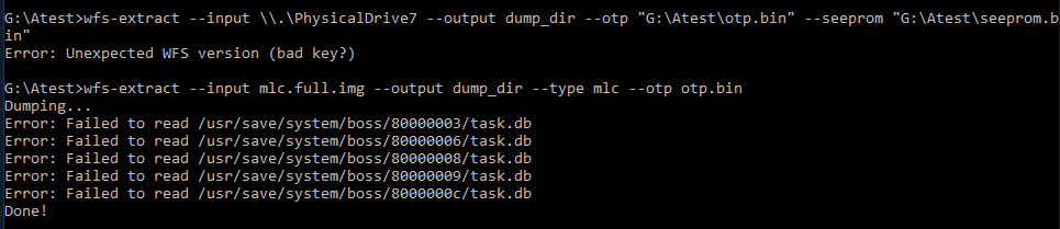

after doing the dump, on my computer wfs-extract wouldn't recognise the dump and i would constantly get "Unexpected WFS version (bad key?)" even with two different sd card readers as i know the sd card is good as i've used it for switch emu in the past
after spending a hours of troubleshooting and trying anything i came up with the idea of manually copying the parition and turning it into a .img via hex editing all i would need to find is the first boot sector physical of the mlc dump and the end one
which is what i did with MiniTool Parition Wizard then opened up HxD and i copied from the first boot sector and end and made a new file with all the stuff in it renamed it from "File" to "mlc.full.img" then used wfs-extract "wfs-extract --input mlc.full.img --output dump_dir --type mlc --otp otp.bin"
and we got the mlc open
and we got the mlc open View attachment 431586
don't take advice from me but i think those "task.db" files are just spotpass data
They were probably written last and still in the scfm. Also they are as already said just spot pass cache so not important.
But that would also mean the eMMC is probably fine.
