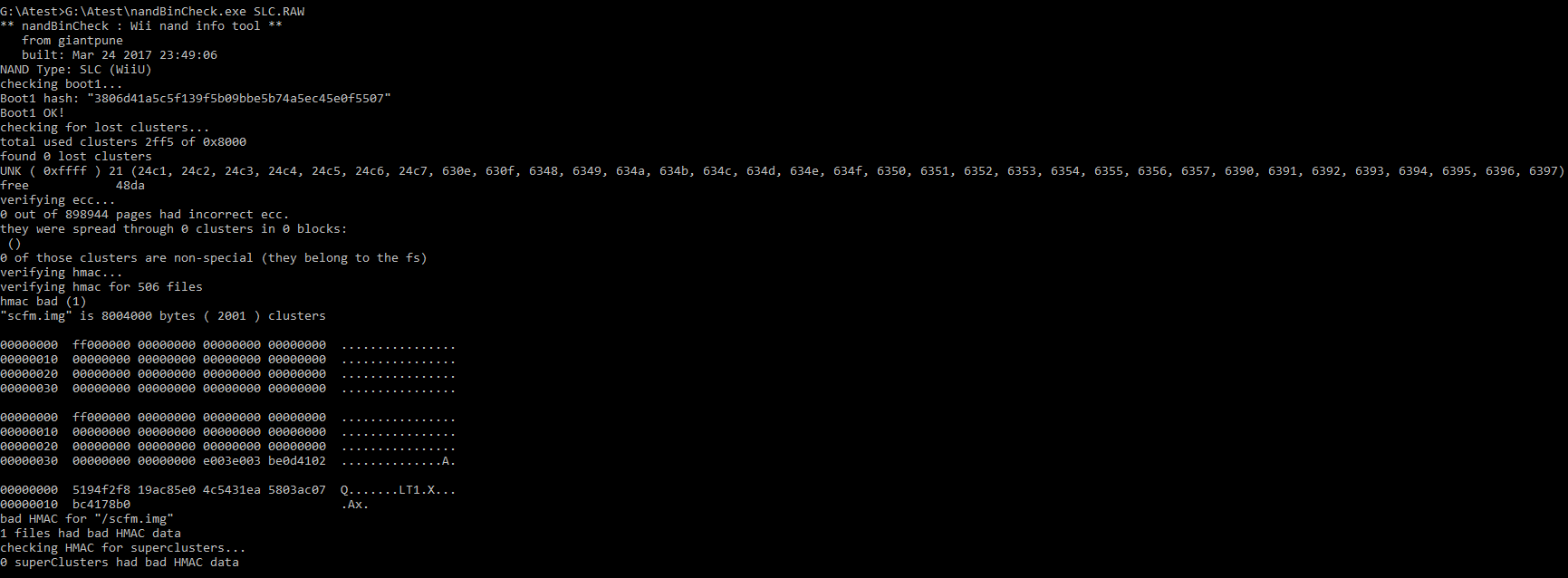

Check the slc dump with nandBinCheck (wrong HMAC on scfm.img is fine) https://github.com/koolkdev/wiiuqt/releases
If there are no other error s on the SLC, you might just try to rebuild the MLC. There is no indication that this is the problem, but I don't have a better idea atm than just reinstalling everything
All seems to be fine, just one bad HMAC as you said that is fine

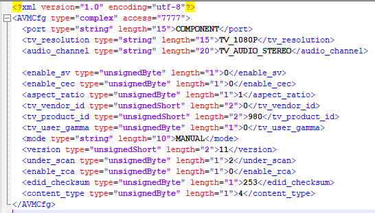

You could extract the /sys/proc/prefs/AVMCfg.xml from the SLC. That would tell us to which video output it is set too.

Yeah thats what the power off test was for. If it still can turn off, it is likely just the video output
its in component which i'm not surpised by as i used a capture card with component, i don't have anything directly on me that can use component would i need to change this or should it be fine?
yeah the Wii U won't output on HDMI if it is set to component. You could use https://github.com/GaryOderNichts/wiiuqt/tree/master/fileInjector to change the file and inject it into your dump and flash it back.
Or you could try to sync the tablet in the recovery.
