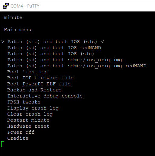

Rename the boot1.img to boot1_slccmpt.img and copy it on your current defuse SD.
I made this change and I notice changes in the menu...
Then go to backup and restore in minute and flash the boot_slccmpt.img to slccmpt.
is "Dump BOOT1_SLCCMPT.RAW" or "restore BOOT1_SLCCMPT.RAW" or "restore BOOT1_SLCCMPT.IMG"?

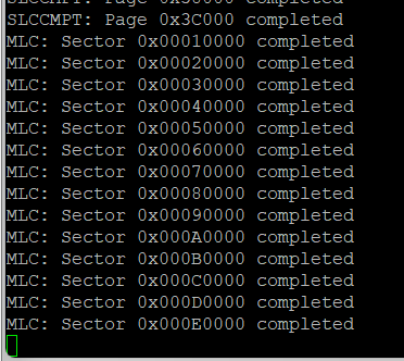

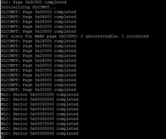

waiting for the process to finish...

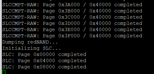

It is in process, since I told him about the "format redNAND"
 Backup and Restore
  Dump SEEPROM & OTP
  Dump Espresso OTP & bootrom
  Dump OTP via PRSHhax
  Dump SLC.RAW
  Dump SLCCMPT.RAW
  Dump BOOT1_SLC.RAW
  Dump factory log
  Dump sys crash logs
  Dump sys crash logs from redslc
> Format redNAND <
  Restore SLC.RAW
  Restore SLCCMPT.RAW
  Restore BOOT1_SLC.RAW
  Restore BOOT1_SLCCMPT.RAW
  Restore BOOT1_SLC.IMG
  Restore BOOT1_SLCCMPT.IMG
  Restore seeprom.bin
  Erase MLC
  Delete scfm.img
  Delete SLCCMPT scfm.img
  Delete redNAND scfm.img
  Restore redNAND MLC
  Sync SEEPROM boot1 versions with NAND
  Set SEEPROM SATA device type
  Test SLC and Restore SLC.RAW
  Return to Main Menu

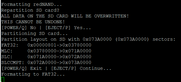

Formatting redNAND...
Repartition SD card?
ALL DATA ON THE SD CARD WILL BE OVERWRITTEN!
THIS CANNOT BE UNDONE!
[POWER/Q] No | [EJECT/P] Yes...
Partitioning SD card...
Partition layout on SD with 0x073A0000 (0x073A0000) sectors:
FAT32:   0x00000801->0x03780000
MLC:     0x03780000->0x071A0000
SLC:     0x071A0000->0x072A0000
SLCCMPT: 0x072A0000->0x073A0000
[POWER/Q] Exit | [EJECT/P] Continue...

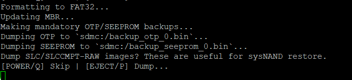

Formatting to FAT32...
Updating MBR...
Making mandatory OTP/SEEPROM backups...
Dumping OTP to `sdmc:/backup_otp_0.bin`...
Dumping SEEPROM to `sdmc:/backup_seeprom_0.bin`...

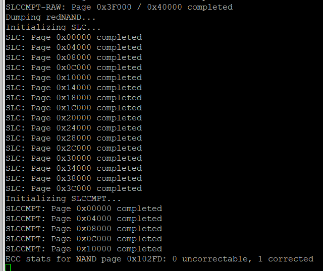

Dump SLC/SLCCMPT-RAW images? These are useful for sysNAND restore.
[POWER/Q] Skip | [EJECT/P] Dump...
Dumping SLC-RAW to FAT32...
Initializing SLC...
SLC-RAW: Page 0x00000 / 0x40000 completed

Dumping SLCCMPT-RAW to FAT32...
Initializing SLCCMPT...
SLCCMPT-RAW: Page 0x00000 / 0x40000 completed
SLCCMPT-RAW: Page 0x01000 / 0x40000 completed
SLCCMPT-RAW: Page 0x02000 / 0x40000 completed
SLCCMPT-RAW: Page 0x03000 / 0x40000 completed
SLCCMPT-RAW: Page 0x04000 / 0x40000 completed
SLCCMPT-RAW: Page 0x05000 / 0x40000 completed
SLCCMPT-RAW: Page 0x06000 / 0x40000 completed
SLCCMPT-RAW: Page 0x07000 / 0x40000 completed
SLCCMPT-RAW: Page 0x08000 / 0x40000 completed
SLCCMPT-RAW: Page 0x09000 / 0x40000 completed
SLCCMPT-RAW: Page 0x0A000 / 0x40000 completed
SLCCMPT-RAW: Page 0x0B000 / 0x40000 completed
SLCCMPT-RAW: Page 0x0C000 / 0x40000 completed
SLCCMPT-RAW: Page 0x0D000 / 0x40000 completed
SLCCMPT-RAW: Page 0x0E000 / 0x40000 completed
SLCCMPT-RAW: Page 0x0F000 / 0x40000 completed
SLCCMPT-RAW: Page 0x10000 / 0x40000 completed
ECC stats for NAND page 0x102FD: 0 uncorrectable, 1 corrected
SLCCMPT-RAW: Page 0x11000 / 0x40000 completed

SLCCMPT-RAW: Page 0x37000 / 0x40000 completed
SLCCMPT-RAW: Page 0x38000 / 0x40000 completed
SLCCMPT-RAW: Page 0x39000 / 0x40000 completed
SLCCMPT-RAW: Page 0x3A000 / 0x40000 completed
SLCCMPT-RAW: Page 0x3B000 / 0x40000 completed
SLCCMPT-RAW: Page 0x3C000 / 0x40000 completed
SLCCMPT-RAW: Page 0x3D000 / 0x40000 completed
SLCCMPT-RAW: Page 0x3E000 / 0x40000 completed
SLCCMPT-RAW: Page 0x3F000 / 0x40000 completed
Dumping redNAND...
Initializing SLC...
SLC: Page 0x00000 completed
SLC: Page 0x04000 completed
SLC: Page 0x08000 completed
SLC: Page 0x0C000 completed
SLC: Page 0x10000 completed
SLC: Page 0x14000 completed
SLC: Page 0x18000 completed
SLC: Page 0x1C000 completed
SLC: Page 0x20000 completed
SLC: Page 0x24000 completed
SLC: Page 0x28000 completed
SLC: Page 0x2C000 completed
SDIO
Feb 13, 2023
2,264
28
1,382
Germany
that seems really slow. One SLC shouldn't take more then 5 minutes I think.
Maybe the SD card isn't detected properly and running at a lower clock
Shadowthecanine
Apr 10, 2017
32
Hyperbolic Time Chamber
dragon-porungas-team.variousforum.com
128
Should it be over already? I see that it is progressing somewhat slowly...
And how can I know if the SD is bad?

yes the SLCs should be done long by now. After that comes the MLC which will take much longer. So I would say restart and try again and maybe reseat the card or use another adapter if you use one
Shadowthecanine
Apr 10, 2017
32
128
then I turn off the console, change the adapter, which is a MicroSd to SD...(I am using a 64GB MicroSD) to repeat this "RedNAND format" step?
SDIO
Feb 13, 2023
2,264
28
1,382
Germany
The MLC has 0x3A20000 sectors (mot this is in hex not decimal). Just so you get a feeling how long it will take. At the proper speed it should take 30-60min
Shadowthecanine
Apr 10, 2017
32
128
holy cow, that's going to take years jajajaja
I'll change the adapter then we'll see what it does...
I don't see the difference, it's very slow....
5min...
