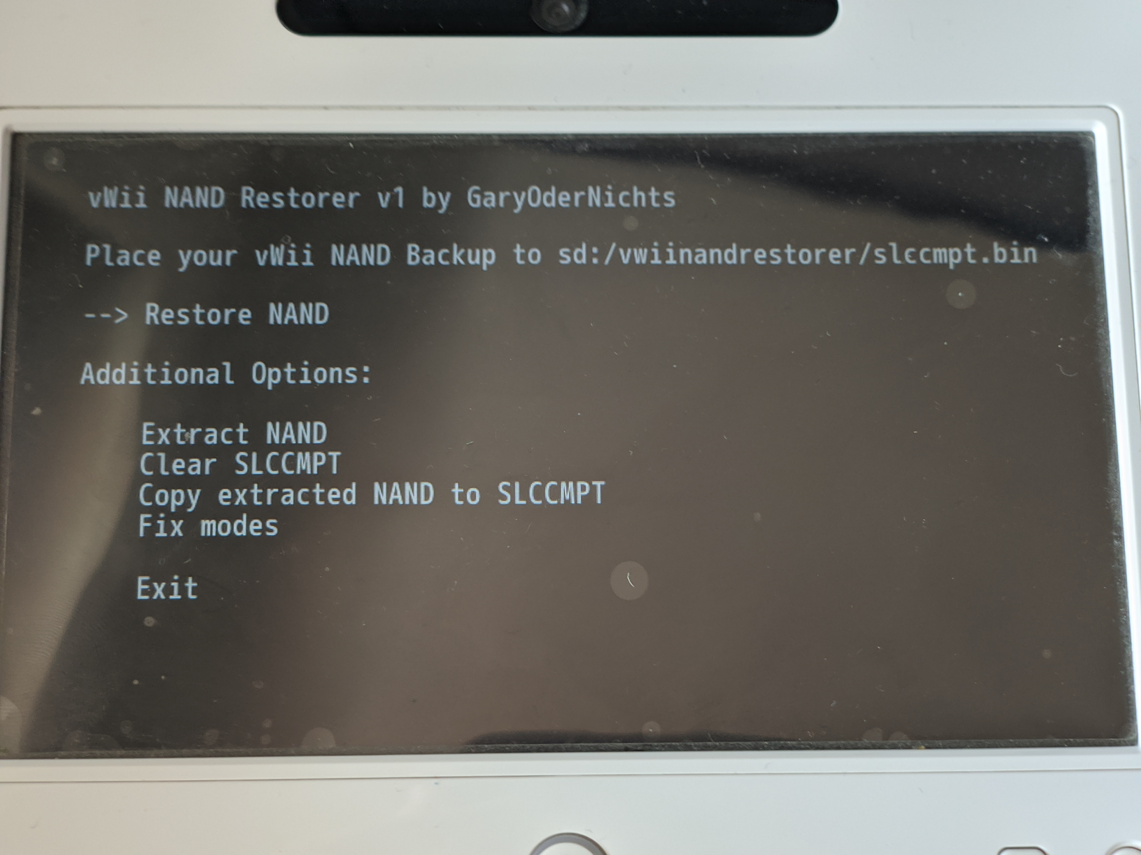

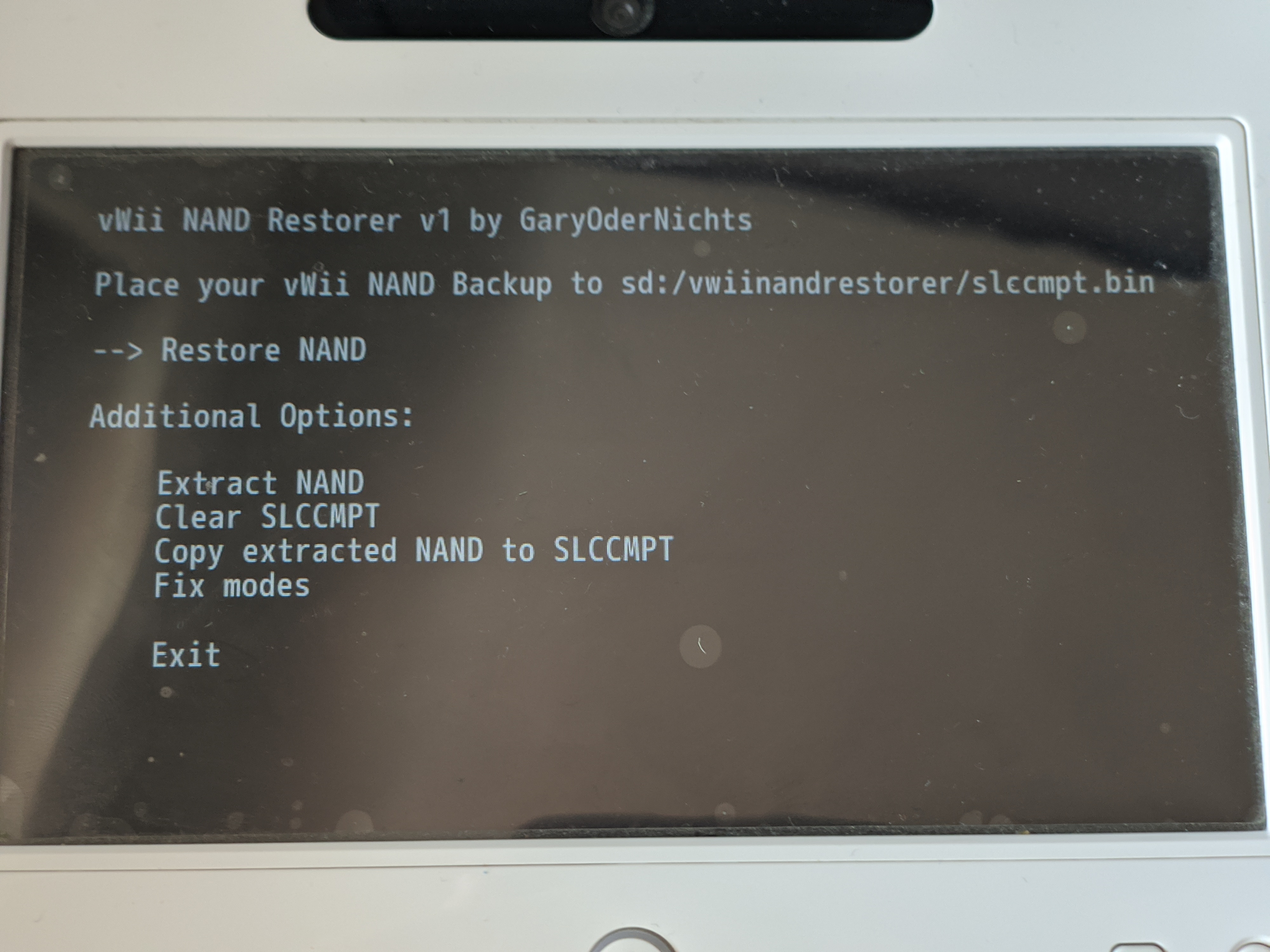

So for Wii U on my SD card I have keys.bin and nand.bin but nothing else. I'm not sure where I'm supposed to get the backup from and the elf file to transfer them. I certainly don't have slccmpt.bin
No Problem,just rename that.:)
Copy your nand backup to sd:/vwiinandrestorer/slccmpt.bin and place your keys.bin/otp.bin in the same folder
Note: If your backup is named nand.bin just rename it to slccmpt.bin

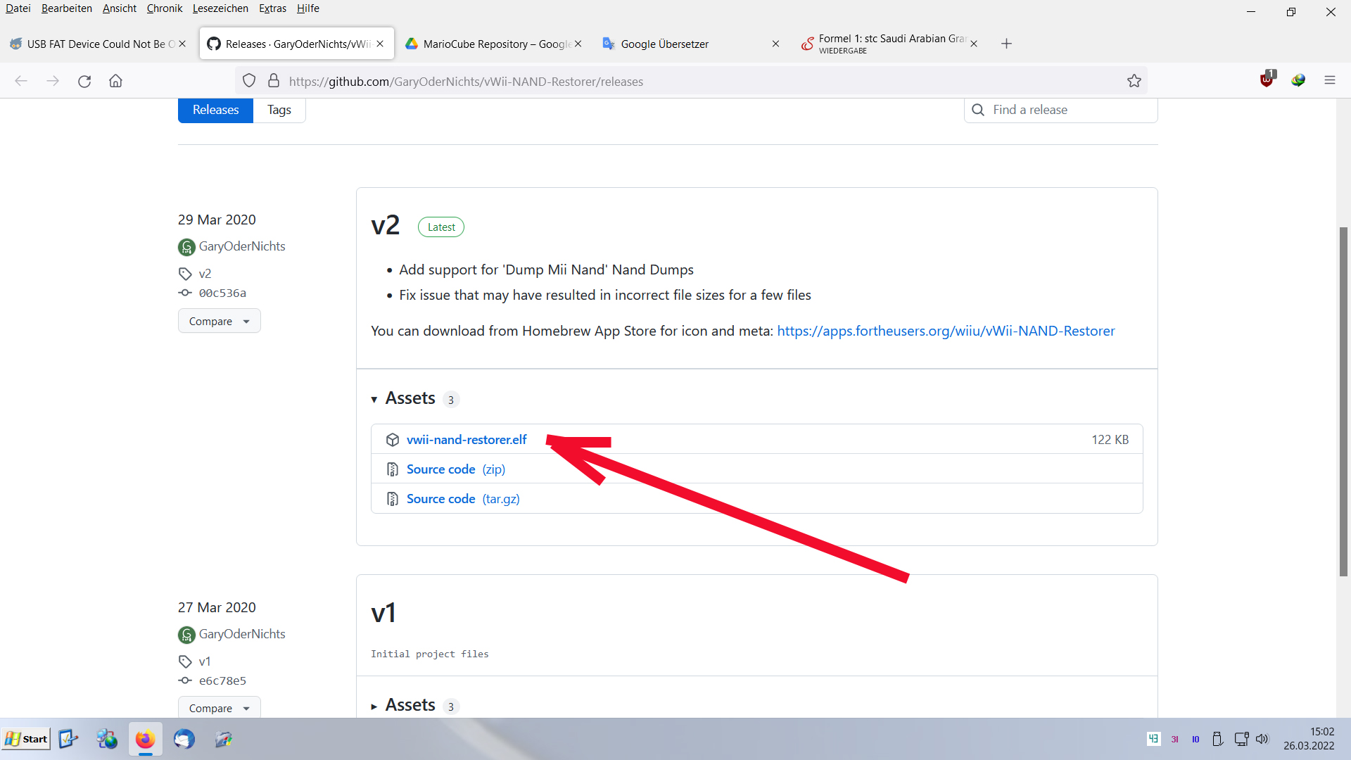

https://github.com/GaryOderNichts/vWii-NAND-Restorer/releases <-- 😉
Download it please,create the Folder "vwii nandrestorer" (or whatever you like to name it) inside
SD:\apps\
please and put the downloaded vwii-nand-restorer.elf it into.
Run it with your "Homebrew Lancher" from the Wii U Main Screen please.
I'm trying to tell you the zip file doesn't come with an elf file when you extract the contents.
EDIT: Okay I found it as a separate file in that link.
From the Link,that I gave you
it opens (on my Side here) this new Window...with the File you need.:)
