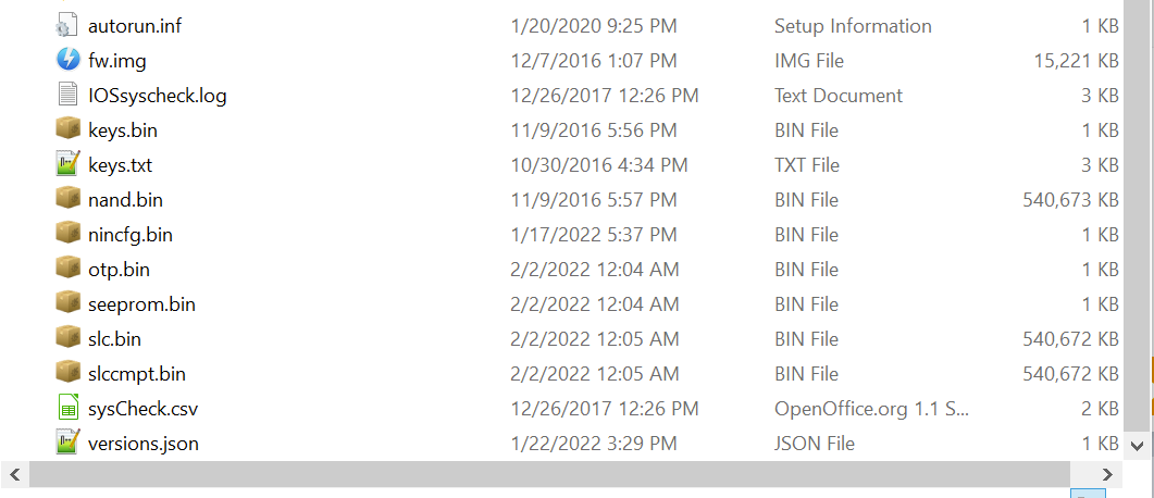

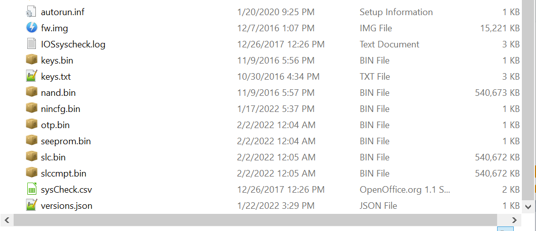

The slccmpt.bin which was previously the nand.bin is 540,673KBHow big is the nand.bin? Should be 512 MB.
Only two files showing there right now are the keys.bin and slccmpt.bin

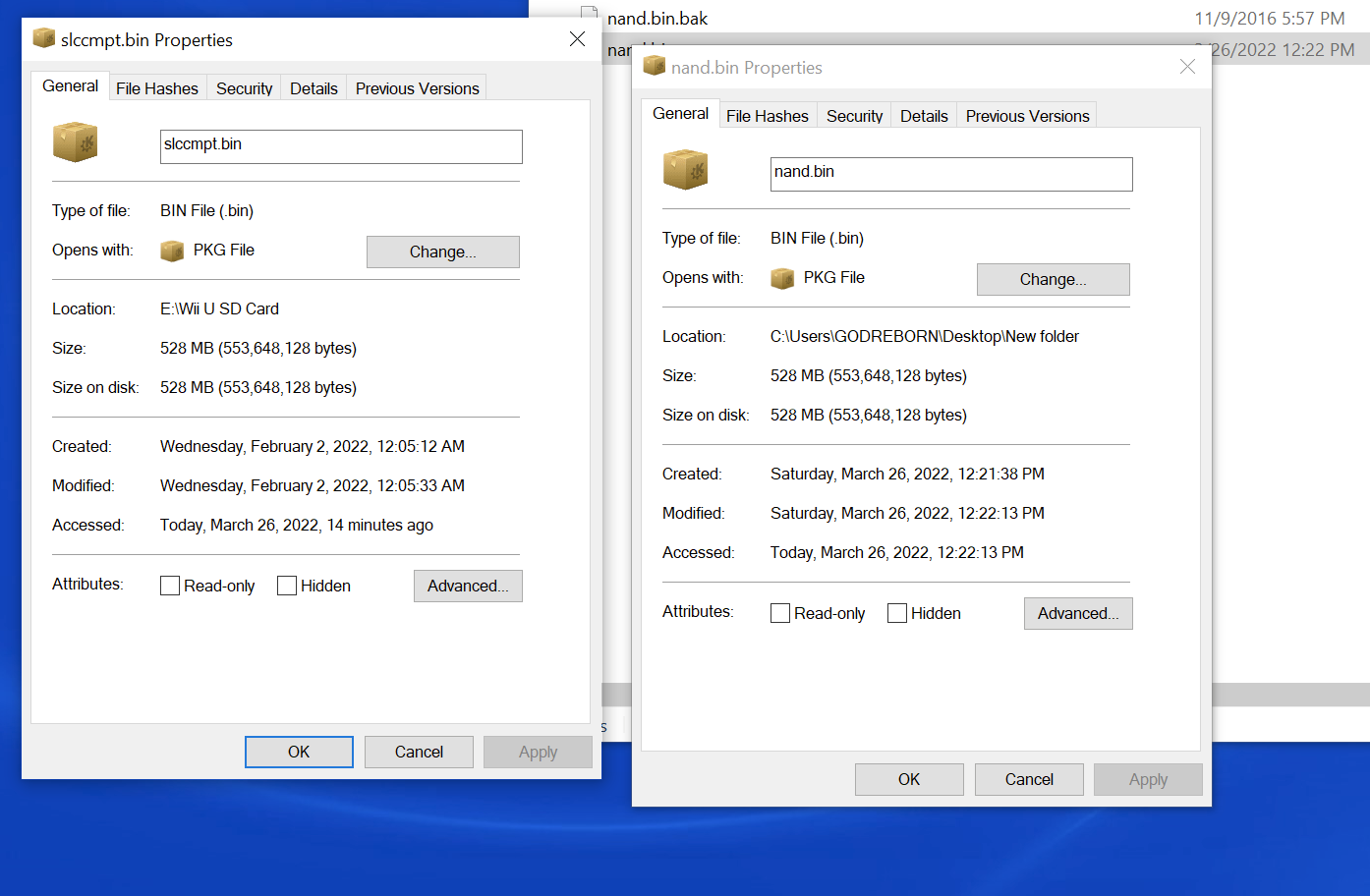

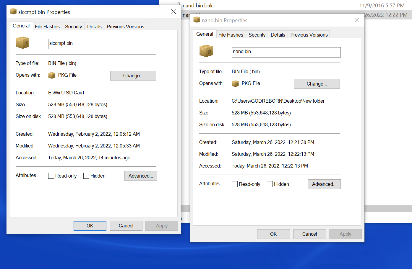

So what am I missing? What do I do?alright, I figured out why. this is part of the nand.bin. it has a special footer:
But where's the Back up Mii?that's probably why you can't restore the nand.bin. you might try delete everything from the backupmii down to the bottom, saving (it will make a backup), then renaming to slcmpt.bin
you need to drop the nand.bin into a hex editor. go to the bottom, scroll up a bit. at the line where it says backupmii console id: delete it all the way to the bottom. check if it's the size of the picture above by byte.But where's the Back up Mii?
Okay but what do I do? How do I restore my Wii part?yep, that's right. I just tested deleting that portion. now, they're exactly the same size:
