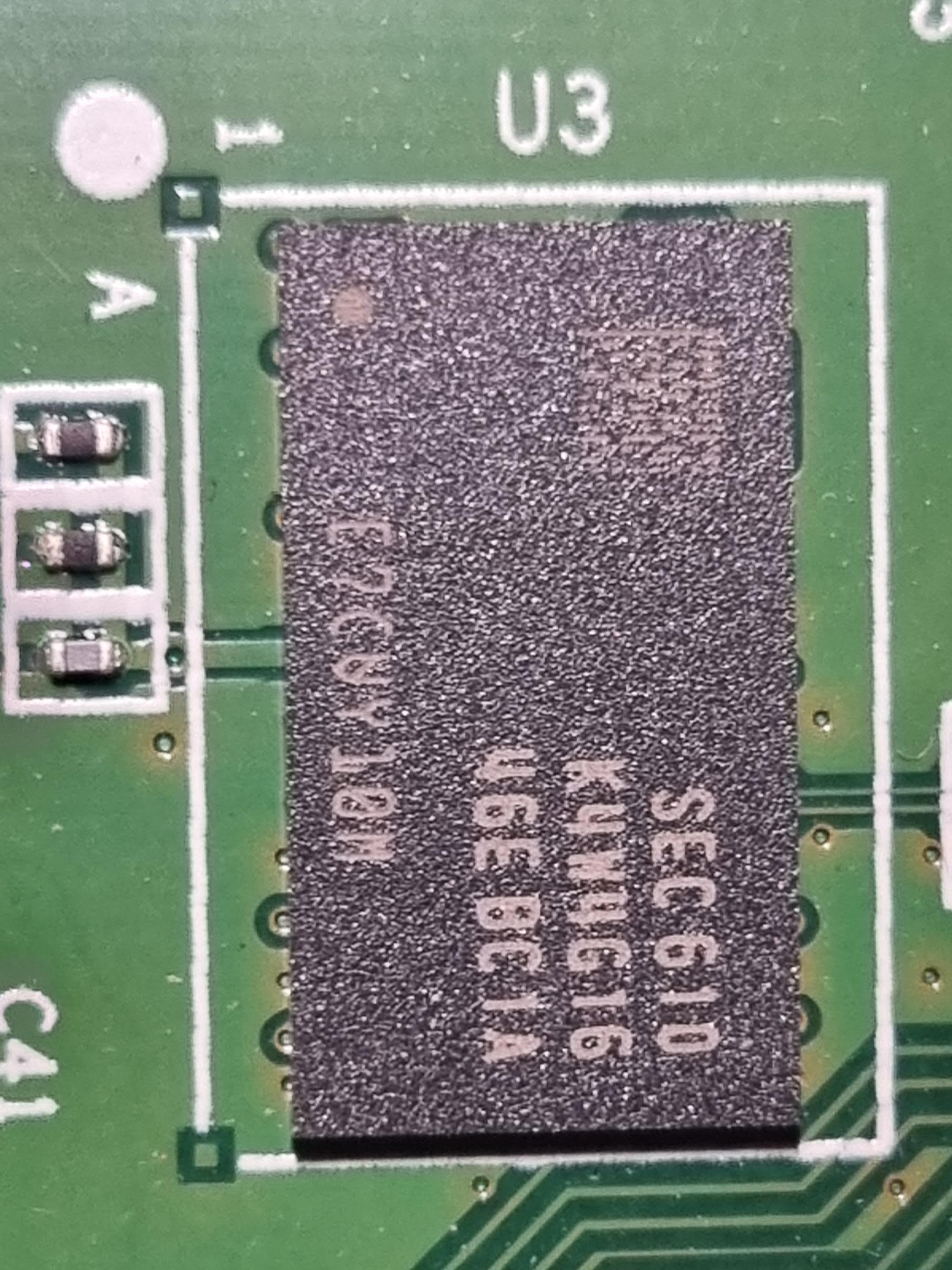

What is the manufacturer the DRAM on the board?
Not the NAND, but the dram. Because the dram config is in the SEEPROM
