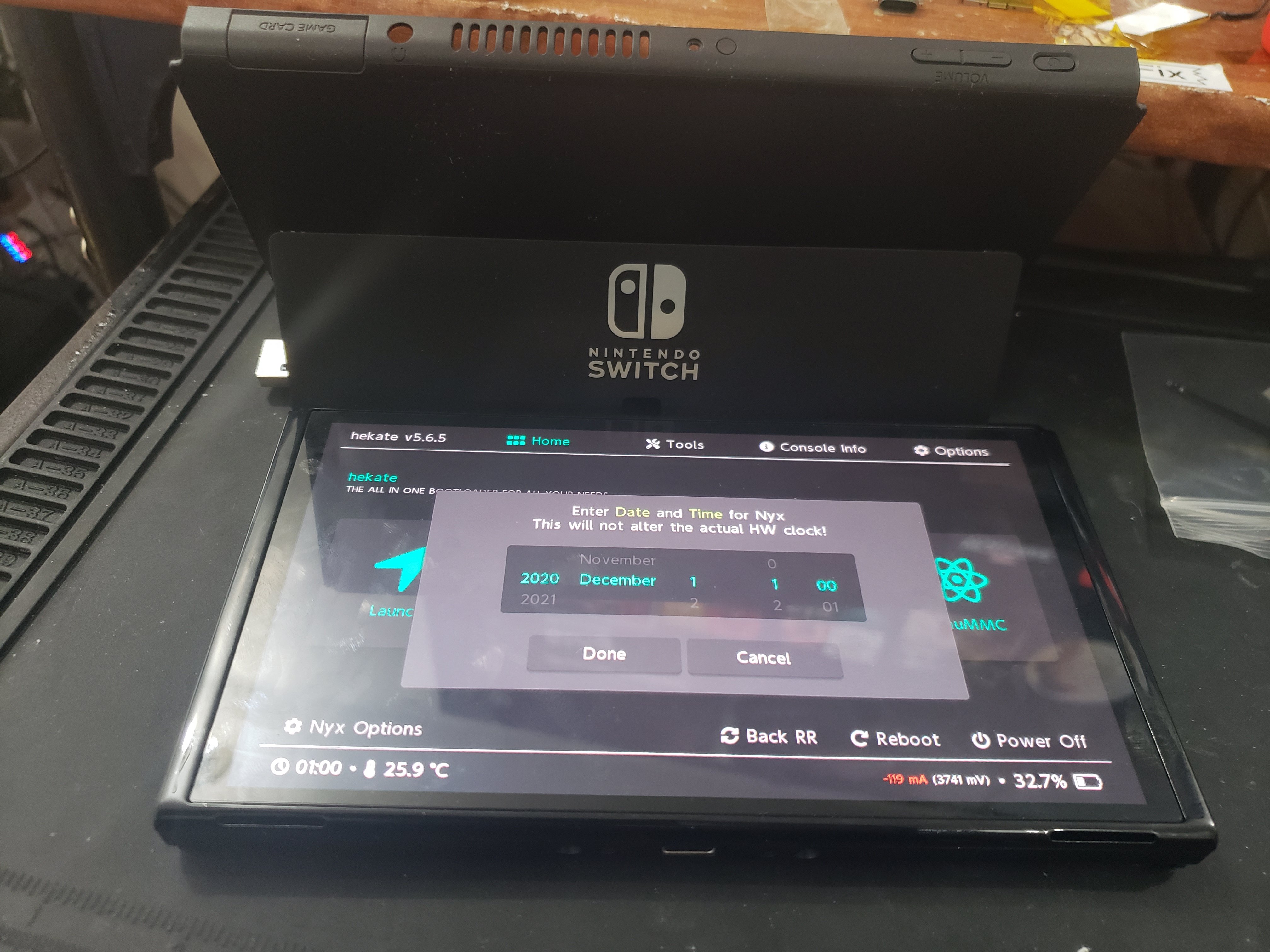

Just did it with no reballing, nor pcbway adapter ✌🏼 heck, I didn't even reflow it cause it was getting late and gotta go to work :(
Btw, I don't think the extra 0.03mm matters
How exactly did you do?
Try and error fitting a wire roughly in the position?

I did try the wire thing at first, but then I found an easier method that I am not disclosing until I run out of stock 😅
But yeah, I did test some of the things you ask that might be handy. So to try to do this, first I did remove one BGA 153 NAND, but from an old v1 switch that I had for parts, that way it was easier to measure things that would fit and touch the right thing.
Having those rough measurements, I tried to test in diode mode: pins 1 and 2 are n/c, 3/4/and I think 5 as well (maybe all of them) reads ~442.
To answer your number 1: I'm not sure. I'm pretty sure I did short some of the pins, maybe 2 and 3, or 3 and 4, because a couple of times I had a blinking blue light, then solid red, and I got wrong readings (like ~880) so I knew something was touching smth else, but the good news is, it still booted normally after connecting it the right way. Your mileage may vary tho.
3) I've been trialing and erroring for like 12 hours straight, I'm brain dead right now.

The measures stayed the same after you use your method with a successful boot into hekate? I mean, with the eMMC in place the good measure still reads around 442?

Yep, around that value

3 are DAT0
4 are DAT 1 and
5 are DAT 2
These pins reads 442 because all of then is Data lines
Which chip did you use? Was your process much easier than removing the chip or using that adaptor?
Sx lite, and yup, my method was easier, but I don't think it is waaay easier than using an adapter like the pcbway one.
