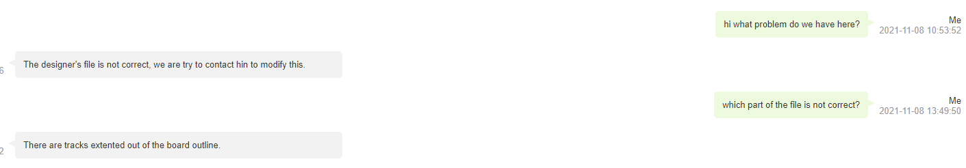

There is an issue with the file with pcbway.
Can some one confirm this adapter for DAT0 is working? Should the adapter fixed with hot glue or something else?
u r supposed to tin the connector, align it, then reflow it.
Reactions: mvmiranda
It was indeed gone when this post was written, but it seems to be back now.
I was about to order mine again on PCBWay but I still cannot select the Finish on (35um).
Did you submit your order again after the gerber was changed?
I did on the very same day this came out and got this error. Then the gerber was taken out by the creator and resubmitted once again. This new file is way different than the original.
Reactions: gelderm
ah i did not, let me try. 0.13mm for fpc thickness?
