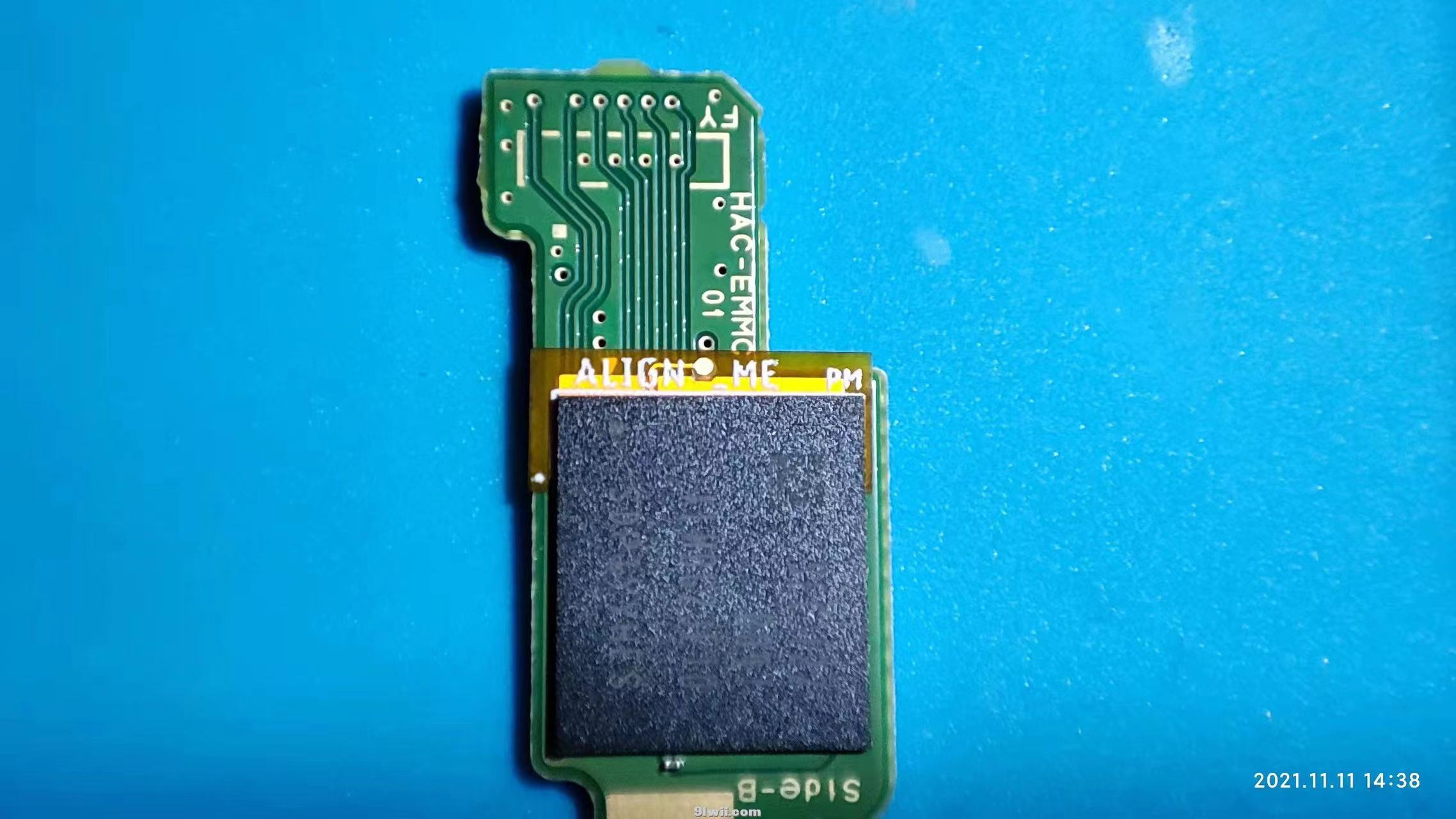

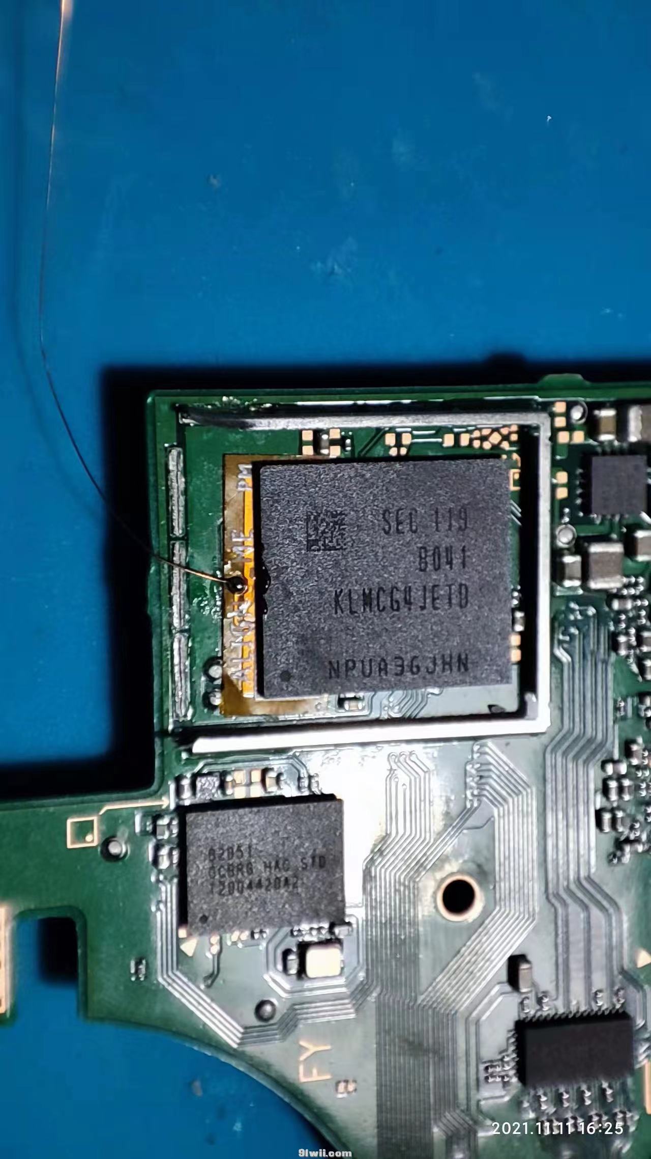

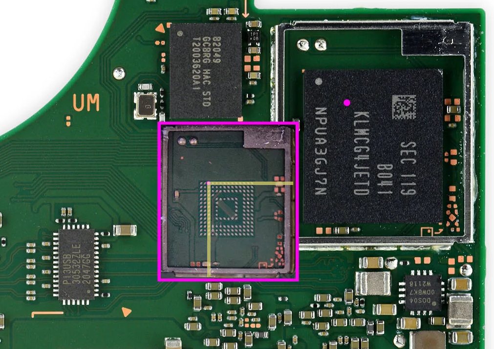

DAT0 ball is on the intersection of two “imaginary lines”: one aligned to the right border of the capacitor found on the bottom of this pic, another aligned to the border of the pad found on the right
It makes even more sense when you look at the board with the eMMC removed!

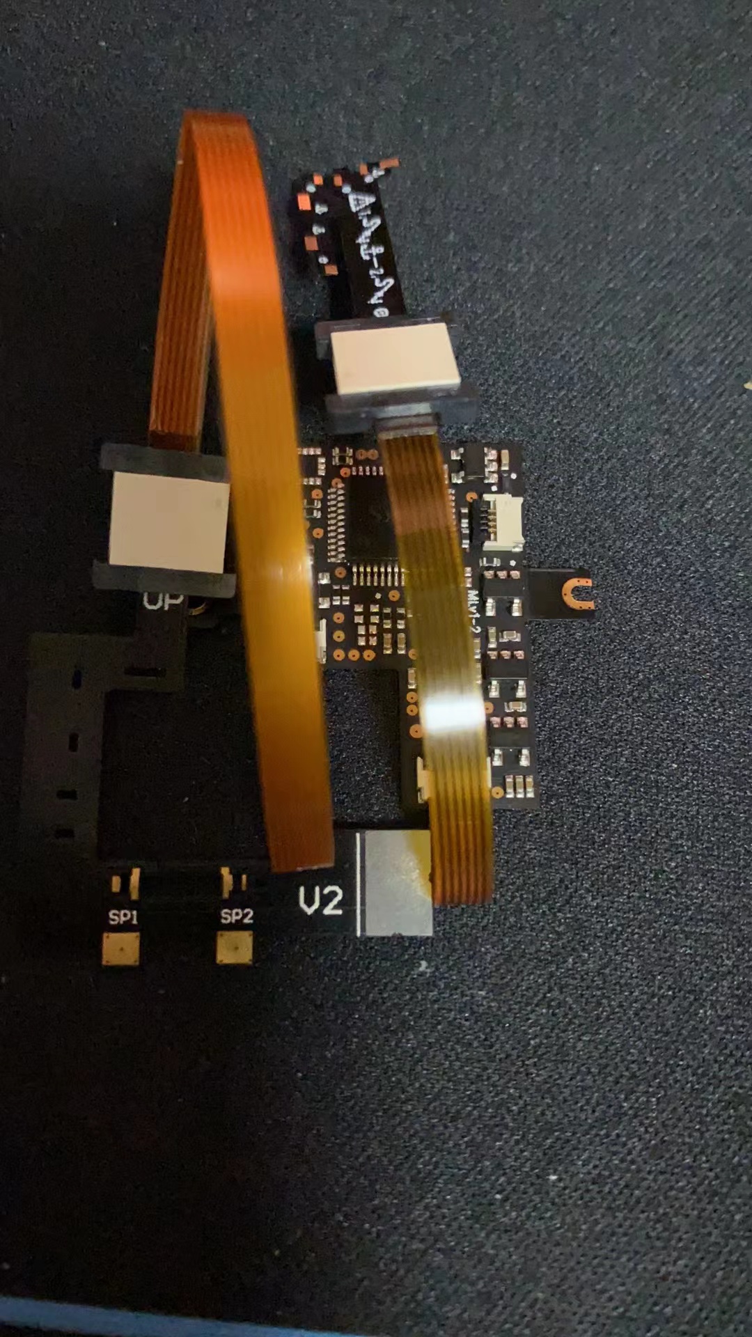

Which modchip would you recommend?
The SX core or SX lite or th HWFLY versions?
Well, honestly HWFLY works "the same" as SX and, since getting a SX has becoming more and more difficult, to say the least, go for the HWFLY.
Now, as for Core or Lite, Lite for sure.
It has a smaller footprint and seems to work better, as we've seen some folks saying the Core has some "issues" with the DAT line having to be disconnected every boot or something like this.

Sthelix confirmed that we don't have to. Just connect it permanently.
Reactions: mvmiranda
On his twitter. He posted the schematics of core on Oled. I asked him myself.
Well yeah connecting it permanently is a thing
The problem is the hwfly core is buggy glitching the oled
So dat0 needs disconnected sometimes it's an old glitch they fixed in the original sx prior to release.
Sx shouldn't have it and neither does hwfly lite because they the clone makers were cheaping out hard and the hwfly lite had issues that needed fix that original didn't have but they fixed their own cheapness.
Also hwfly uses spacecraft 1.0 and can't be flashed to a higher version so gl
Also don't listen to stethix he literally adlibs other people's info into shitty guides.
