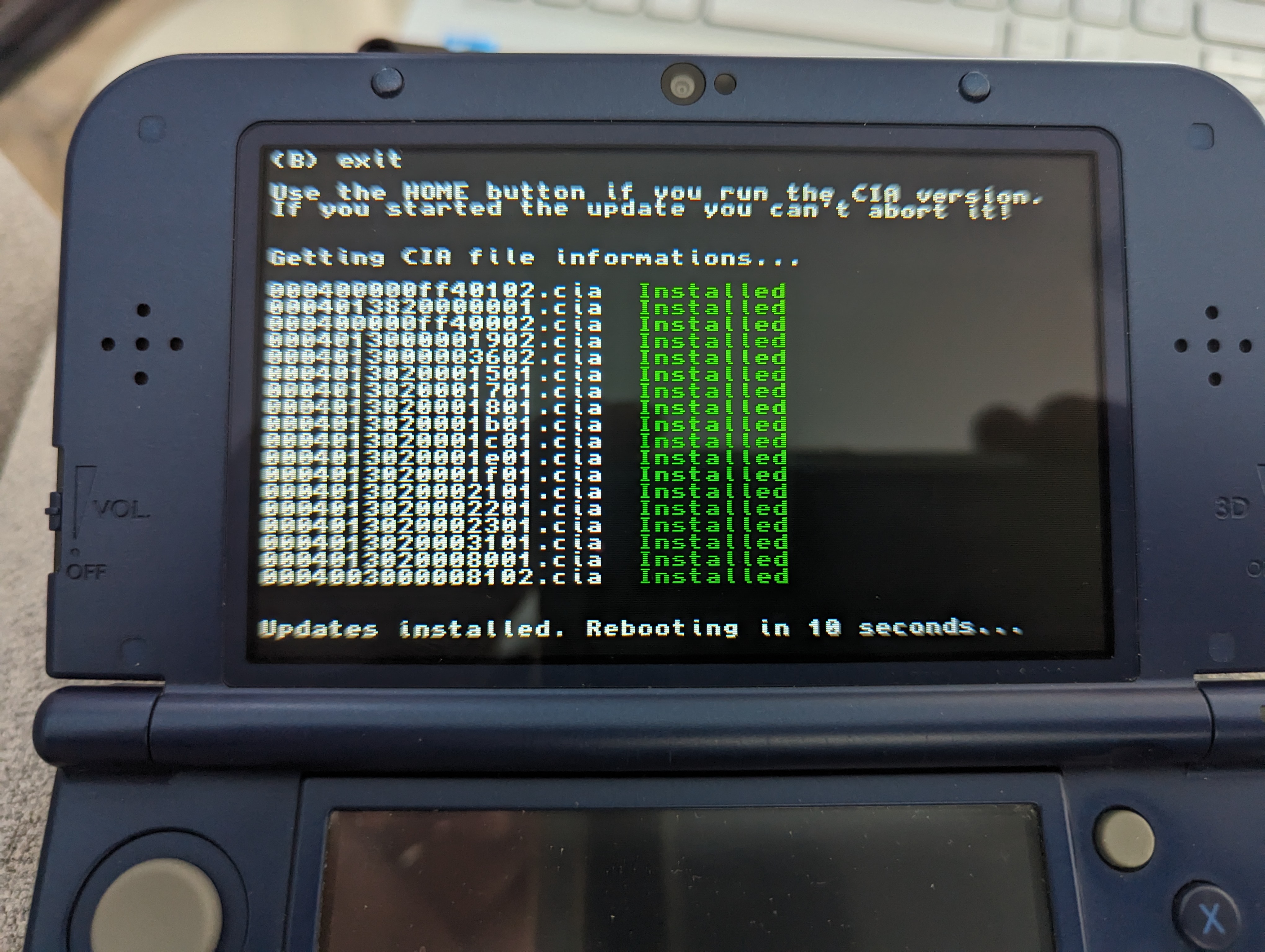

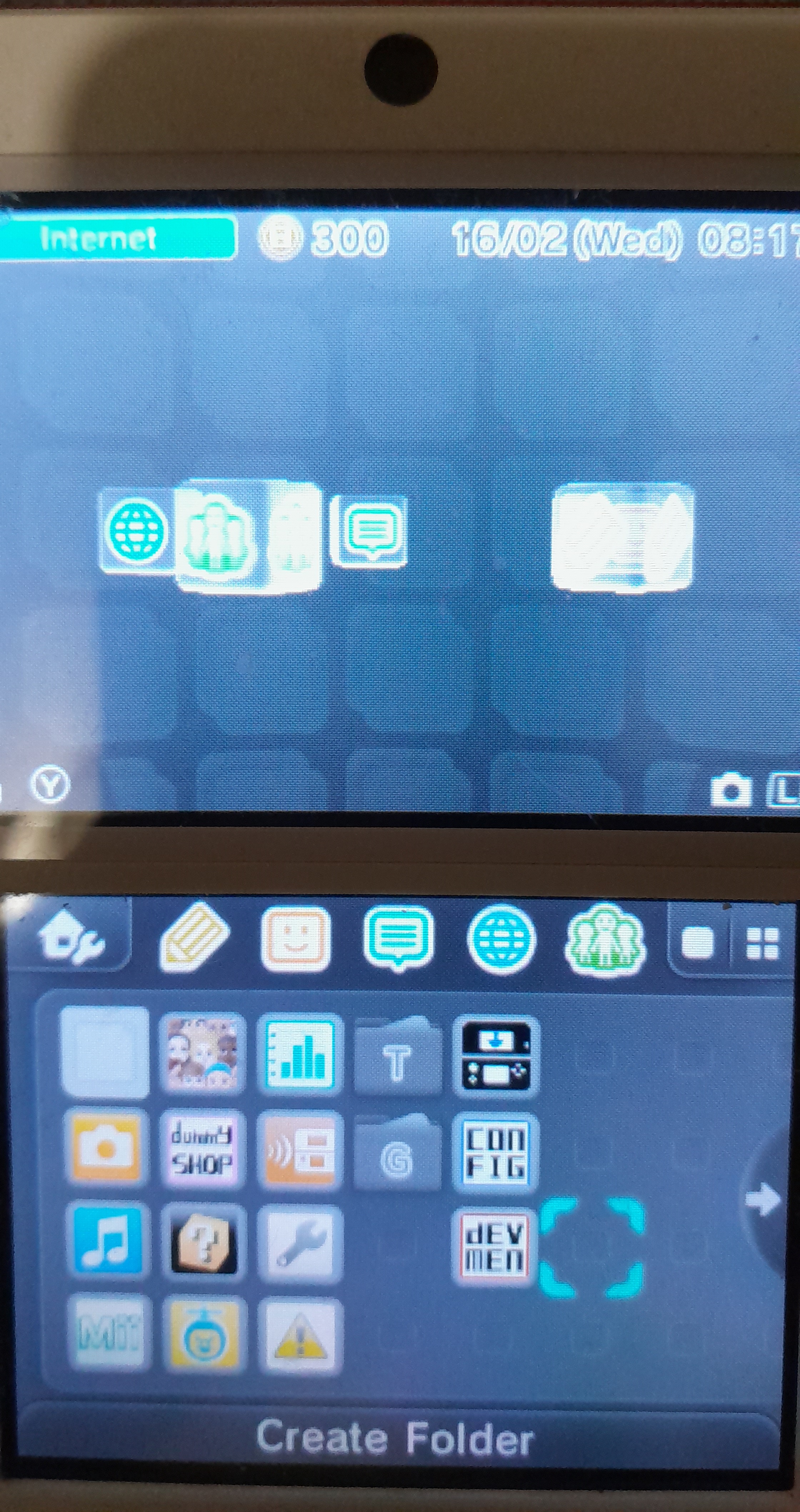

Looks like it's working on N3DS ver 11.16 EUR with SystemUpdater_SNAKE-0_35_0-EU.csu (see photos).
Just wondering why all cias were not used/installed by sysUpdater (I have 147 cia files without TWL ones and only around 20 installed).View attachment 388814View attachment 388815View attachment 388816View attachment 388817View attachment 388818
That's weird. Can you try choosing the other option in sysUpdater and seeing what happens?
If it still doesn't install all of the files, I would suggest manually installing with gm9 or FBI (though iirc FBI might complain about the update CIAs).
Elckerlijc
Aug 17, 2023
11
76
France
Already tested both "downgrade" option on sysUpdater and install all cia files from updates folder through FBI and the result was the same : crash on boot with error message "failed to decrypt the arm9 binary".
Also tried on firmware ver 11.15 EUR with SystemUpdater_CTR-0_34_0-EU.csu and exactly the same.
I'll try later on US system (after region changing) to see if it's the same.

Thanks for testing that. I'd say when you try it the next time use gm9 and skip sysUpdater.
sysUpdater always worked for me, though weirdly enough it seems to break for everyone else. If that's the problem then I'm considering removing it.
Same thing with gm9 on EUR fw. Unfortunately, still no crash dump on sd card...
EDIT :
Everything is the same with 11.15 US fw and SystemUpdater_SNAKE-0_34_0-US.csu. Tried sysUpdater, installs around 15-20 cia (I have 143 cia files except twl ones) and test menu, dev menu, config apps are working.
Tried installing all cia through gm9, arm9 error. Maybe I'm doing something wrong

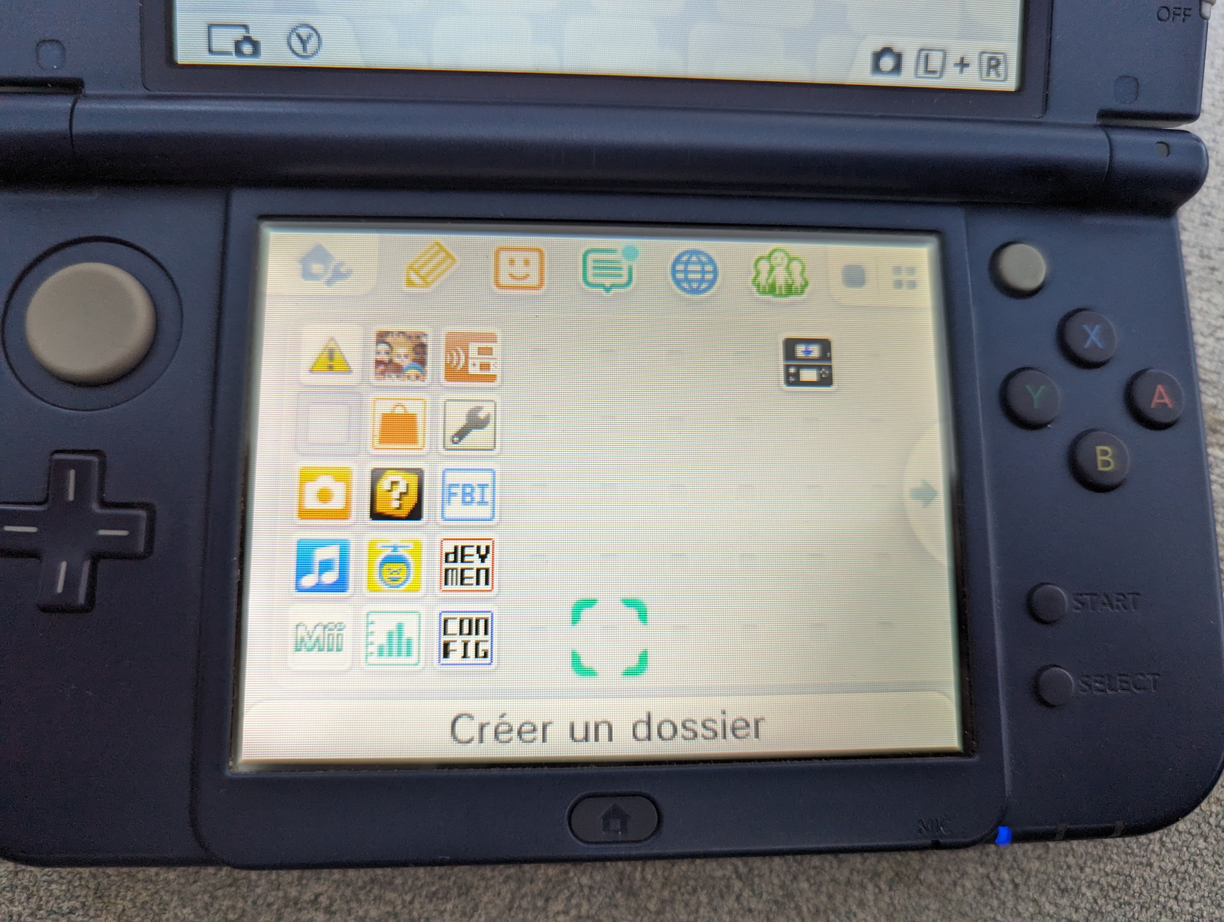

Finally found out what was causing my arm9 error after installing all cias on all x3DS I have. It was NATIVE_FIRM (title id 0004013820000002) from SystemUpdater_(snake or ctr depending which model)-0_35_0-EU.csu that was not working for some reason... Checked decrypt9.log to see if there was decrypting / re-encrypting error but everything went well.
Reactions: rvtr
Funny you should mention that, one friend and I were also discussing this, though we thought the bad firm was limited to emuNAND. We had a bad 0004013820000002 from 0.35.0 JPN and it worked on sysNAND but crashed on emuNAND. Are you on an emuNAND?
Sent someone else a good and bad copy of 0004013820000002. They compared them and had this to say:
It's 3 am right now but I'll look into this more in the morning.
