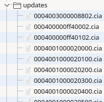

Putting the firmware on your SD
Make a new folder on the root of your 3DS SD card called "updates"
Extract the update CIAs from ZIP file you downloaded and copy them all to "updates". It should look something like this:
Installing the firmware
Open GodMode9, select all the CIAs (right shoulder button + right dpad), then install. After that reboot and you should be done!

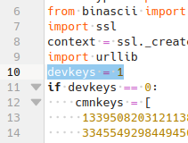

First we will need to change "decrypt.py" from cia-unix to use development keys for decryption. Change the line devkeys = 0 to devkeys = 1
Now run the script in your terminal. Important: make sure you have python 2. This script will not decrypt with python 3.

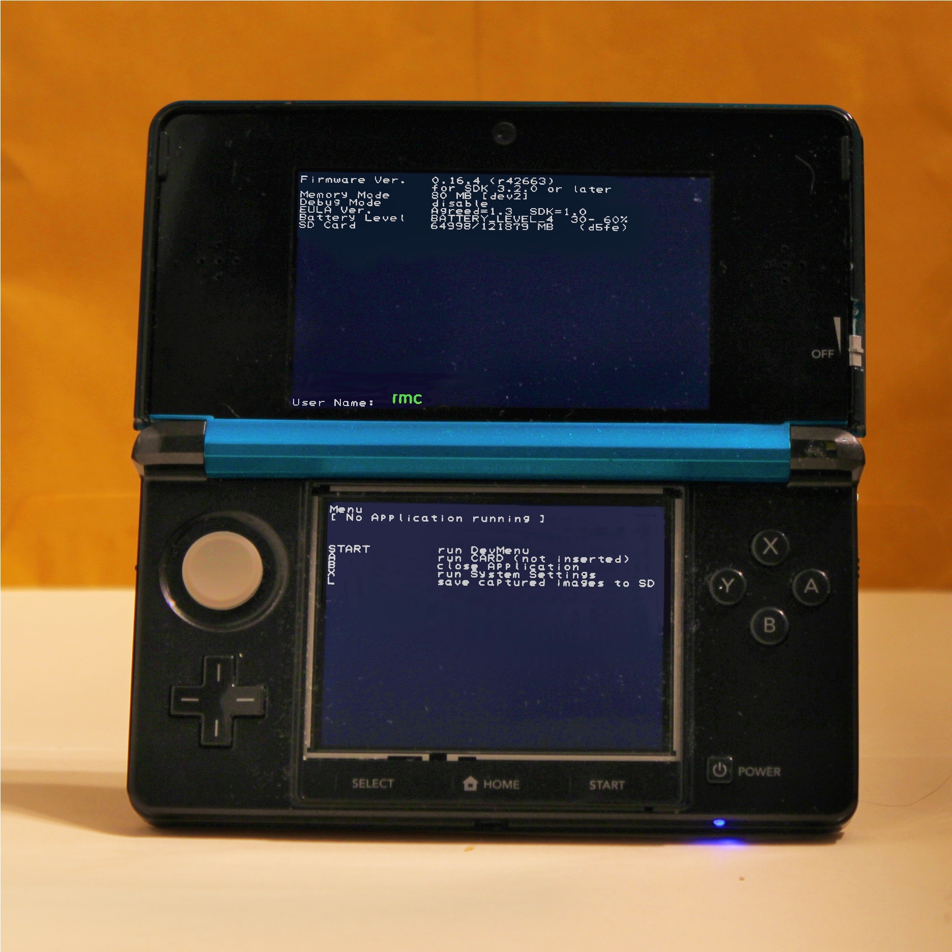

Test menu
Refer to @Konno Ryo's original information for entering the test menu. Just note that you will always need to enable developer UNITINFO in luma for test menu to work properly.
Hold select while booting and enable Set developer UNITINFO
If this option is not available to you, open SD:/luma/config.ini and set use_dev_unitinfo=1
To get Test Menu
  1. Once your at the home menu open "CONFIG", select "Menu Setting", select "Menu", press up to "test menu".
  2. Press B x2, press "Power" to reboot.
To get out of Test Menu
  1. Press Start to open DevMenu scroll to CTR-P-CFGO and press A to open "CONFIG"
  2. Select "Menu Setting", select "Menu", press down to "home menu"
  3. Press B x2, press "Power" to reboot.
Test menu
