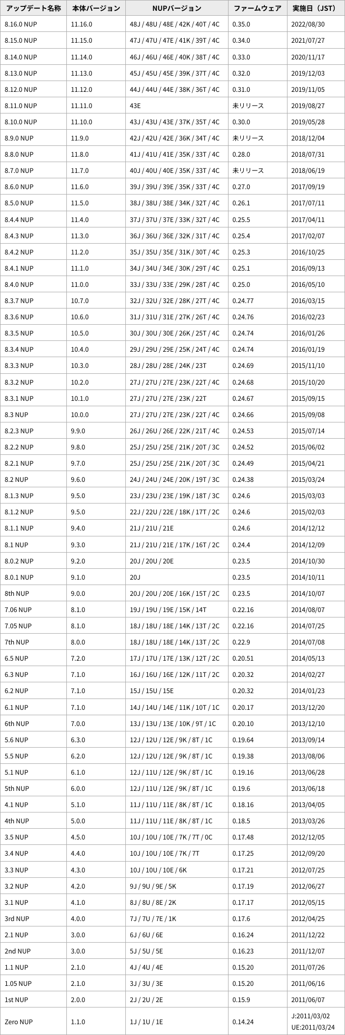

Using the wrong version will cause crashes. See this page for a complete list of dumped dev firmwares.

Using the wrong version will cause crashes. See this page for a complete list of dumped updaters.

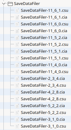

Also, is it just me, or those don't work? I was able to install regular dev firmware ones, but these ones don't work. Devmenu fails at 80% saying invalid cia, fbi fails immediately with the same error, and gm9 fails the install as well. Are those still dev-encrypted?
Reactions: rvtr
They may be dev encrypted. I just threw those together without really thinking.
yeah gm9 shows legit ticket and tmd
anyway I had a moment of clarity, and it was revealed to me in my brain that I can just decrypt the csu in godmode9, create a cia from the decrypted csu, and then encrypt that cia, and that works on retail
not sure why decrypting the cia directly wasnt working, considering that clearly gm9 can decrypt dev encrypted stuff and encrypt into retail
you just dont want to install it from gm9, because it fails to recognize the 02 at the end of the title id and installs to sd instead of nand. have to use fbi
