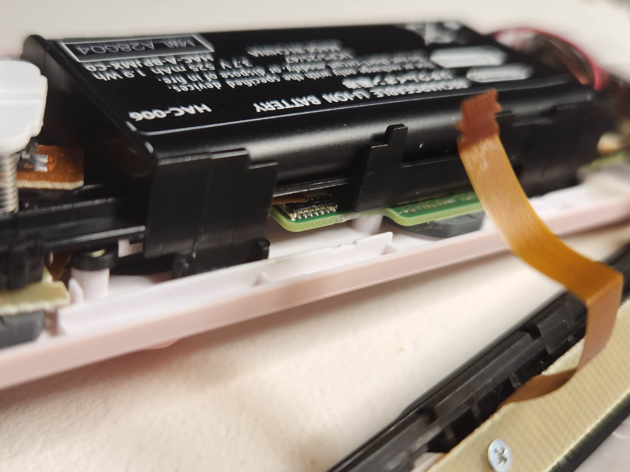

Unfortunately, I've encountered a new physical problem. Software appears to be 100% fine.
After doing the joycon faceplate change, the LEFT joycon does not charge--at least, that's the theory.
It worked fine for a day or so.
Now it doesn't connect to the switch at all. It doesn't respond to being "clicked" in, nor does it register when trying to pair. It worked once during troubleshooting and responded to the "click", but as soon as the joycon was removed, it stopped again.
When the pairing button is pushed, the pairing light will come on intermittently. It does not connect to the switch. The intermittent part may possibly related to the ZL button being slightly pressed down? Sometimes (once out of 100 times), by fiddling with the ZL button, the pairing light came on.
The switch works with other controllers so it doesn't appear to be an issue on the switch side.
I doublechecked the orientation of the battery and does not appear to be the issue.
Here are pics of the current joycon repair in progress--if this isn't the thread for this, I'll gladly remove and go there. Thanks in advance!
In pic "BATTERY", you can see this connector doesn't seem to be clipping very well, but it's still intact and holds the ribbon.

Going to be hard to troubleshoot hardware remotely. You have the best view in the house! Take everything apart and go back through everything…you missed a step, something isn’t plugged in right, something broke. You want to end up with no compromises. The stuck ZL is an indicator that it’s not been put back together properly. Go back in, go slow, you got this.
Thank you for your advice!
I dissassembled and reassembled twice and it still was not working, and all buttons were clicking properly. So I dug out an old broken joycon and used the board, and I seem to have one working (and charging) joycon now. Not sure what I damaged that would cause it to work and then stop. Regardless, the problem is apparently solved :).
You’re not a Switch modder until you’ve broken your first joycon. I have a decent collection of shit I’ve borked up beyond repair. One day I’m going to build a clock radio out of all the parts…
