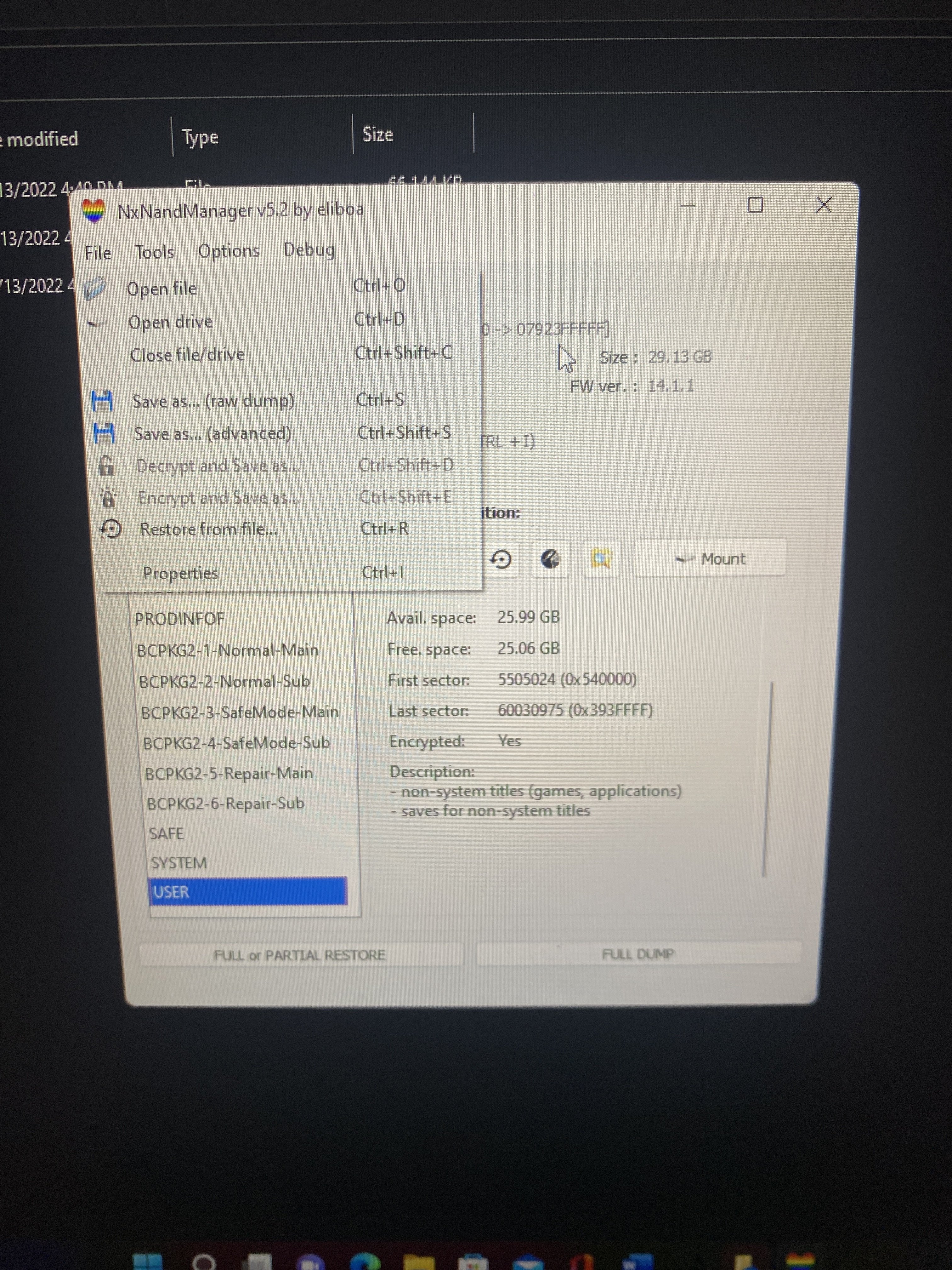

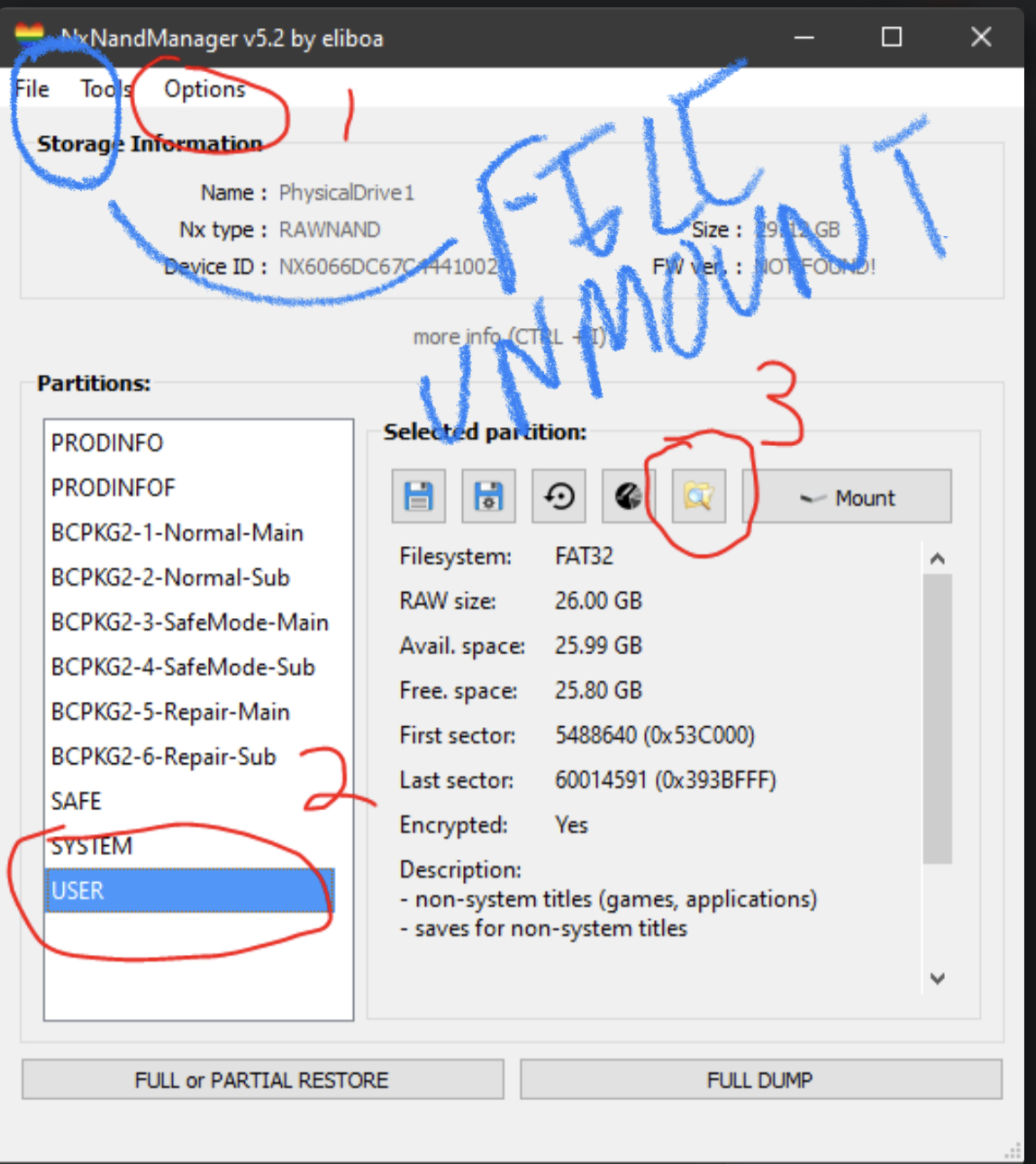

Ok I got it working👍 Currently i’m stuck on the “file and unmount” part. I see no unmount option anywhere, only “mount” on the nxnandmanager
If you go to File as shown in Blue here you should be able to inmount the file or disk that you mounted earlier.
If not, please take a screenshot and show what you are seeing.
I’m assuming unmount just means close drive😂 just want to be sure
My bad. I was going from memory. Memory was wrong.
Yes, you’ve got it! Close drive/file is exactly what you want to do.
