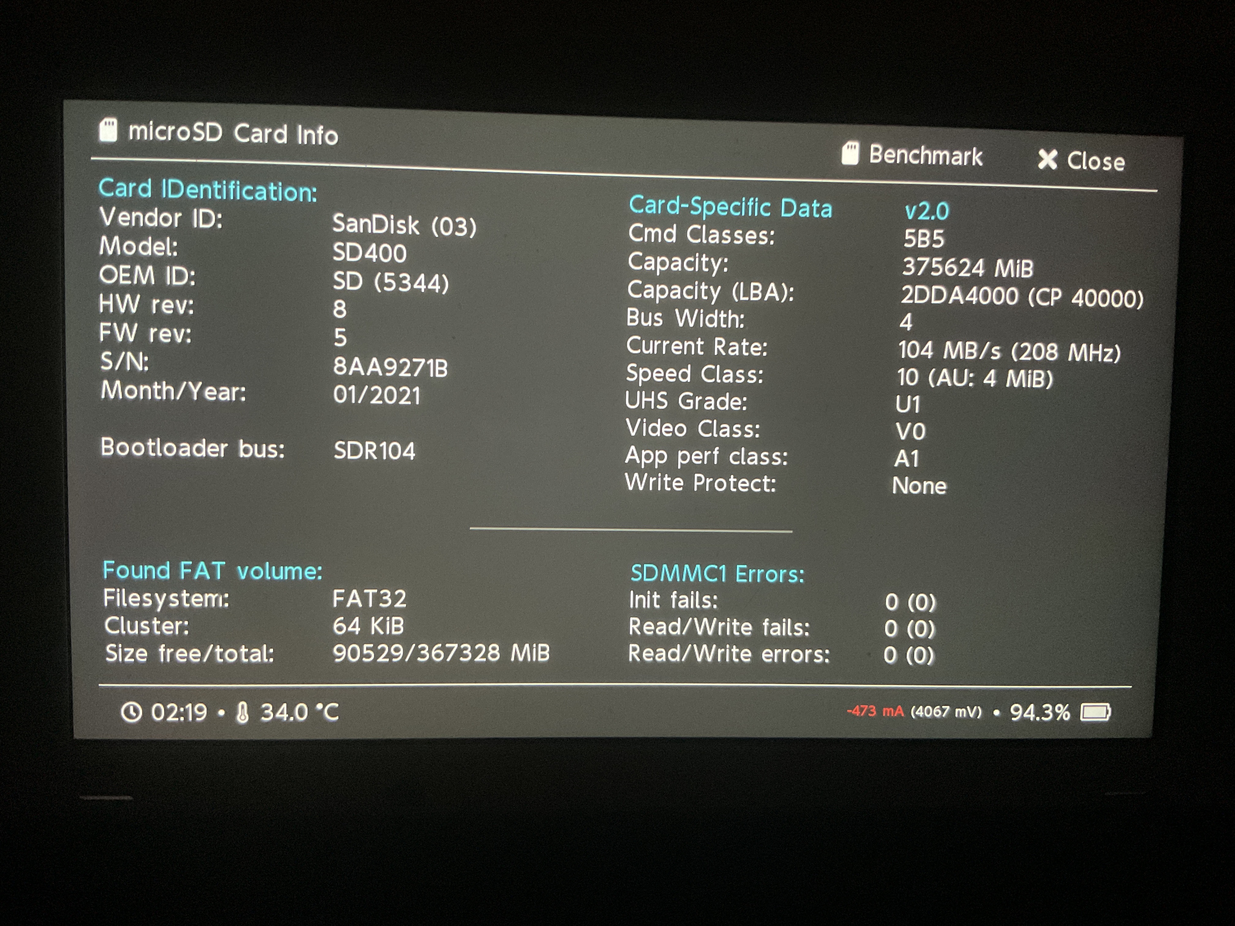

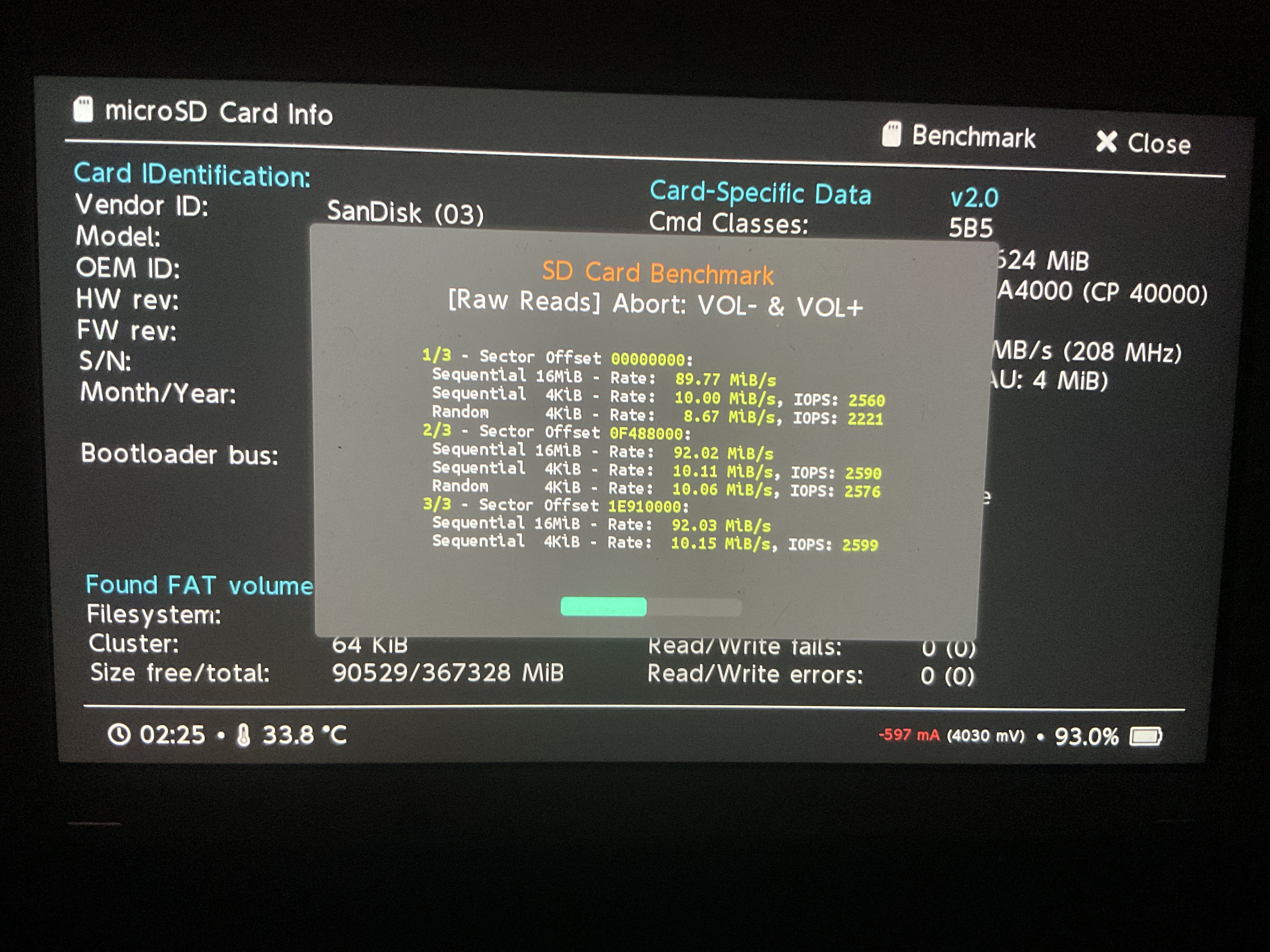

The SDCard reader on Switch is low end. Buying expensive fast SDCards for it is a waste.
Reads or Writes? Do you have a screen shot of you card specs and stats?
Here are mine for comparison (nothing to write home about):

Wow, there must be something wrong here cause mine is around 23MBs on both read and write sequential...
I'm using exFat though and already tried 128K and 256K and it's the same crap while on PC this mSD is faster than the Sandisk A2 128GB that I have.
If it pisses me off too much will start spraying WD40 down the reader :D
