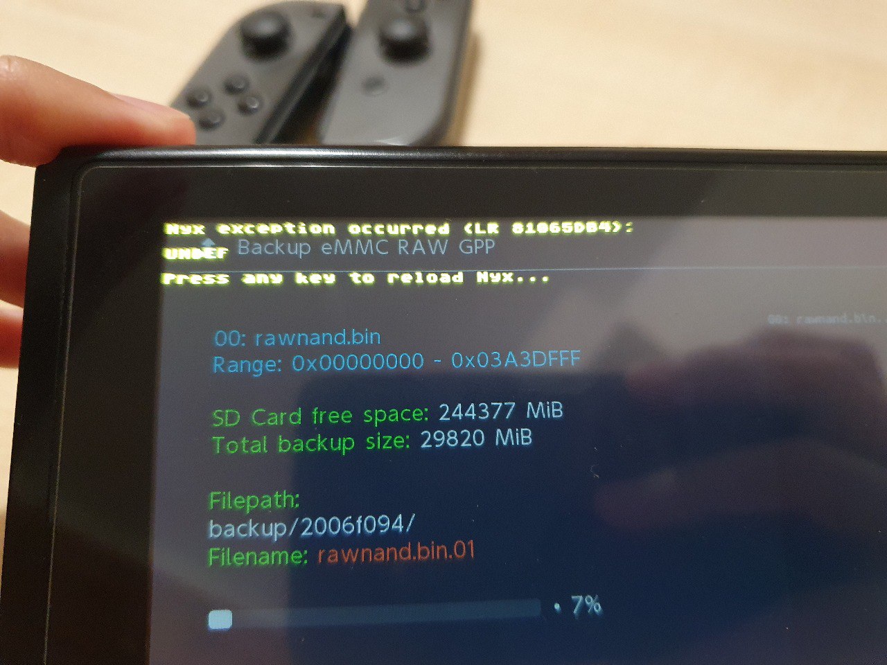

I got a new v1 switch and after putting hekate to the sd to make a nand backup it freezes after a few minutes of using it. I tried a couple sd that I had around and got the same message. That happened to me with the last hekate build with HOS in 18.0.1
The developer of Hekate recommended users to try this to fix that issue.
