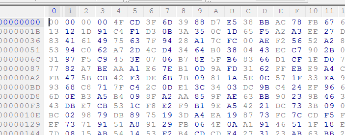

So do I need to change the first 4 bytes in the nand image or the xorpad?
Also, I'm not too sure if they are decrypted. I have only just dumped them using Decrypt9, then copied them straight to my PC. Does D9 automatically decrypt them?

Open the nand.fat16.bin in HxDand replace the first 4 bytes with 0, then usinng command line run fffuck.exe nand.fat16.bin
C:\Users\Nathe\Downloads\fffuck>fffuck.exe nand.fat16.bin
Dump contains encrypted FAT16 partition. Please supply xorpad.
Usage: fffuck.exe nand_image [xorpad]
xorpad is only optional if nand_image is already decrypted.
This is just terrible! :( I keep getting the same error...
Also, is it normal that my nand.fat16.bin is 560MB?
EDIT: this is what I did with the nand.fat16.bin:

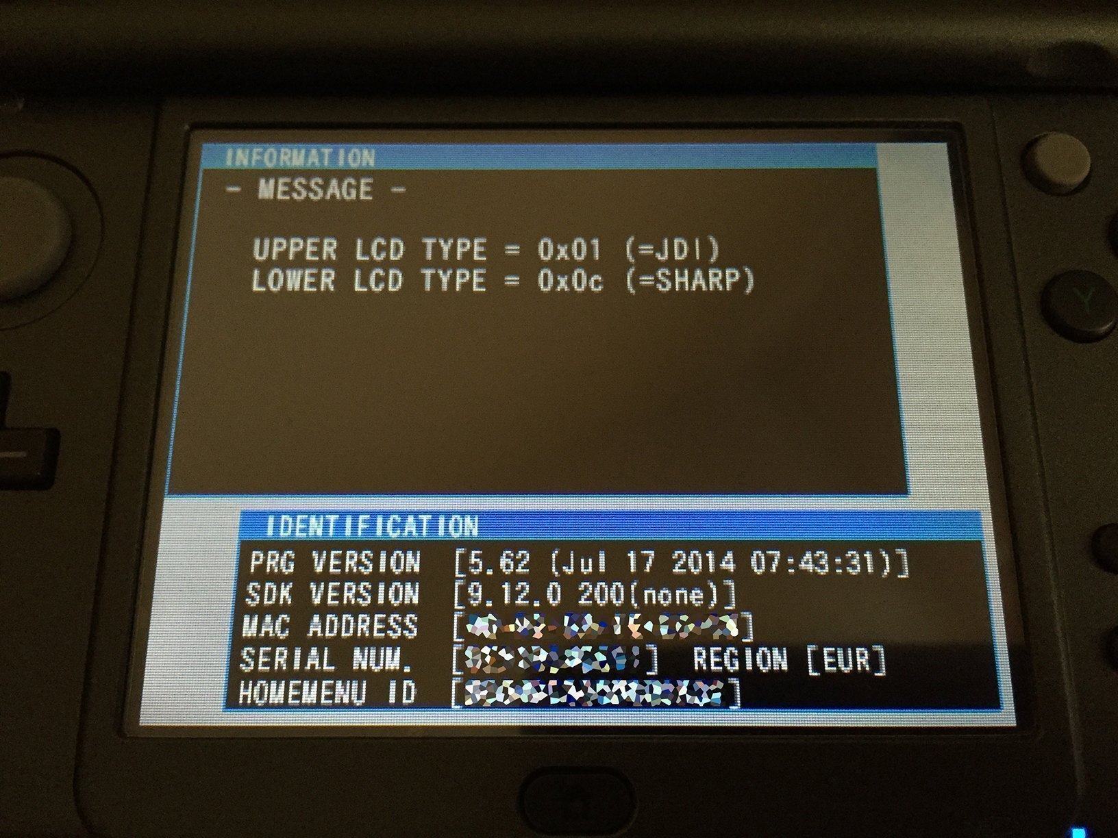

Also, here's an interesting tidbit under the debug menu:
The debug window outputs the LCD types. My model has an IPS upper display, could this be denoted as the 0x01 JDI type? Might be useful for identifying which models we have and diagnosing the scanline effect on some IPS units.
OOOH GOOD CATCH. IMMA CHECK.
You will have the search manually, then :(
I got. 0x0c (=SHARP) for both. JDI must be IPS.
