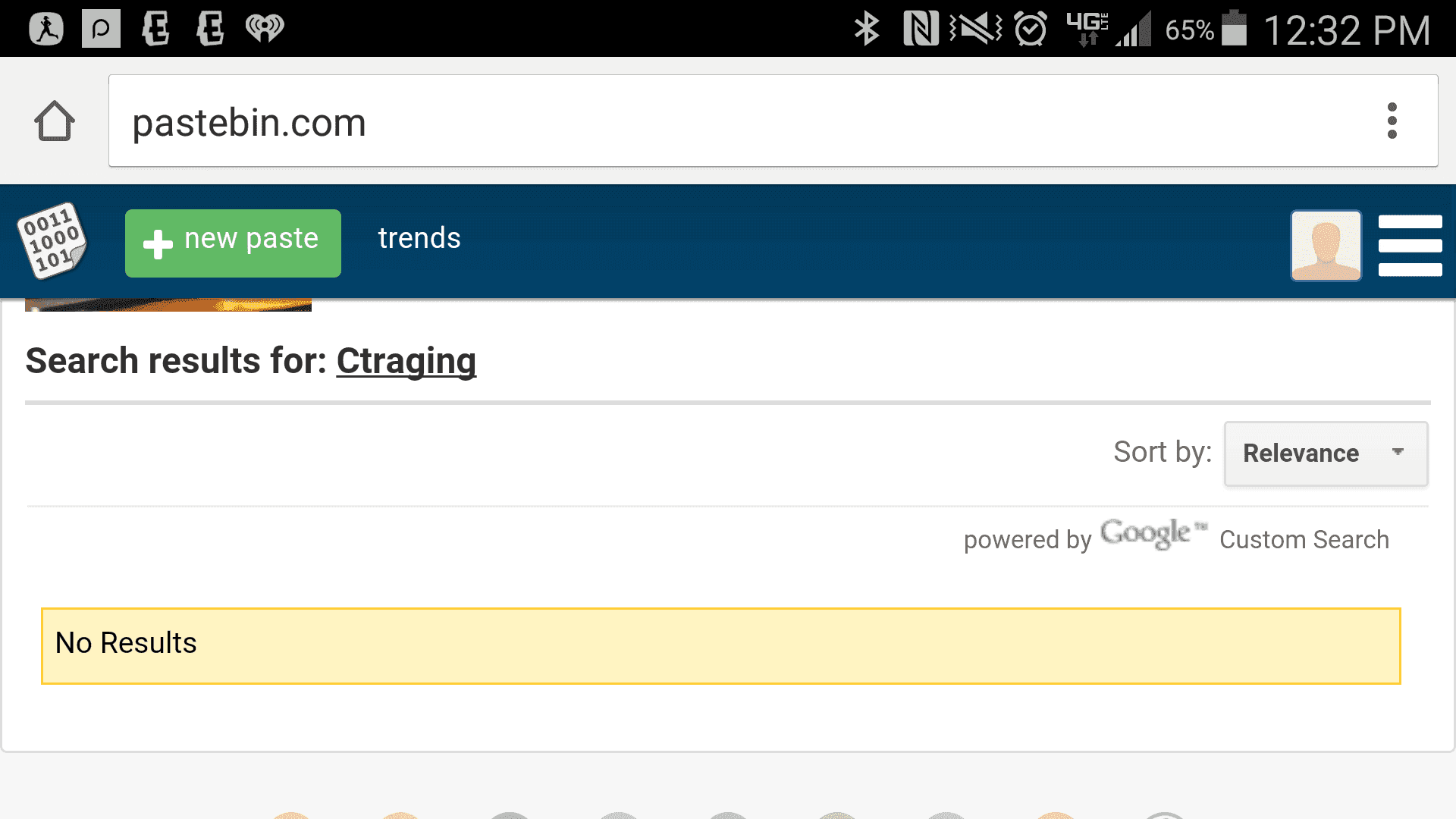

if we are talking about the same pastebin, the n3ds dump from there seems invalid
Does anything change if you turn on the developer unitinfo? (also can someone lend me a copy through PM? I have an N3DS.)
I posted the current research on pastebin, search for 3DS ctraging.
