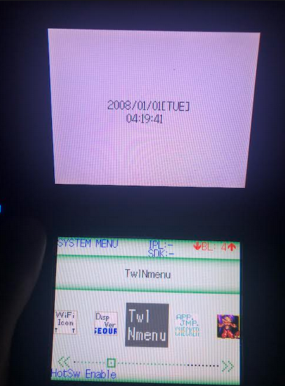

You can actually "clone" a DSi with this guide. I've cloned my dev DSi NAND to a couple other DSis. It works pretty well! (obviously no real dev support, but nice to see all the apps not getting deleted on boot like is normal for retail)
Also kinda weird having 3 consoles with the exact same serial...
