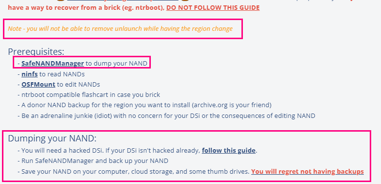

This guide will walk you through region changing your DSi. You're essentially "cloning" the firmware and all files from another NAND. :!: This is a very dangerous operation :!: and I do not recommend for most people to try it. If you do not have a way to recover from a brick (eg. ntrboot), DO NOT FOLLOW THIS GUIDE

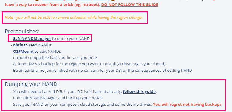

Note - you will not be able to remove unlaunch while having the region change
Prerequisites:
- SafeNANDManager to dump your NAND​
- ninfs to read NANDs​
- OSFMount to edit NANDs​
- ntrboot compatible flashcart in case you brick​
- A donor NAND backup for the region you want to install (archive.org is your friend)​
- Be an adrenaline junkie (idiot) with no concern for your DSi or the consequences of editing NAND​
Dumping your NAND:
- You will need a hacked DSi. If your DSi isn't hacked already, follow this guide.​
- Run SafeNANDManager and back up your NAND​
- Save your NAND on your computer, cloud storage, and some thumb drives. You will regret not having backups

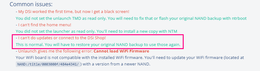

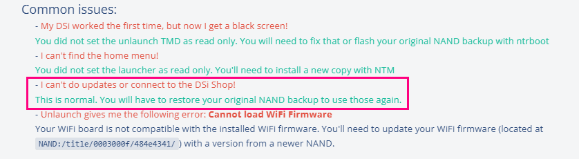

- I can't do updates or connect to the DSi Shop!
This is normal. You will have to restore your original NAND backup to use those again.

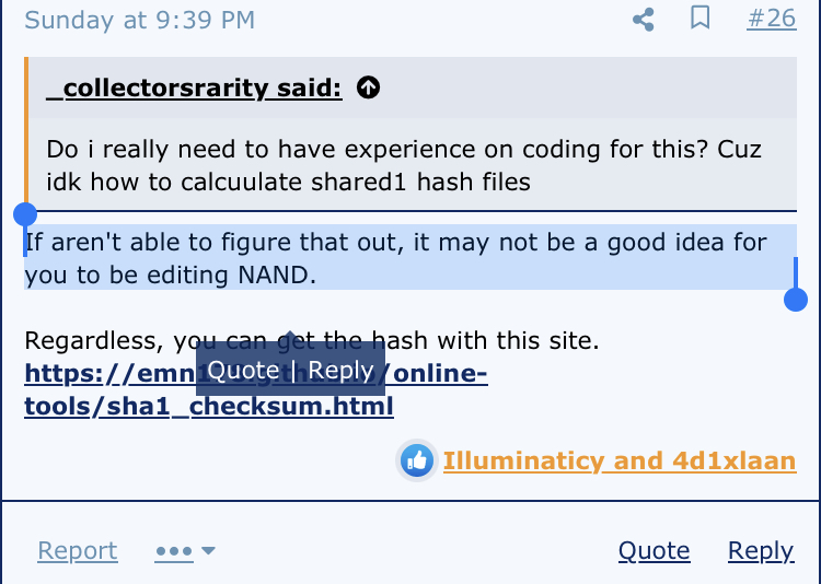

OH SHIT IM SO FUCKING DUMB
I literally reread the guide
I realized ITS THE nand.bin Your supposed to calculate not the nand.bin.sha1!!

In that case you're bricked. I'm not sure what you messed up, but something wasn't done properly
I directly caluculated the SHA1 file instead the edited nand..
Thats what i smessed up
Big "L" for me

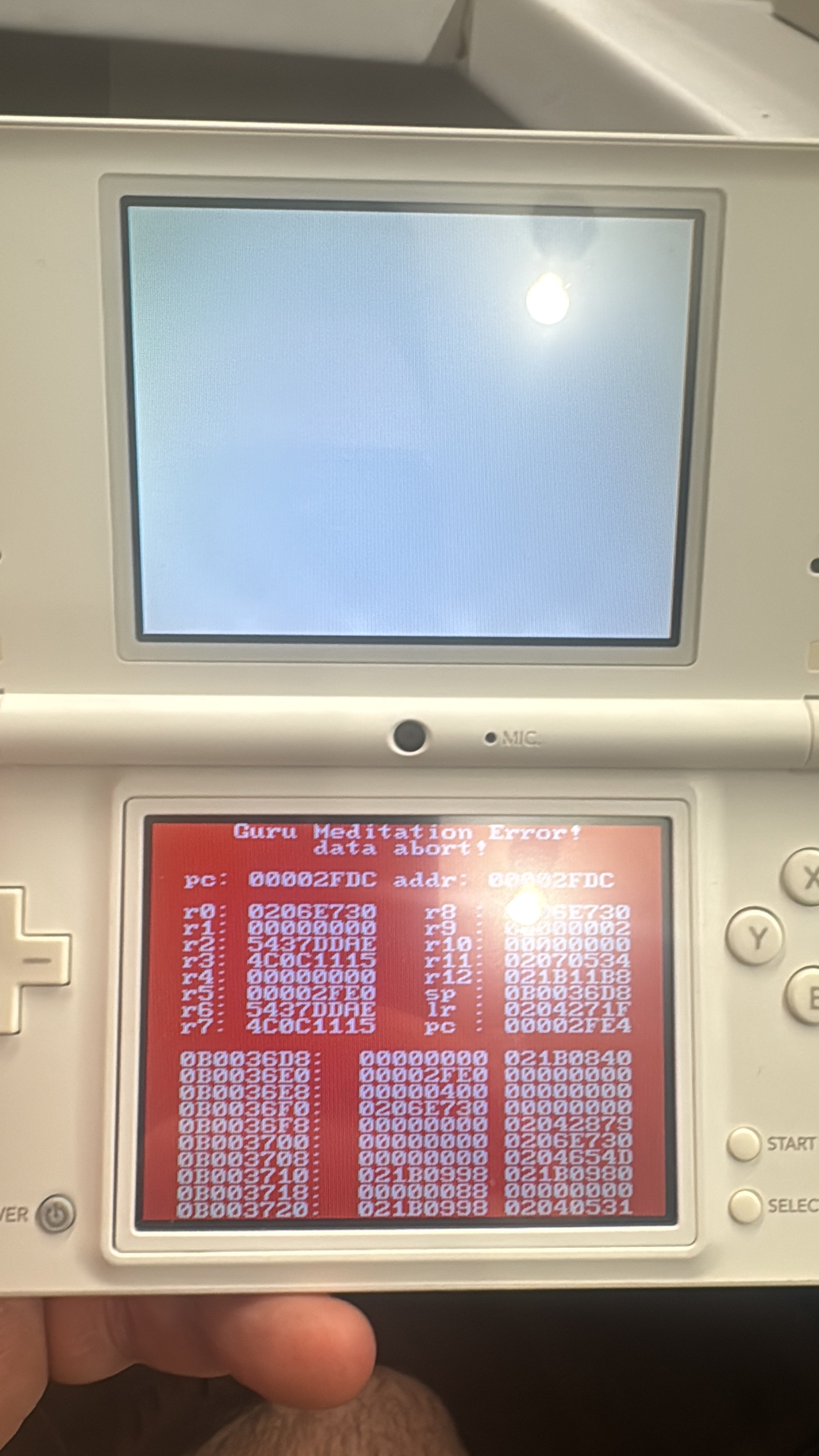

3.If an error red screen when activating twilghtmenu++ after changing the ndsi region, Just start twilghtmenu++ once in hiyacfw (I've encountered it, but I don't know how it works).

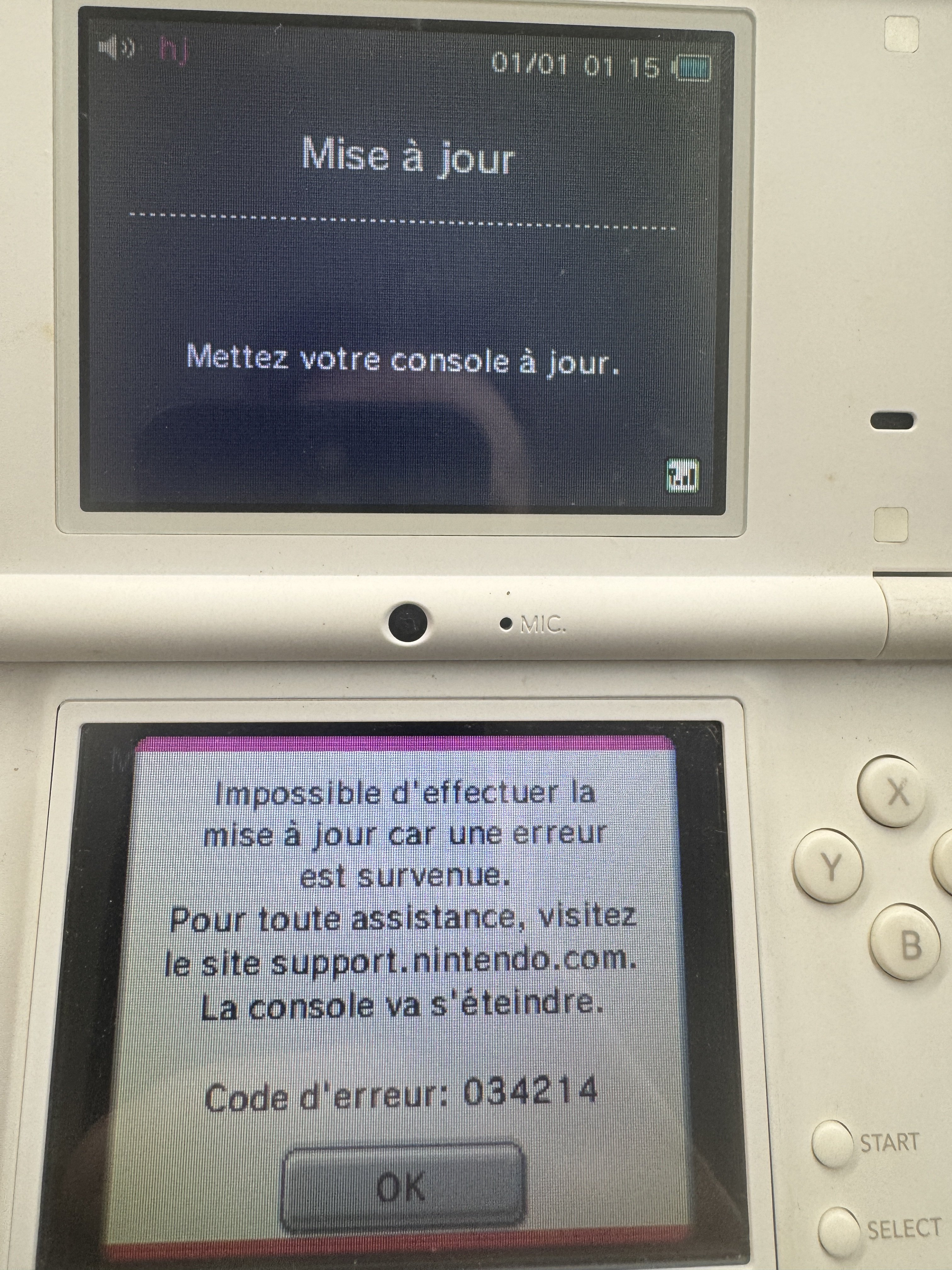

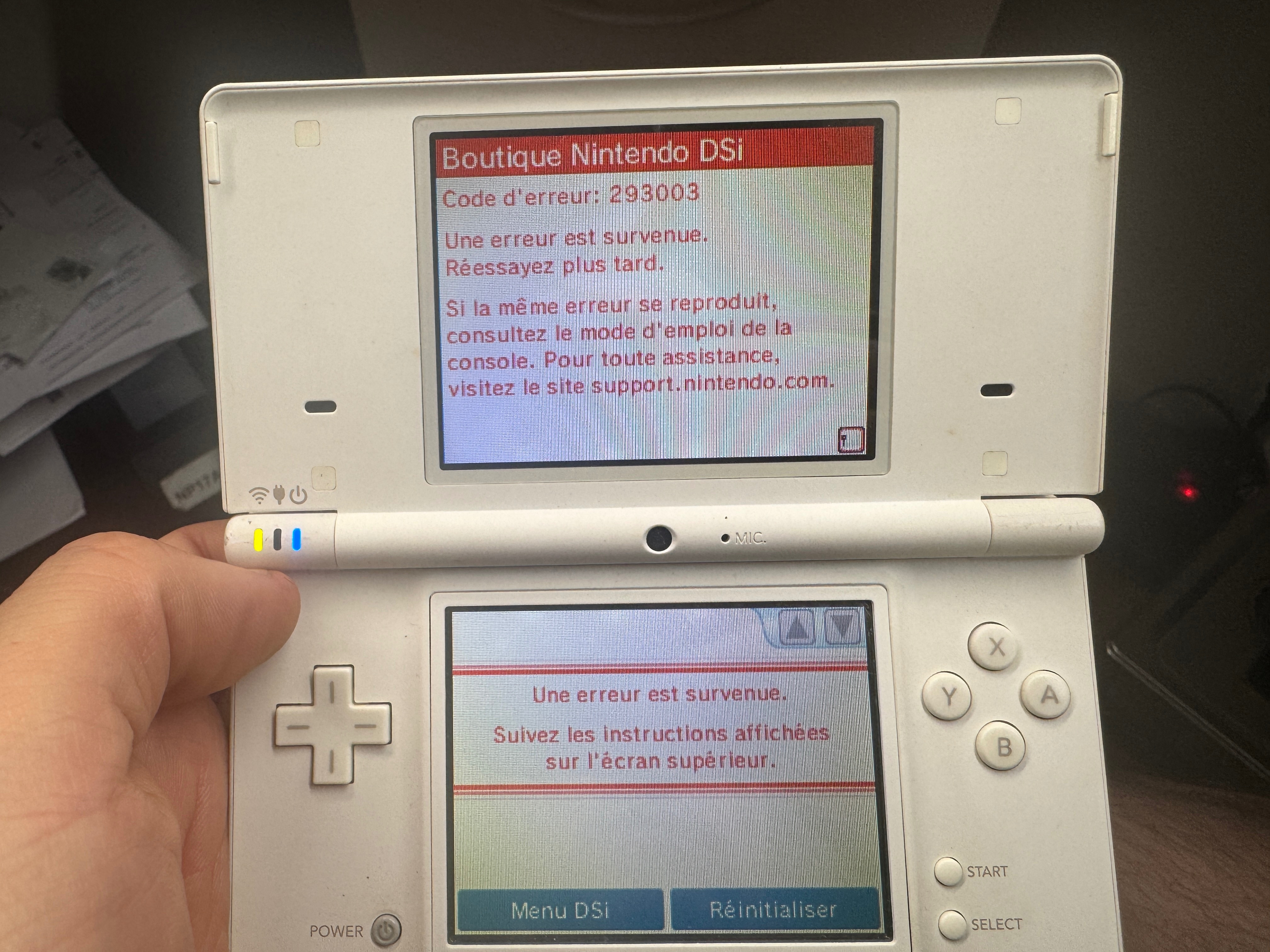

J'ai joint des photos montrant les trois messages d'erreur auxquels je suis actuellement confronté.
Le premier problème est lié à la mise à jour du système. Bien que la console soit déjà à jour, je ne devrais normalement jamais rencontrer ce type d'erreur.
Le second problème survient lorsque j'essaie d'accéder à la boutique Nintendo : je reçois un message d'erreur lors de la tentative de connexion.
Le troisième (en rouge) apparaît dans le menu Twilight après que j'aie terminé le tutoriel complet, tout restauré et supprimé les deux fichiers requis dans le dossier shared1.
Si j'ai bien compris, lorsque cette erreur Twilight apparaît, je ne dois absolument pas lancer Unlaunch ensuite. Sinon, la console devient inutilisable et je perds complètement l'accès au menu, ce qui rend toute restauration impossible.
Cependant, si je conserve ces deux fichiers au lieu de les supprimer, Twilight fonctionne correctement et la console démarre normalement ensuite.
En gros, tester Twilight juste après la restauration me permet de vérifier si le tutoriel a fonctionné correctement et m'évite de rendre la console inutilisable via Unlaunch.

À ce stade, ces trois erreurs sont les seuls problèmes restants qui empêchent la console de se comporter exactement comme une DSi française entièrement originale.
Si quelqu'un a une solution ou des informations concernant ces erreurs, je vous serais très reconnaissant de votre aide.

You'd better post in English on this forum.
Are you using this tutorial? Do you have a NAND backup?
You can restore NAND to recover everything.
Unlaunch → safenandmanager, restore NAND.
Or ntrboot(godmode9i) → safenandmanager, restore NAND.
It is normal to be unable to use system update and DSi shop.
If you want system update and DSi shop:
You need restore NAND backup, then use the DSi Language Patcher.
If you see duplicate Launchers and system apps at the top of the Unlaunch interface, then your donor NAND may come from a DSi that had a language patch applied.
After changing the DSi region, TWiLightMenu++ shows a red screen:
You can try launching TWiLightMenu++ once in hiyaCFW.
Or launch SD:/title/00030004/53524c41/content/00000000.app once.

I don't quite understand what you want to do.
Don't you want to: uninstall Unlaunch, update system, access DSi shop?
You cannot achieve these 3 things through this tutorial(Region changing a DSi on NAND).
You need:
Uninstall Unlaunch: restore NAND backup first. Then you can use 'safe' Unlaunch to uninstall/install Unlaunch.
Update system, and access DSi shop: you can use the DSi Language Patcher. It can use system update and DSi shop while you change the language.
