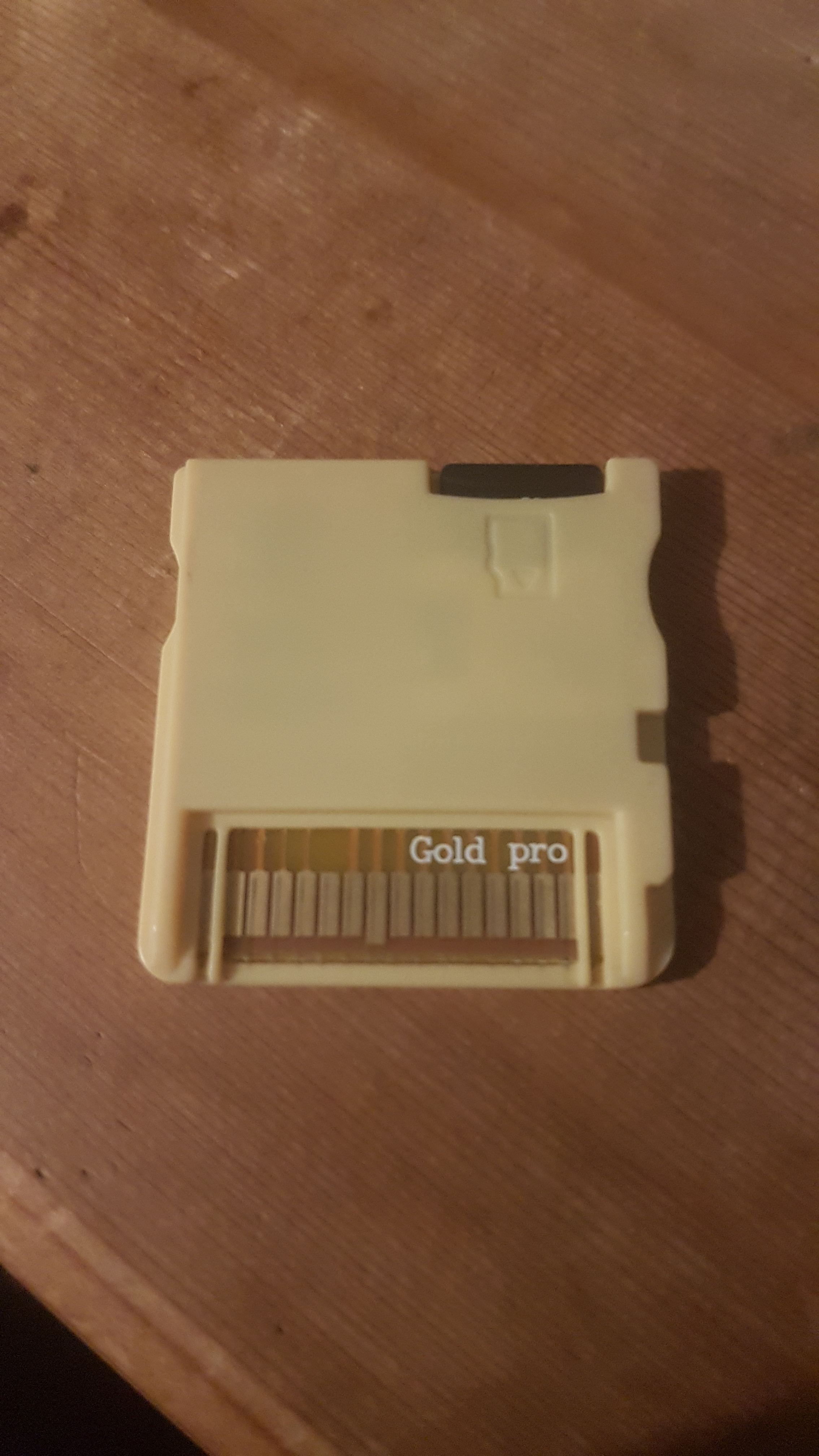

Got a pic of the R4 card? There's many MANY variants, and they all work a little different.

oh damn, is it THAT finnicky? alrighty, so I got pictures of both the front and the back. hopefully this helps!!1678102144550.png1678102236208.png

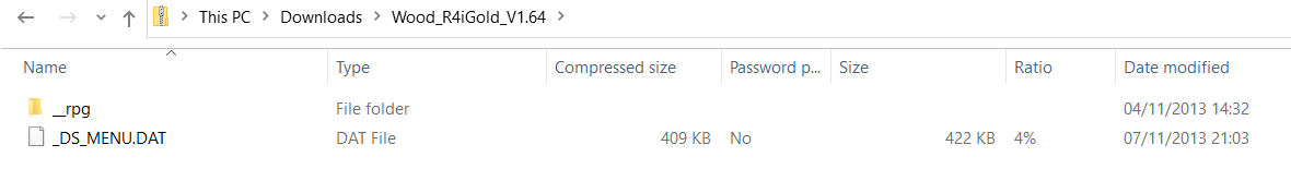

Unzip that file. Take a screenshot of the files that comes out from that ZIP.
I'm a bit rusty on this stuff, and screenshots might help with the process.
Well, it's scary the first time.
Just have in mind that it'll get easier overtime.

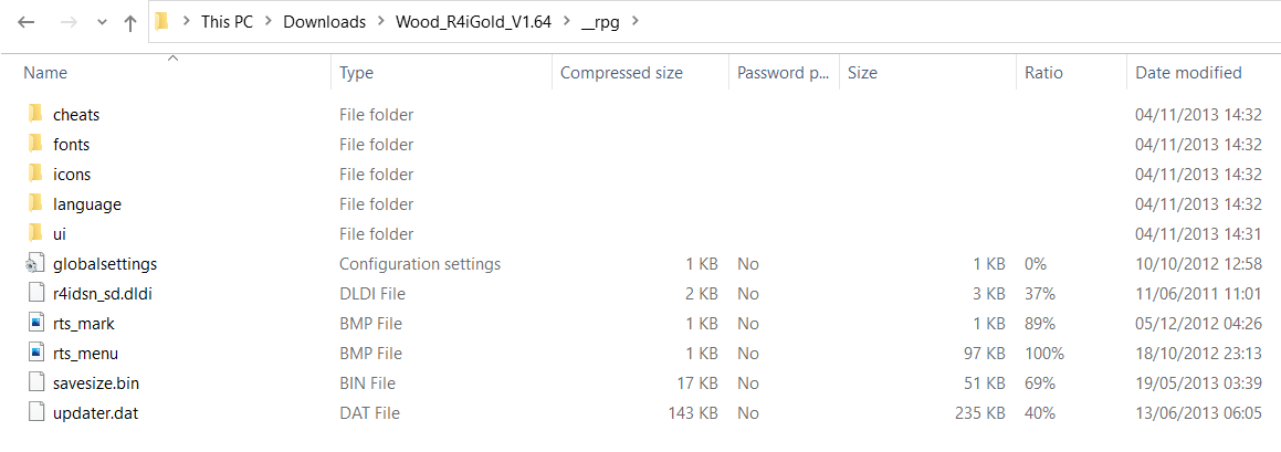

Bit blurry.
But will try to explain, if I recall correctly.
The folders contains files that the menu will show, for instance, background images, icon images (such as "back" or "options" or "load" icons) and the fonts and cheats folders should all be self-explanatory.
I don't recognize the other files, and the blurryness Is making it difficult to read proper names.
But the one with .dat is I presume, the kernel itself.
Make a backup of your SD's files (with the exception of your Games folder) and then copy paste all the files that came in the zip in the root of your SD. Try and report if it's working.
Might not because your files seems a bit sketchy, for instance, that .dll... 🤔

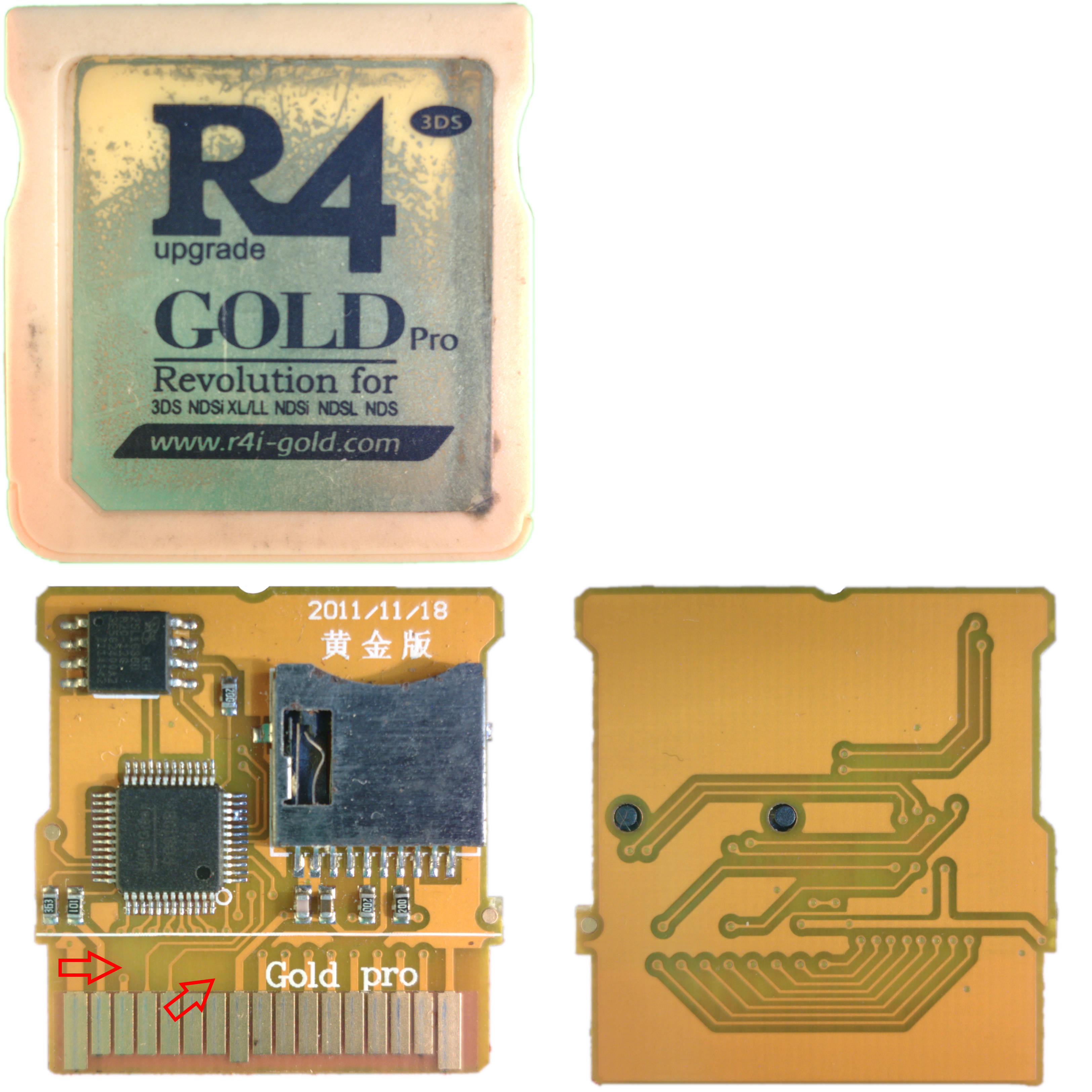

Traces to contacts confuse me.
For example this one seems to be exactly the same cart, but still a little different (see image).

does this help? as for what you described, I'm pretty sure I've already done it. I completely reformatted the SD card and put all my stuff back.
Yes, that helps.
Delete those files, they're not useful.
Do not use them as there should be a DS_MENU.dat file (the kernel itself)

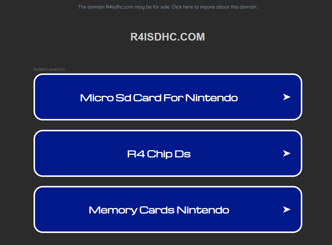

I've been looking around and it seems the site that used to host your Kernel is no longer available: http://www.r4isdhc.com/KerneDownload/R4i-V3.9b English.zip
Yeah, last resort: Download YS MENU and copy paste the files in the root of your SD card. Try again and report back: https://www.gamebrew.org/wiki/YSMenu
