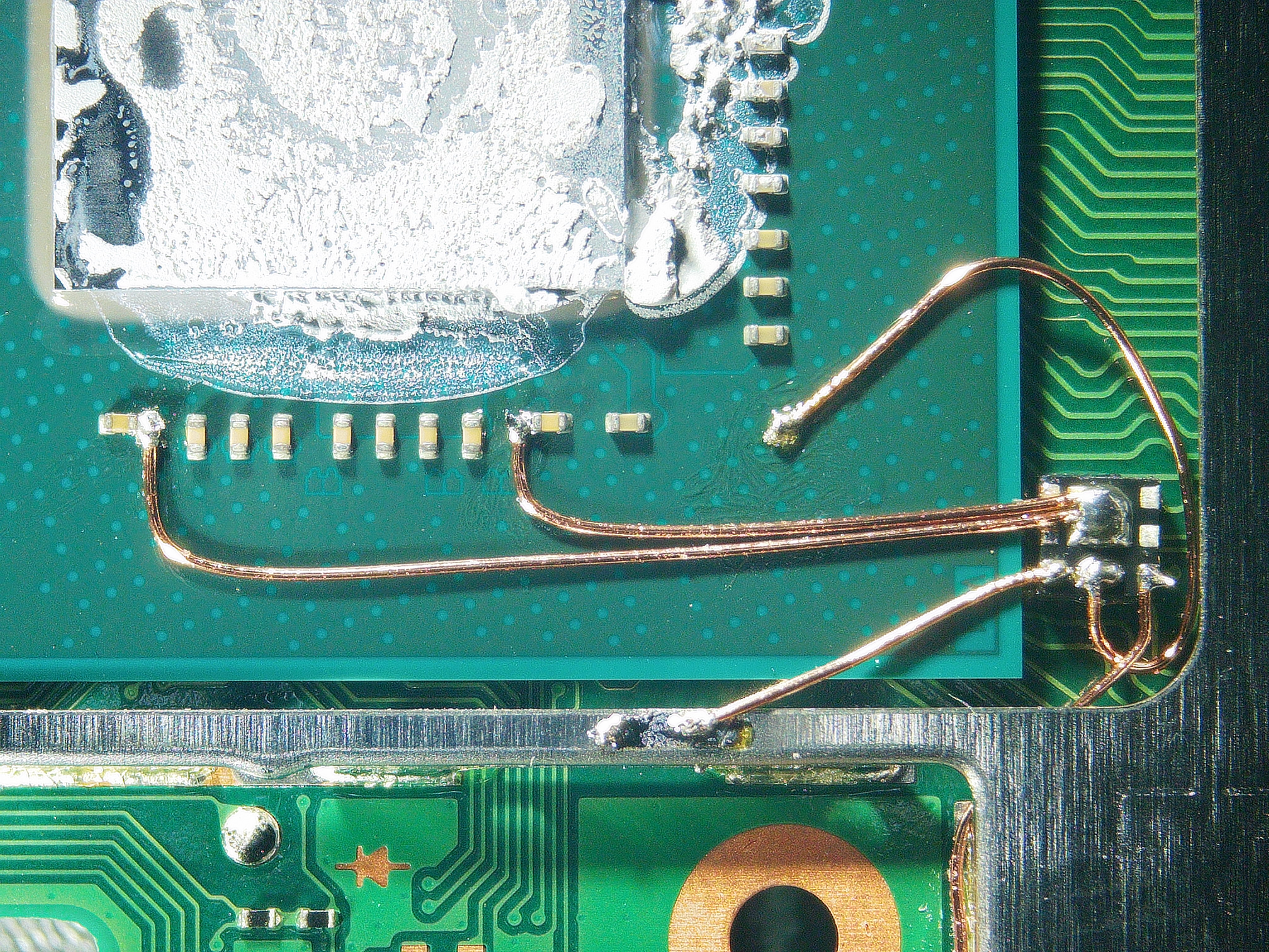

There are, but it means you'll have to remove the motherboard. on v1/v2/lite you can normally leave the motherboard attached while installing the modchip. Also, soldering on the cpu isn't that bad. If you have years of experience microsoldering it shouldn't be an issue. Here's how i usually do mine. The mosfet is glued to the pcb, and I add a piece of kapton tape on top afterwards to avoid shorts against the cpu cover.
are you using a different mosfet than the suggested IRFHS8342? if not, what is your experience with single-mosfet builds?
I see it's suggested to use 2 of them, i spent some time to pre-build a couple of dual mosfet balls of goop with just wires coming out, so that on-field i don't have to go crazy. Just wanted to ask if one mosfet works just as well
I use the regular IRFHS8342. I've tested all kinds of combinations of single mosfet, dual mosfet, apu-mount, back mount, different wire thickness, etc. The method you see in the photo above is the one I find works best (glitches the fastest). The wires are 0.2mm. I've observed that dual cap and ground wires as in the picture sometimes works where single cap/ground wire does not - this is most likely why some people report better success with dual mosfets - I think it's about the extra wires, not the extra mosfet.
