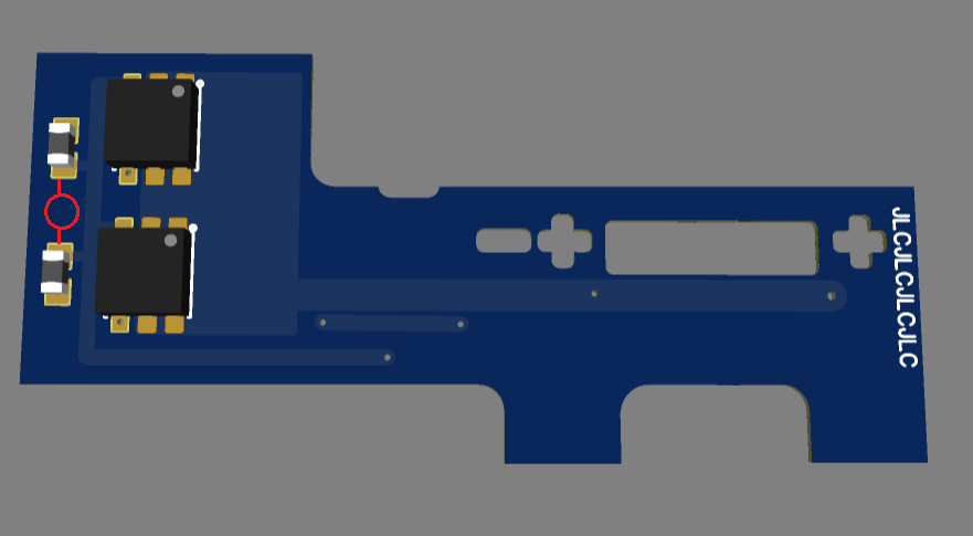

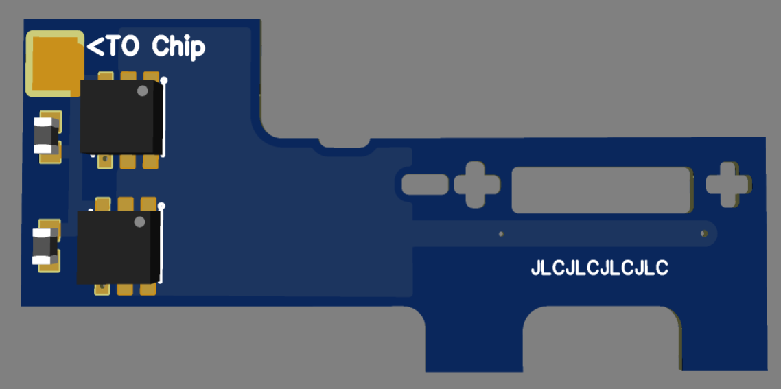

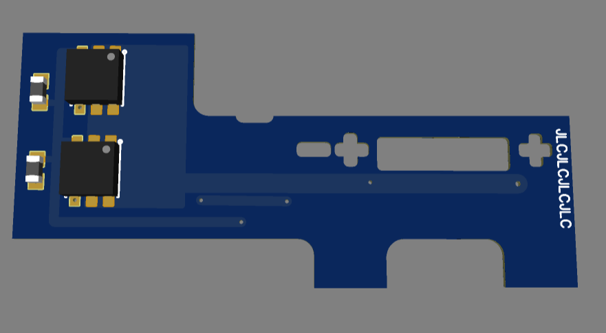

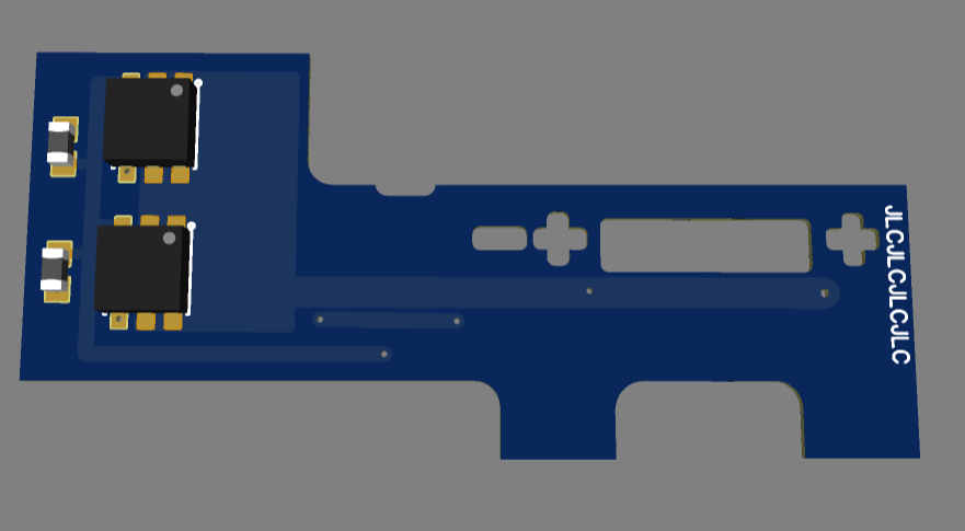

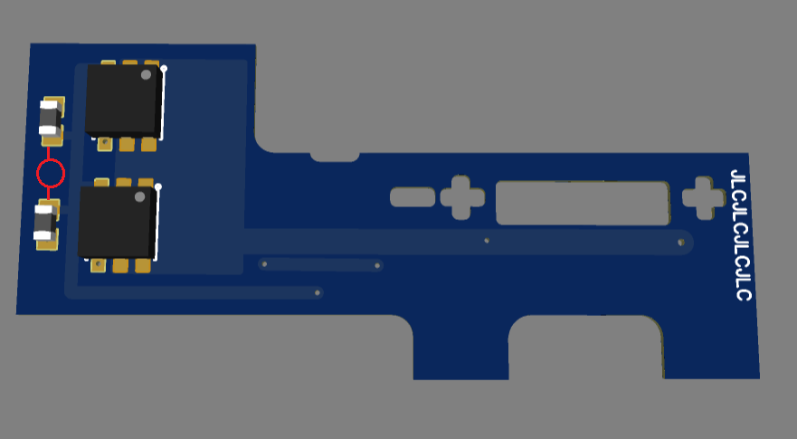

working on making a universal mosfet cable. have some coming in to check the fit. if it fits fine than it will end up on my github. if not, ill fix the fit and then release it. the pad for the wire is in the spot it is so you can just run the wire straight up and under the shielding
where is gate line should solder to? The front side rectangle ?
I would prefer solder point on back side in between 2 resistor so that the wiring wont seat on top of Nvidia base but outside of the edge
Hmmm thats an interesting idea

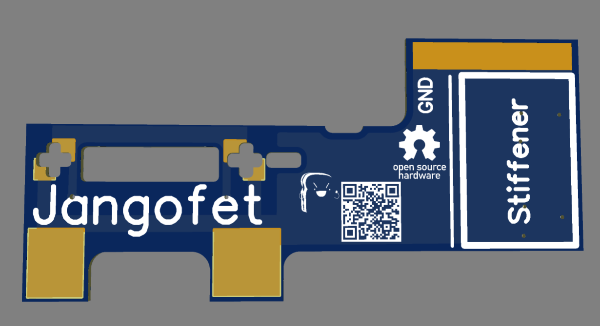

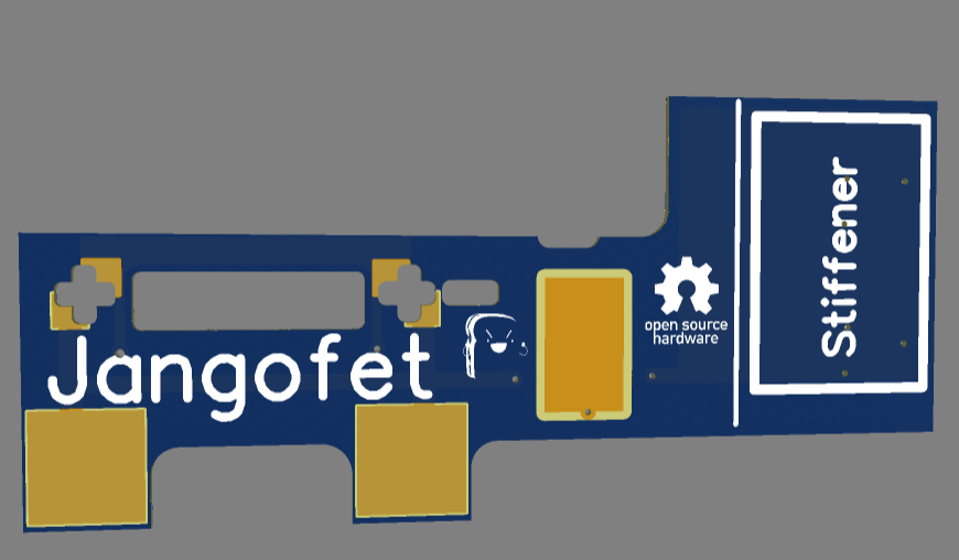

How about this?
I'm thinking of removing the ground pads near the caps
Reactions: Phantomas77

How about this?
looks good. top side Extra gnd seems unnecessary though.
The two square ground pads under cap could help stopping flex moving Around, I would say keep them.

How about this?
Its an interesting take to make a universal flex but thinking more about it seems unnecessary because all consoles except v1 is different which already comes in an unpatched variant. Also depending on the size of those slots you got those wrong for V1. The addition of the stiffener is also completely unnecessary that would drive the price up.
