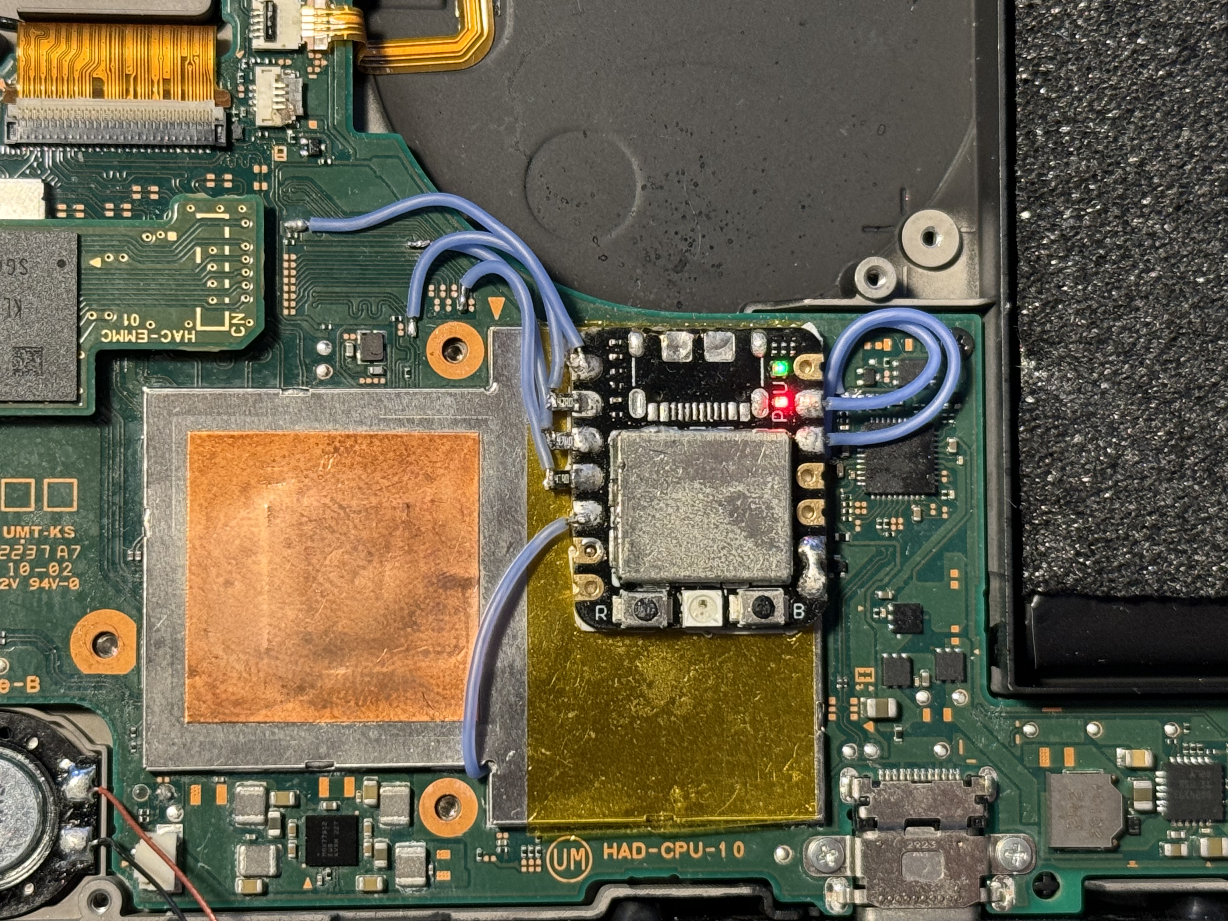

I have a weird problem. The whole Picofly setup worked for 2-3 months. Then, after a restart, the switch booted to OFW. I opened the switch again and saw that the RP2040 LED is not blinking at all anymore. Today I re-soldered everything but that didn’t help, same problem.
Do you think that the RP2040 is dead? Or any other Ideas?
Thanks 🙏🏼
Btw: the switch is working and boots to OFW

what firmware on the chip? try higher resistance on dat0

I only see cold solder joints, 3.3v cap looks damaged by flux, the wires are huge, use awg 36 or enamel 0.15 mm, use leaded solder, i recommend to desolder 3.3 v wire clean the flux and use the alternate point under emmc 3.3 v , if still not working replace with rp 2040 0 or similar.
i'm on v2.73. I have also removed data wires one by one (left side) to see any LED code, but nothing happens.
Cleaned all solder joints, removed any flux left overs.
Checked all wires for continuity - all of them are good.
Additionally checked emmc ports to wire for continuity - good.
Checked for shortages - nothing found.
Yes, 3.3v is a little bit damaged, but still works (you can see that the Power LED is on)
Huge wires? Thats actually 30 awg :)
I'm sure that the soldering is good enough, my suspect is the PR2040. Is there any method to check the functionality of it? Unfortunately I have already removed the USB Port, would have tried to re-flash.
