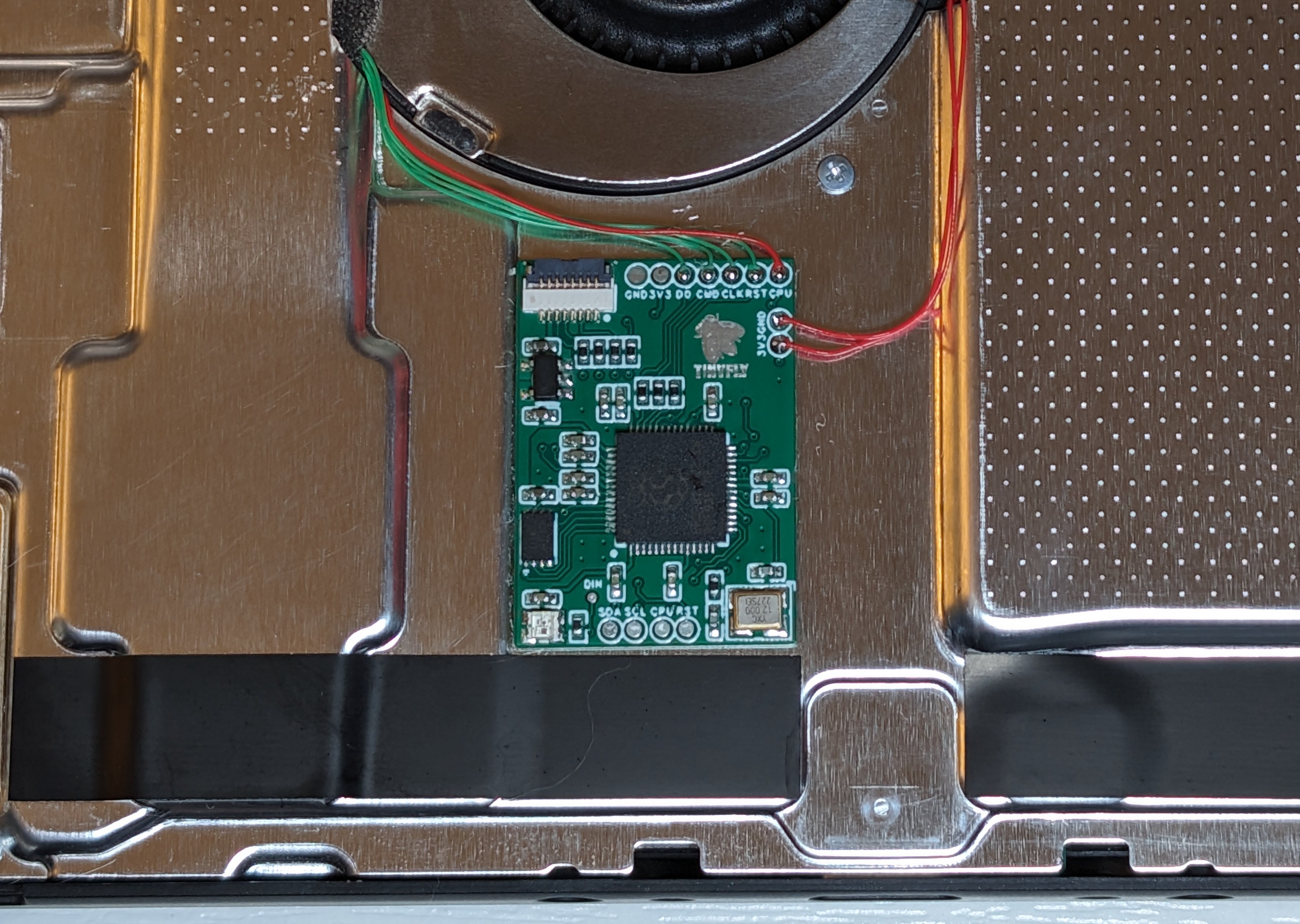

Should be fine. This is how I do my v1/v2 installs as well. Kapton tape may be unnecessarily blocking airflow since the v1/v2 shell is plastic. Make sure your double sided tape is strong enough. I use Grimco Banner Tape and it is stupid strong. I can barely rip the chip off if I try.
Clean and beautiful work. I also like your pcb.
