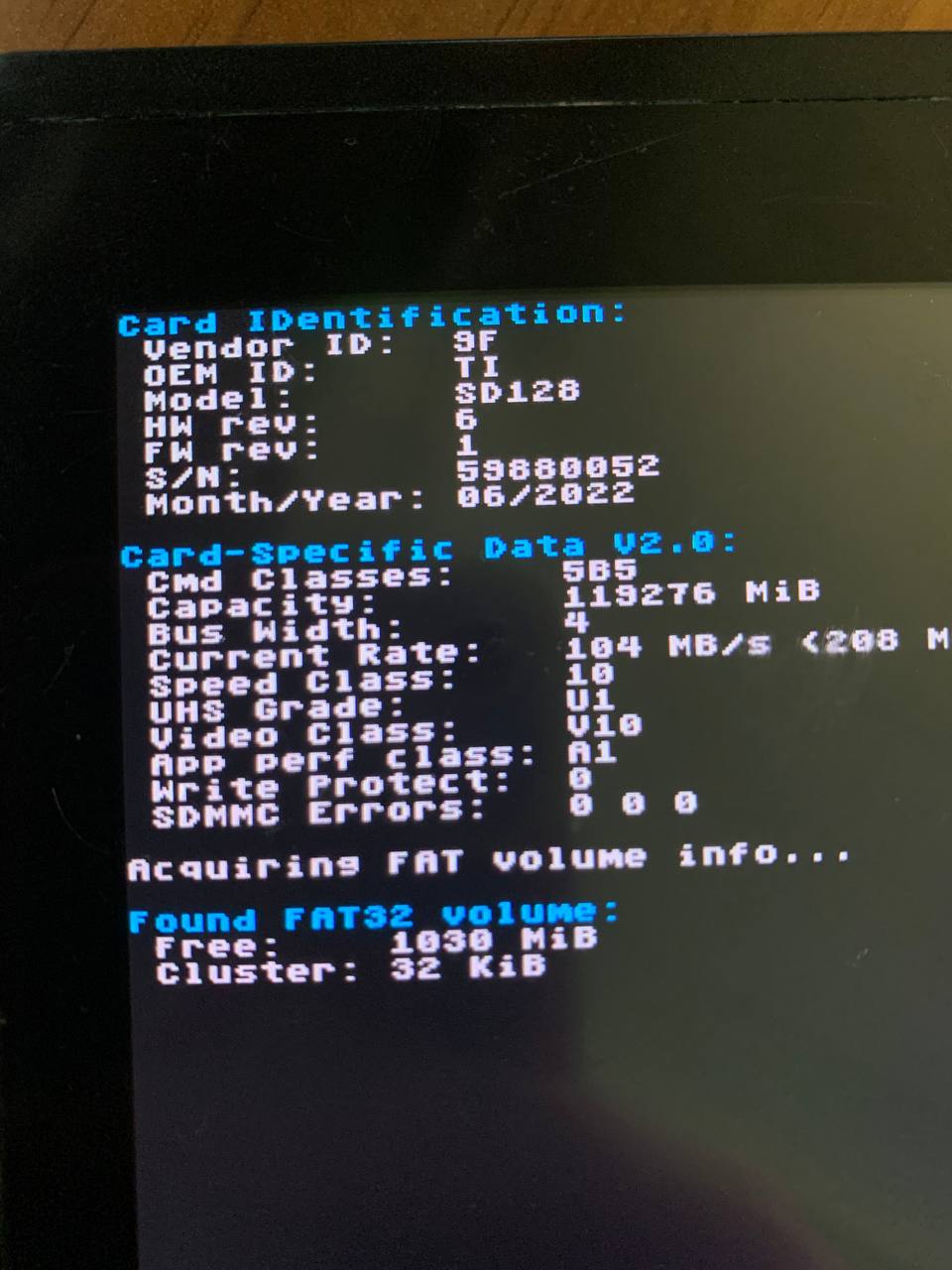

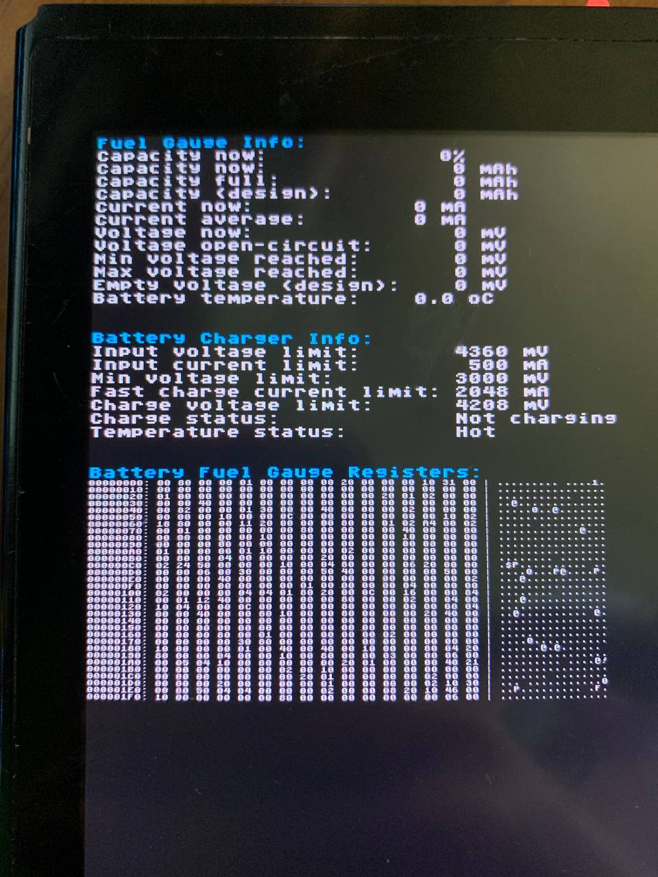

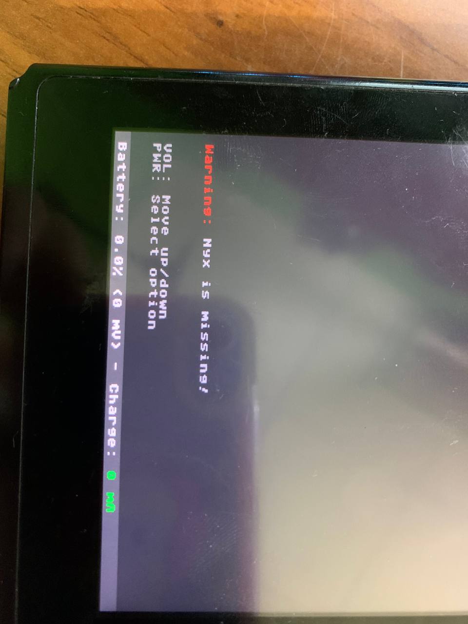

Hello, yesterday I changed the battery and left it charging but now I find that neither CFW nor OFW starts, I directly turn it on and it doesn't start. I have RCM disabled and I can load payloads from Tegra, if I leave the SD connected it won't let me inject any payload but if I remove it, it does start. I have tried formatting the SD and loading the latest version of Atmosphere. Another thing is that if I start Hekate without the SD but insert it after loading Hekate does detect me and I can see the payloads that I have inside it. Once inside Hekate it appears Battery: 0.0% (0 mV) - Charge: 0 mA. I have the console in update 17. I have tried another SD that I have but it doesn't work either.

The problem is that I can't enter either OFW or CFW. Only enter Hekate without SD while booting, only after Hekate loads
