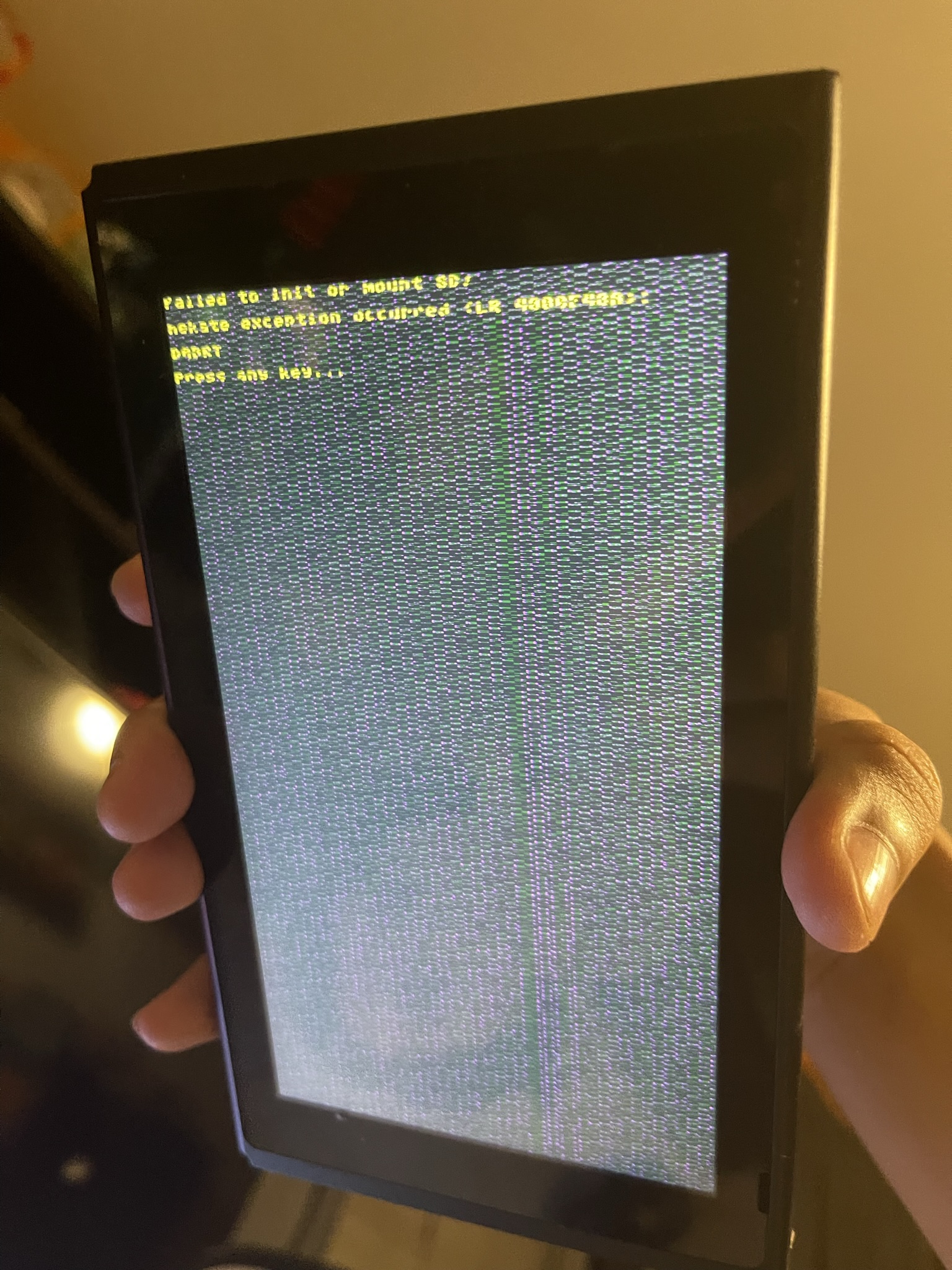

Anyways, my switch was brand new, didnt even have it setup. (which may have been the mistake) anyways my picofly booted up normally (even ofw worked but i still havent set it up) so i went it to make an emunand and once the process started, my switch was gltiched and i saw a semi green screen but also the emmunand process at the same time (idk how to explain) anyways the chip still works, hakate now doesnt and my ofw is showing up a blue screen. Fml

Ok, try reformatting your SD card, reload it with a HATS pack of some sort (google "sthetix HATS"), and see if you can get back into Hekate. Be sure your SD card board that plugs into the switch is well-connected. It's possible it may have had a poor connection while you were trying to backup things.

got this beauty

got this beauty
Is it just the camera, or is the screen somewhat jumbled as well? I suggest going and cleaning all points of flux and if you removed any flex connectors while soldering, make sure they are properly reseated and clipped in place fully.

are the troubleshoot lights supposed to stay on? or only appear for a a second. Because before hwat used to happen to me when it was working is that it would go blue, then cyan then blue then cyan and then red (green but mine came defective). After cleaning and fixing some points now it just goes blue then cyan then nothing and then boots to ofw (blue screen)
