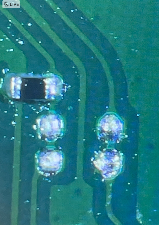

can i bridge this? its the clk for v2 (the right one, i wanna bridge the top and bottom to get an easier and more stable solder)
Yes, these points are bridged. How do I know? Because I ripped one of my CLK pads loose, and the console stopped booting, and I had to repair it with magnet wire and uv-cure resin.
lol same but with my dat 0.... kill me that was so hard, especially with my shaky hands.
Reactions: impeeza
Lmao, yeahhh, I started by ripping my DAT0, then ripped CLK in the process of repairing that. All told at this point, I had to repair three separate traces in my switch, and I blame it on using 30awg Kynar for the points instead of just using it for power and the leads from the mosfet to the caps. Coulda ran all my other points with my 40awg magnet wire and not have ripped any of the pads. -_-
