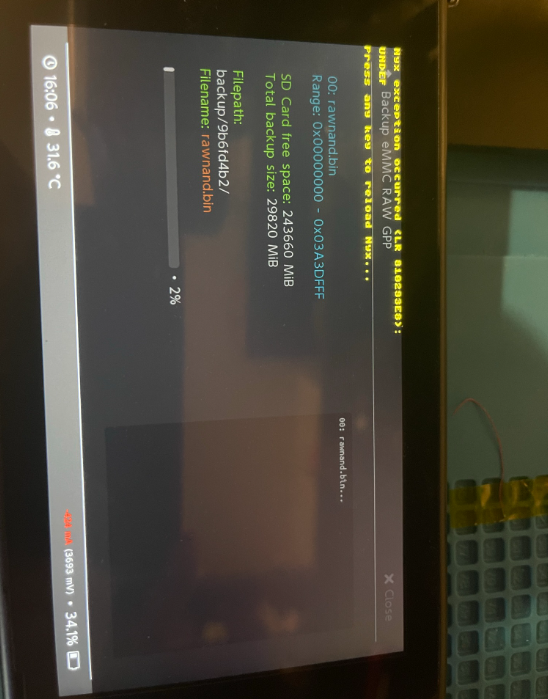

sigh.... i keep getting these messages even after resoldering almost everything as pretty as it can be :(
(cant for the life of me, make a dump, i was able to do an emunand though. But also every time i try to do a FAT32 nand backup, it gives me this. SD & eMMC data (@LBA somethin somethin). any help? thanks!
try double resistors (94 Ohm) for CMD & DAT0
Is strange, now I get this error when I try to launch HOS from hekate
same thing. you get some interference on eMMC lines, it can't completely work on the full speed. clean flux, use shorter wires, put double resistors on CMD & D0
Try these points on the pcb. You will have shorter wires and better signal.
Read on first post (guide of point).
On Picofly FW 2.6 all ok.
Try another microsd card.

those are the points im using lol, but wire size makes a difference? i never knew that. ill make them all way shorter. and ill try the rest. thank you!

Surely if you use a very thin wire it is better to reduce the length, otherwise you could use thicker wire.
Personally I've never had emmc reading problems.
Obviously we could give you better advice by seeing in detail the welds made and knowing the gauge of the wires used.
The advice I can give you at the moment are:
1) shorten the cables.
2) clean the excess flux well.
3) Double-check each weld under a microscope (or loupe) and touch up if you notice anything like cold welds.
4) replace the resistors, perhaps too much heat from the soldering iron could alter their values
5) personally I prepare the chip by first installing the resistors (after having isolated the points of the boot button) and then I fix the resistors with the UV mask in order to block them and use the soldering iron at max 275 degrees for a short time, placing the tip and lifting it as soon as.
See photos.
That said, if you send in detailed photos it might come up with something that pulls the bunny out of the hat/cylinder.
