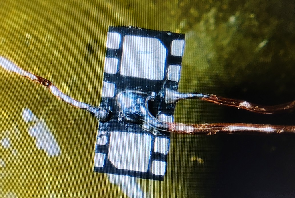

This is practice.
The mosfet used is IRFHS8342.
I managed to solder it somehow.
Is this OK?
Using flex cable for the first switch was the right choice.
