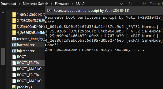

All good (as of v20210719 and 12.1.0 OFW):
Recreate boot partitions script by Yoti (v20210719)
Wait...
1_66fc6e8b60142f07d33da61ff37cc9d6 [Normal]
2_753020bff878f29b66fcf840b96430b3 [SafeMode]
Done!!!
All good (as of v20210418 and 12.1.0 OFW):
Recreate boot partitions script by Yoti (v20210418)
Wait...
1_66fc6e8b60142f07d33da61ff37cc9d6 [FAT32 Normal]
2_753020bff878f29b66fcf840b96430b3 [FAT32 SafeMode]
3_25bb90ed24664b791d0e2cc1b707ea30 [exFAT Normal]
4_2e386f2d8ab6bbac6d1057d0b52746eb [exFAT SafeMode]
Done!!!

is this real?
Yes for sure. Look at my screenshot.

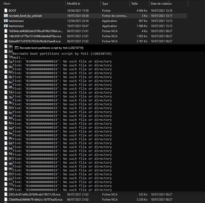

@deejay87 open Windows command prompt, type "find /?" (without quotes), press Enter and show me result. I think you have some development software (like devkitPro Updater) that breaks Windows command line utilites. You must edit Windows environment variable named "Path" and put "devkitPro/msys2" lower than "C:\Windows" and "C:\Windows\system32".
