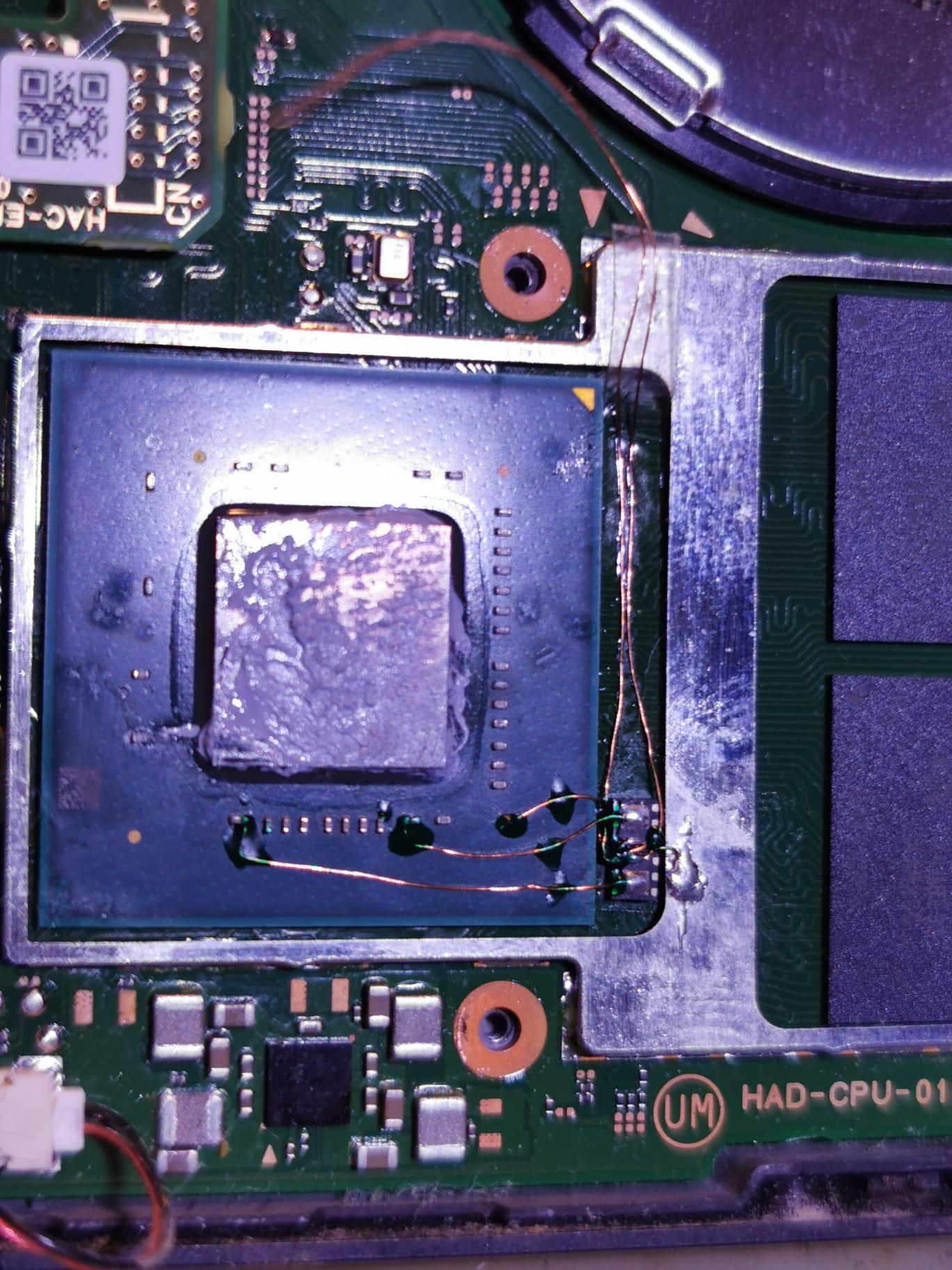

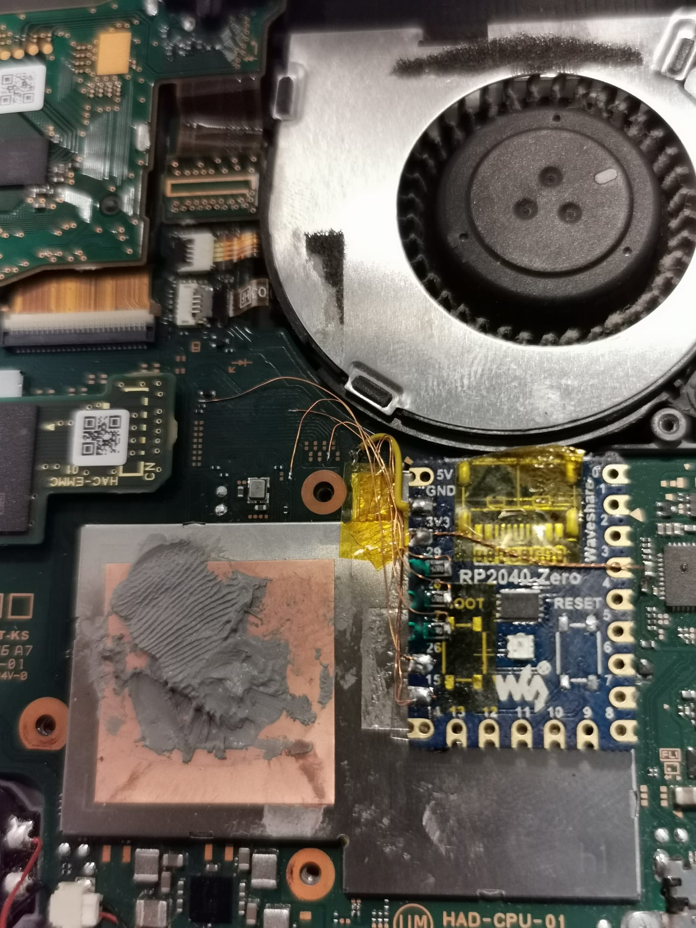

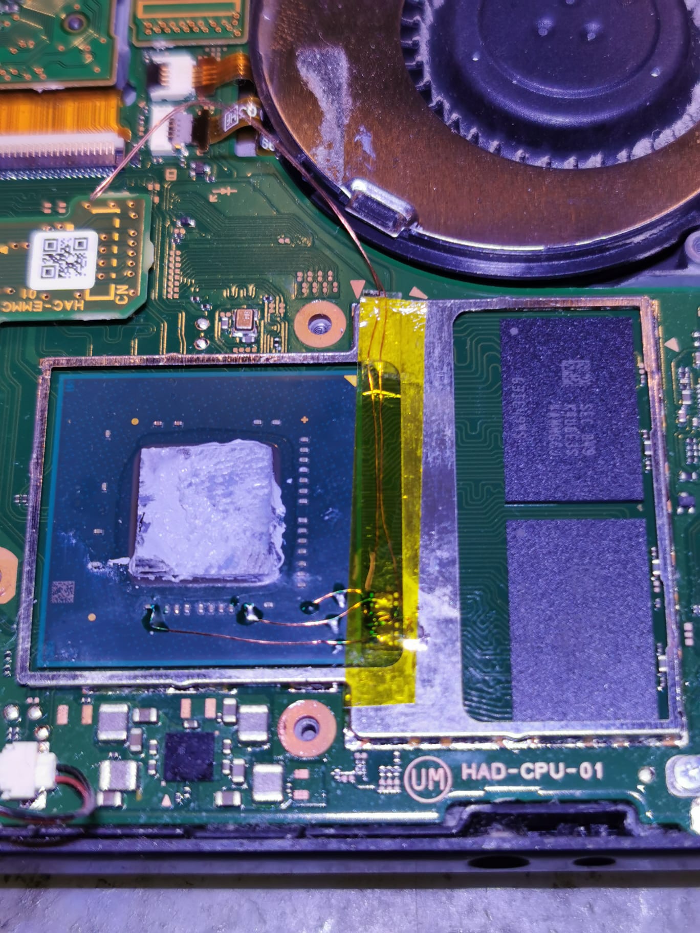

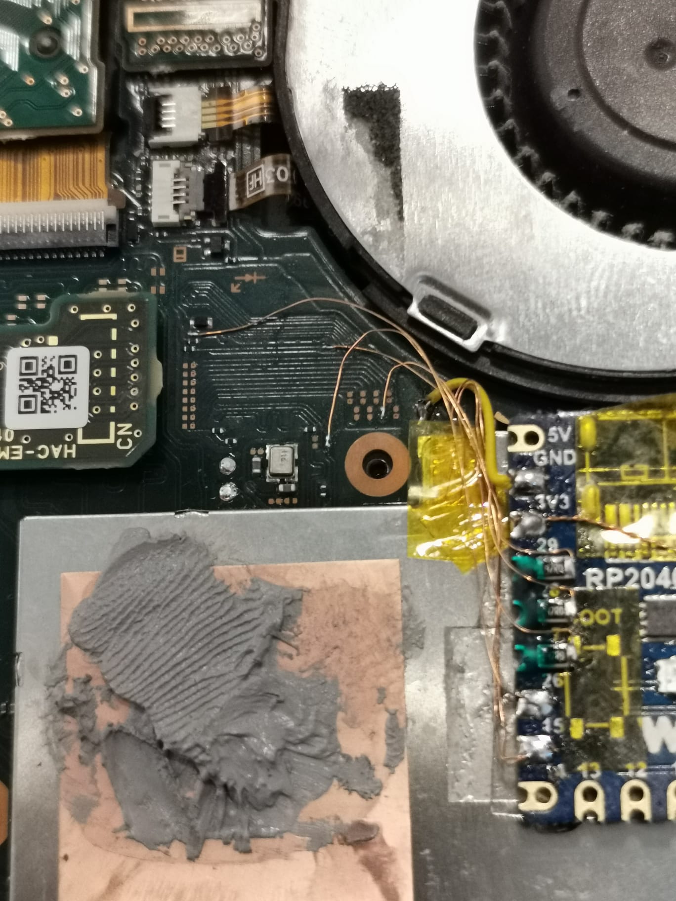

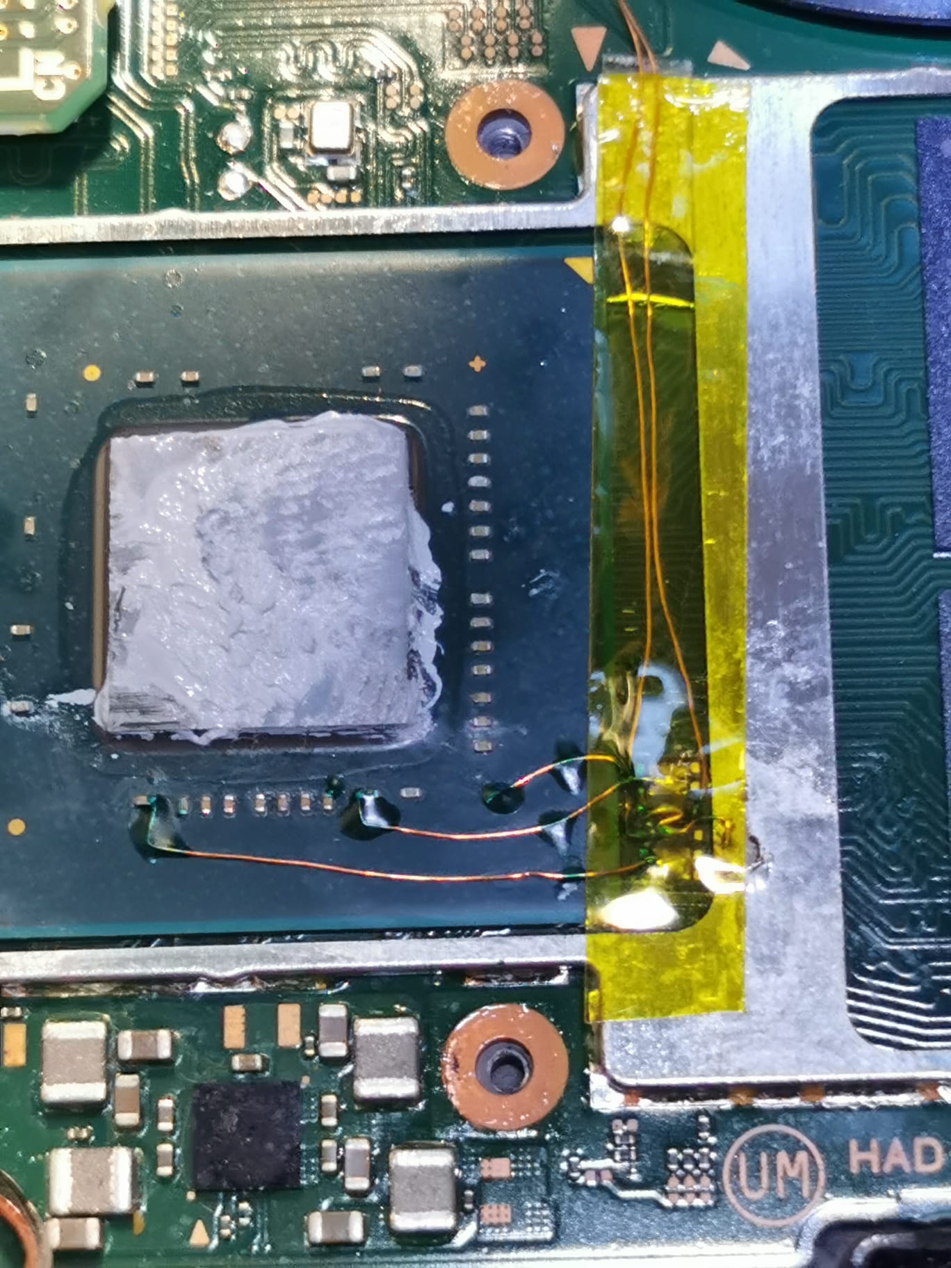

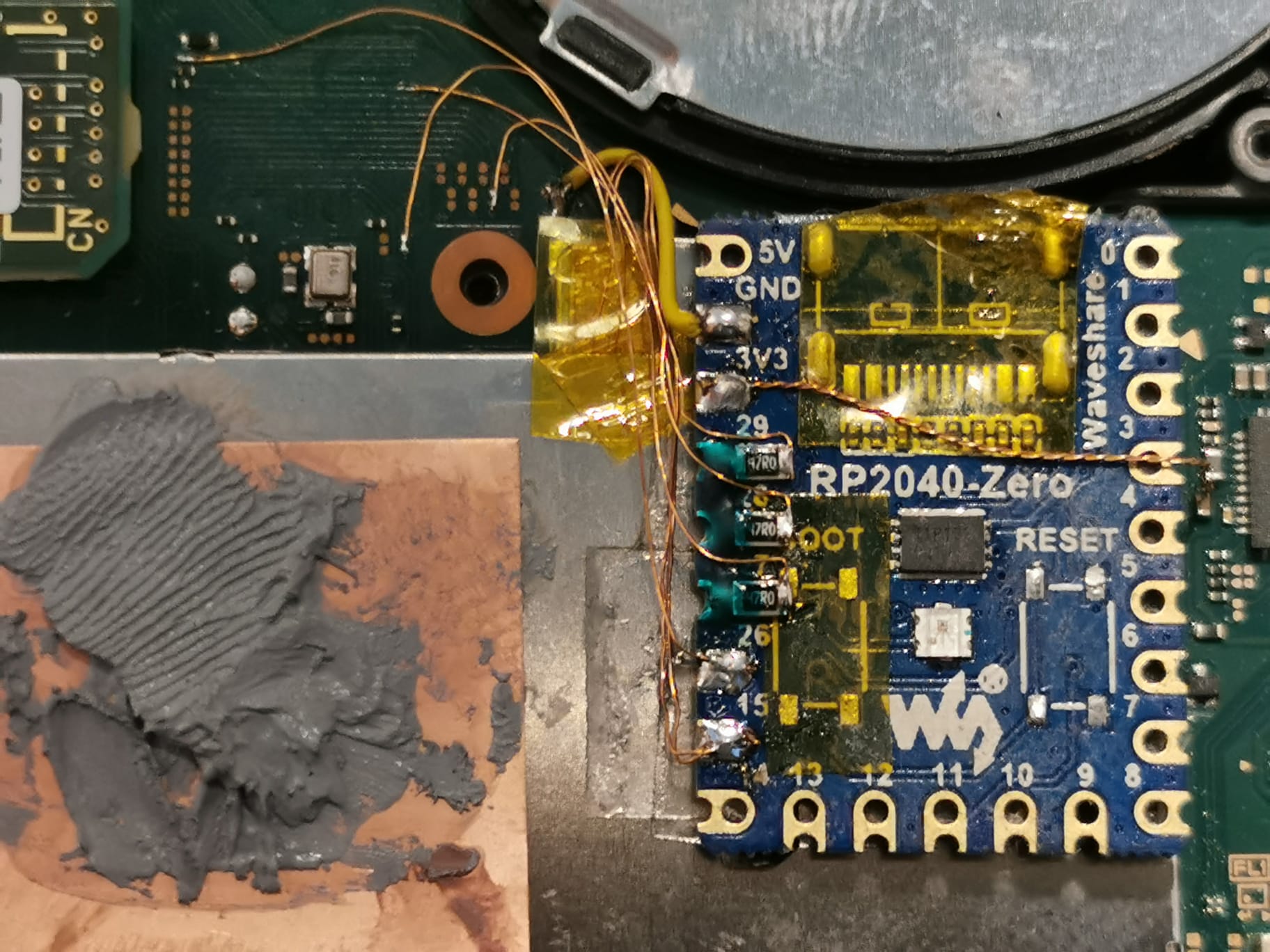

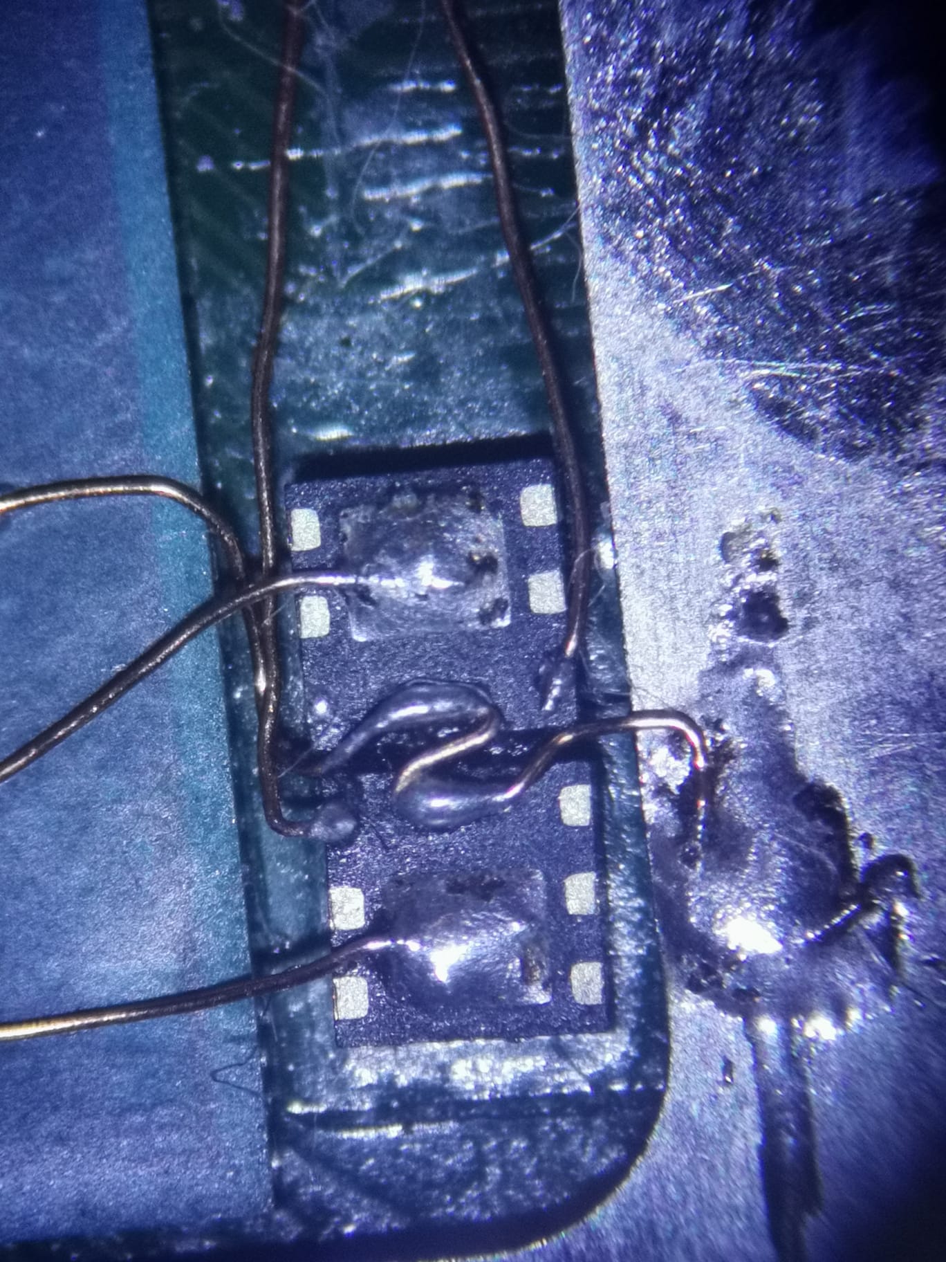

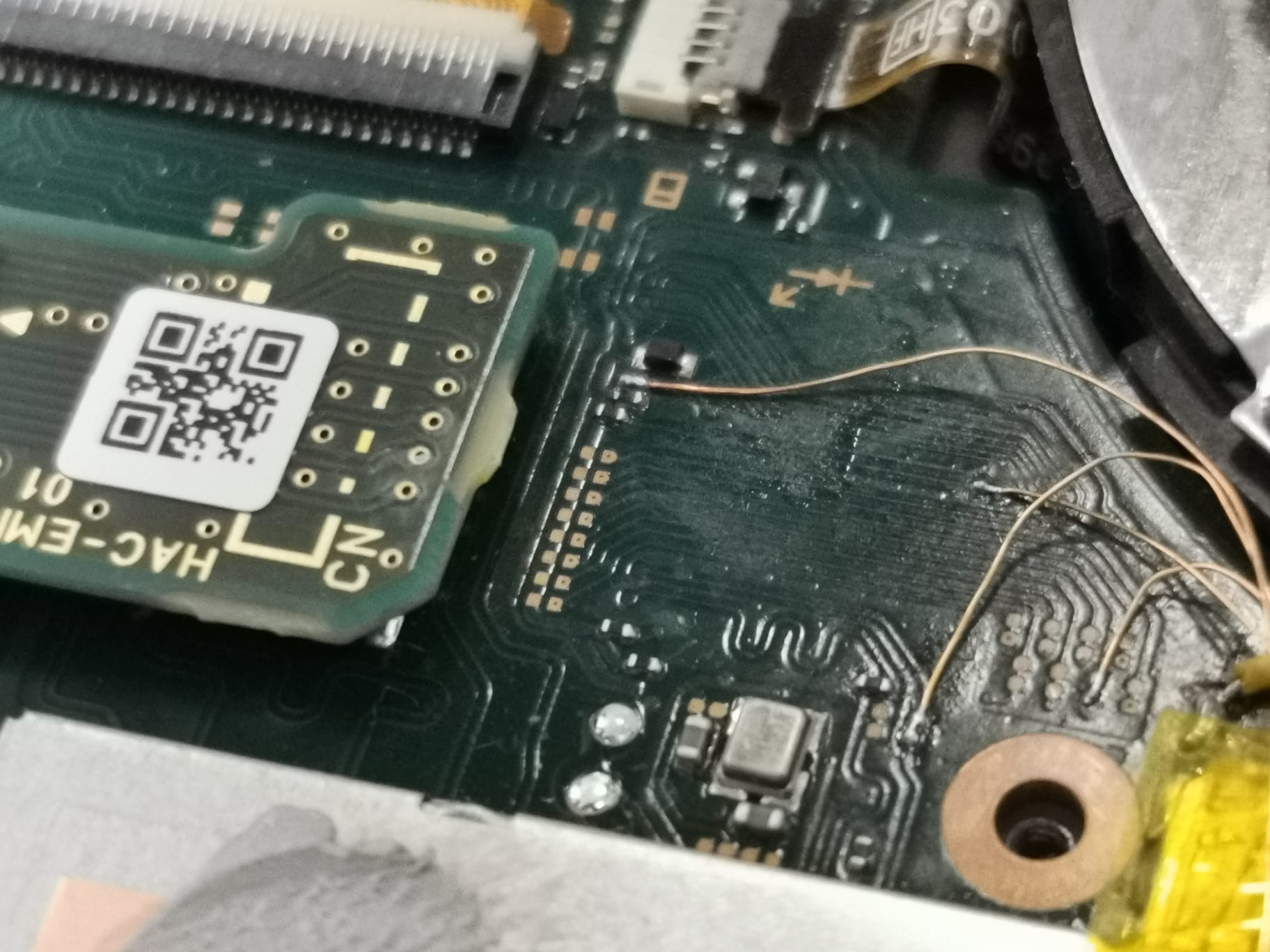

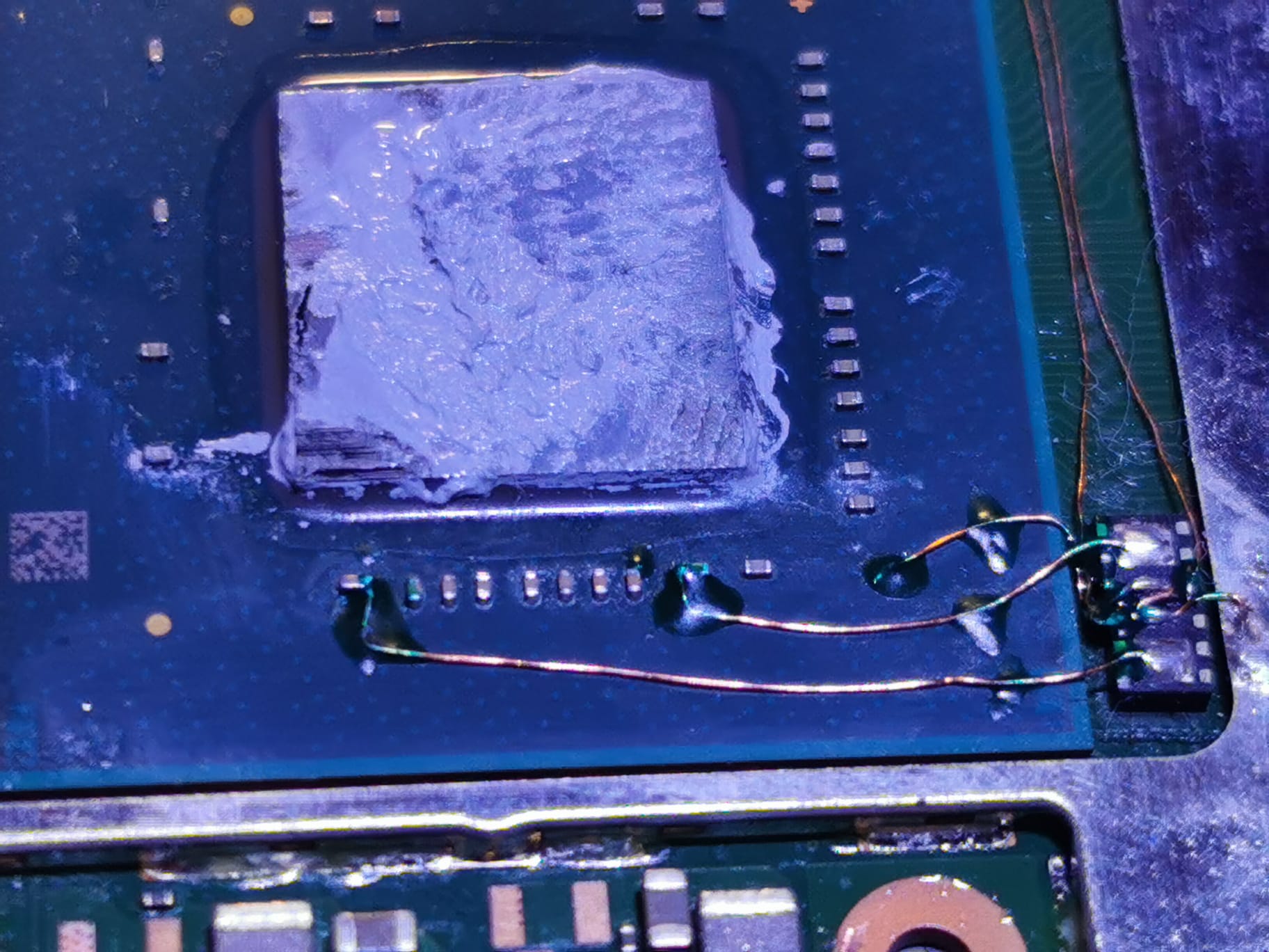

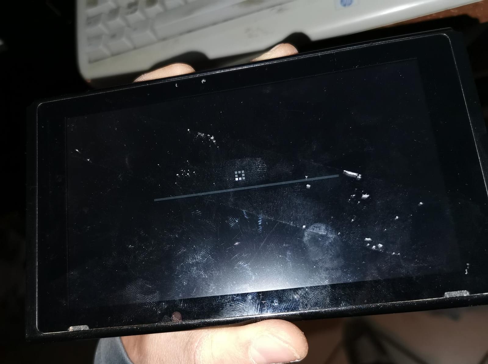

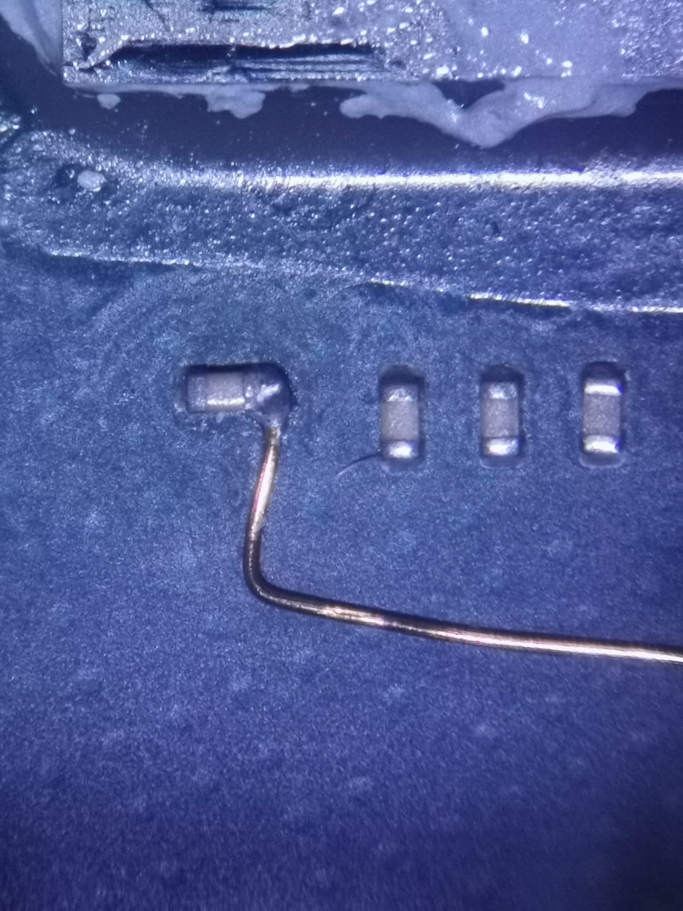

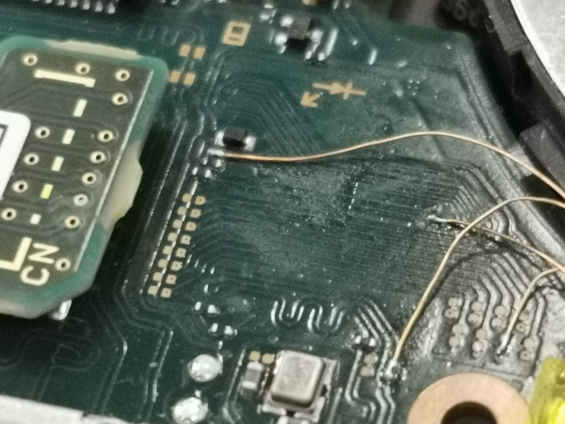

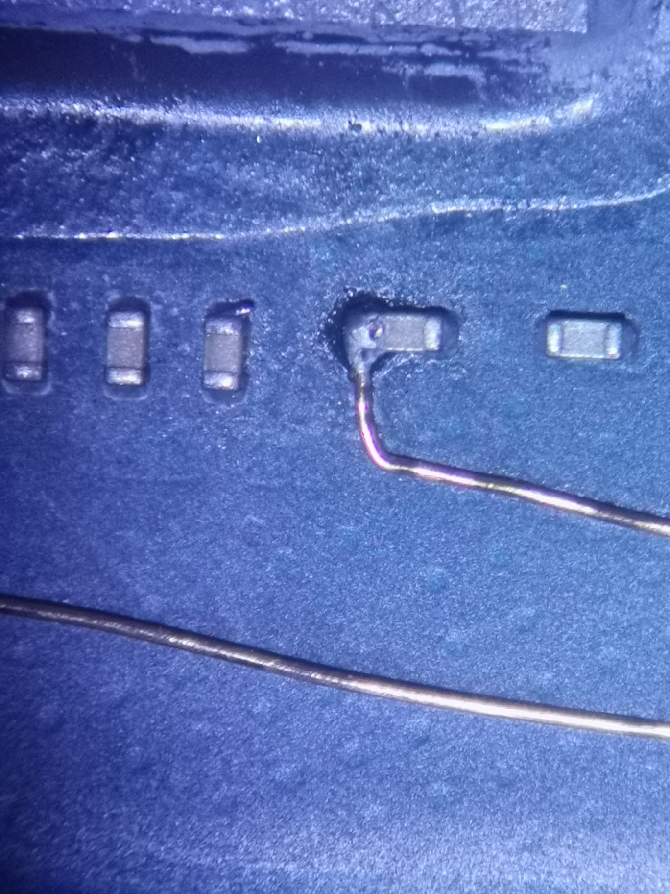

Another console, another question.
But this thing happened to me just now.
I just installed another picofly with fw 2.61 (I hadn't seen the most recent ones) and I can't start it in OFW.
I state that I only installed the chip and turned on the console.
I turn on the console without MICROSD and the picofly NO SD CARD logo appears.
Then it froze on a black (but backlit) screen.
I unplugged the battery and plugged it back in and so I prepared the microSD.
If by hekate I reboot into OFW a loading screen appears which then freezes and the console reboots.
What will I have done wrong? (I did the same procedutre of the other 2 consoles).
Advice? Did I damage something?
I attach photos.
